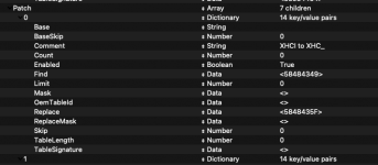

The rename patch is a simple thing to edit, as I have one I use in OpenCore for a similar rename (on an Intel Hack), as shown below:
XHCI to XHC_ rename patch used with my Skylake Intel Hack.
The patch above could easily be edited to rename XHC0 to XHC2 with the relevant find and replace entries.

So the find and replace entries would be more akin to these.

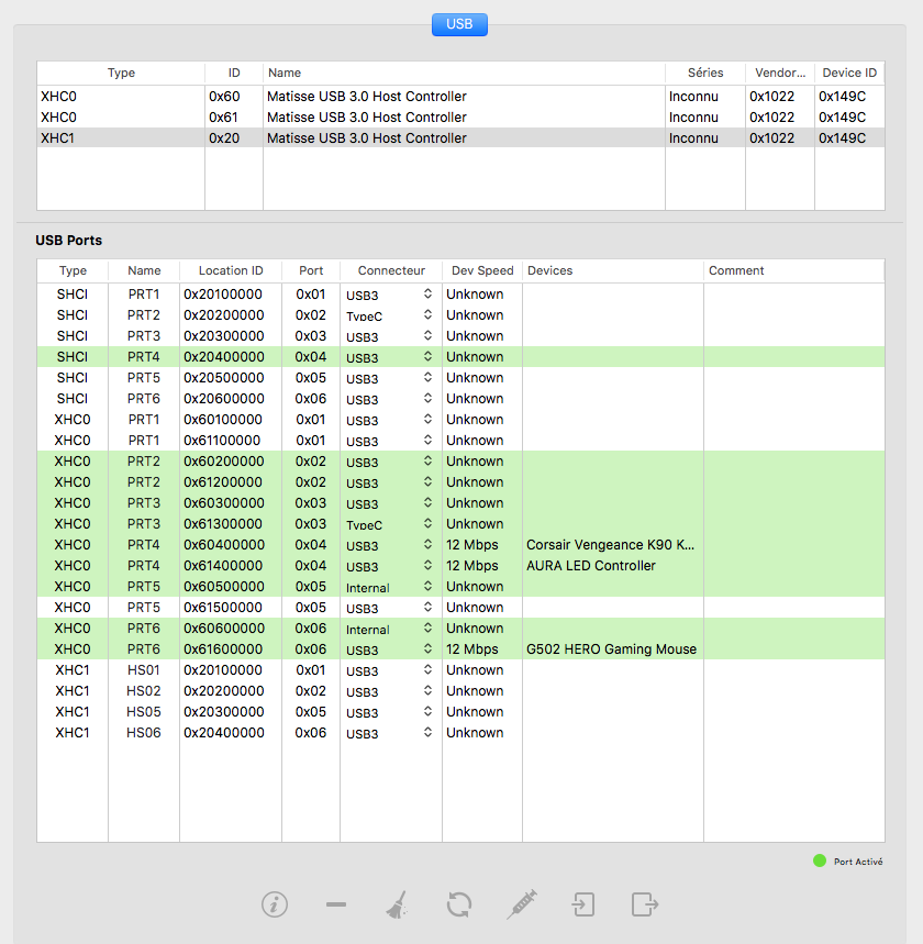

The two XHC0 controllers provide the following in your DSDT.aml
Scope (_SB.PCI0.GP13.XHC0) contains 8 ports. This is the USB controller that requires the rename patch.
Device (XHC0) contains 10 ports. This USB controller should be left as it is.
So based on this I believe the Find and Replace rename patch, for the GP13.XHC0 USB controller should look like this, following a simple Text to Hex conversion.:

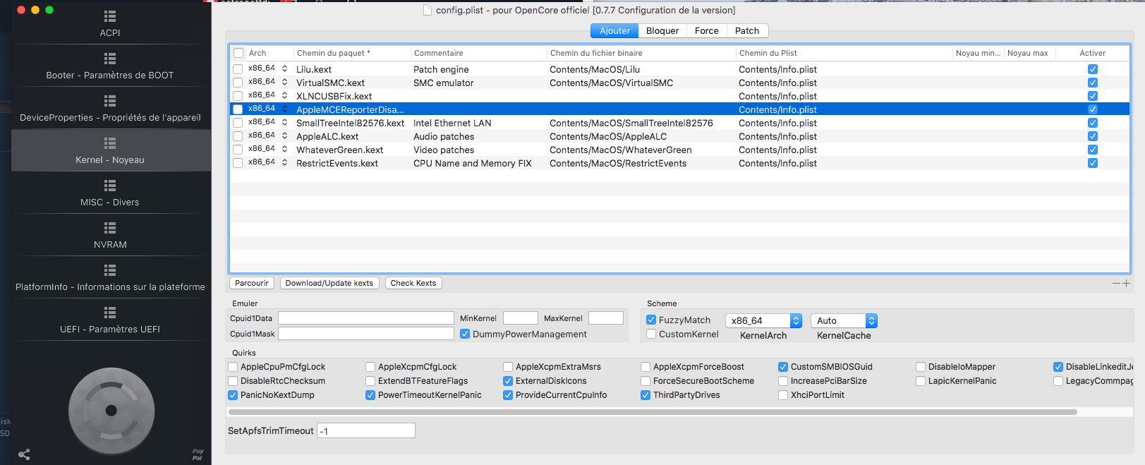

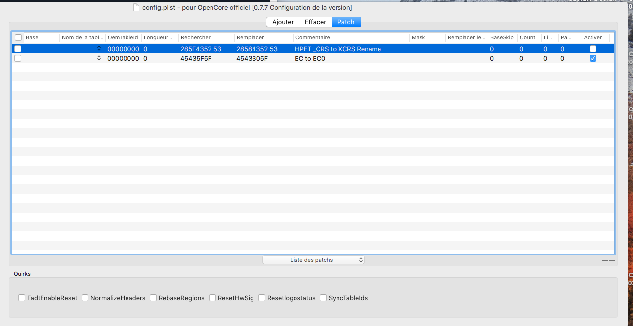

after loading your patch it seems like nothing has changed do i skipped something ?
i've included the patch into the config.plist and deleted the UTBMap.kext from the config and folder
then rebooted
this is really strange, if i look on your post it seems perfectly logic and should've worked, at least at renaming the controller,
do you think include the rest "_SB.PCI0" will change anything ?

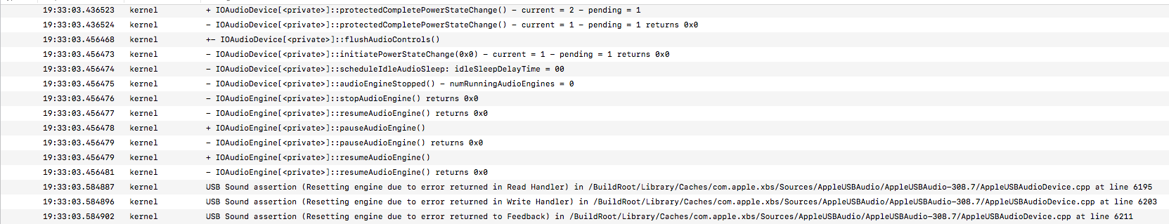

and when i try to connect my UR22mkii i get this error
par défaut 20:00:28.605169 +0100 icdd #ICDebug - 504:{ICDDMessageCenter.m} (-Rem IOUSBHostDevice - 0x0/0x0/0x0 - 0x61600000 - ICDeviceDescriptionUndefined)
par défaut 20:00:28.846058 +0100 kernel 000083.007029 XHC0@61000000: AppleUSBXHCI::getCompanionPortGated: unsupported protocol USB 03.10
par défaut 20:00:29.084207 +0100 icdd #ICDebug - 23:{ICWiredBrowser.m} (USB Device first match)
par défaut 20:00:29.084742 +0100 icdd #ICDebug - 388:{ICWiredBrowser.m} (4 USB Descriptions Managed)
par défaut 20:00:29.085051 +0100 icdd #ICDebug - 457:{ICDDMessageCenter.m} (+Add IOUSBHostDevice - 0x0/0x0/0x0 - 0x61600000 - ICDeviceDescriptionSUQuery)
par défaut 20:00:29.085053 +0100 icdd #ICDebug - 205:{ICResourceManager.m} (00000000-0000-0000-0000-000004242422|IOUSBHostDevice|(null)|SW=FALSE|)
par défaut 20:00:29.085380 +0100 icdd #ICDebug - 457:{ICDDMessageCenter.m} (+Add IOUSBHostDevice - 0x0/0x0/0x0 - 0x61600000 - ICDeviceDescriptionAdded)
par défaut 20:00:29.366740 +0100 kernel 000083.527716 XHC0@61000000: AppleUSBXHCI::assignDeviceAddressGated: device at address 3 is not a hub
par défaut 20:00:30.422538 +0100 kernel 000084.583514 XHC0@61000000: AppleUSBXHCI::assignDeviceAddressGated: device at address 3 is not a hub
par défaut 20:00:31.491209 +0100 kernel 000085.652184 XHC0@61000000: AppleUSBXHCI::assignDeviceAddressGated: device at address 3 is not a hub
par défaut 20:00:32.570931 +0100 kernel 000086.731905 XHC0@61000000: AppleUSBXHCI::assignDeviceAddressGated: device at address 3 is not a hub
par défaut 20:00:33.662173 +0100 kernel 000087.823148 XHC0@61000000: AppleUSBXHCI::assignDeviceAddressGated: device at address 3 is not a hub
erreur 20:00:33.980832 +0100 bluetoothd Apple80211GetIfListCopy returns error -3903
par défaut 20:00:34.762915 +0100 kernel 000088.923890 XHC0@61000000: AppleUSBXHCI::assignDeviceAddressGated: device at address 3 is not a hub
par défaut 20:00:35.871972 +0100 kernel 000090.032948 XHC0@61000000: AppleUSBXHCI::assignDeviceAddressGated: device at address 3 is not a hub
par défaut 20:00:36.991971 +0100 kernel 000091.152946 XHC0@61000000: AppleUSBXHCI::assignDeviceAddressGated: device at address 3 is not a hub
par défaut 20:00:36.992095 +0100 kernel 000091.153073 AppleUSB20HubPort@61610000: AppleUSBHostPort::disconnect: persistent enumeration failures

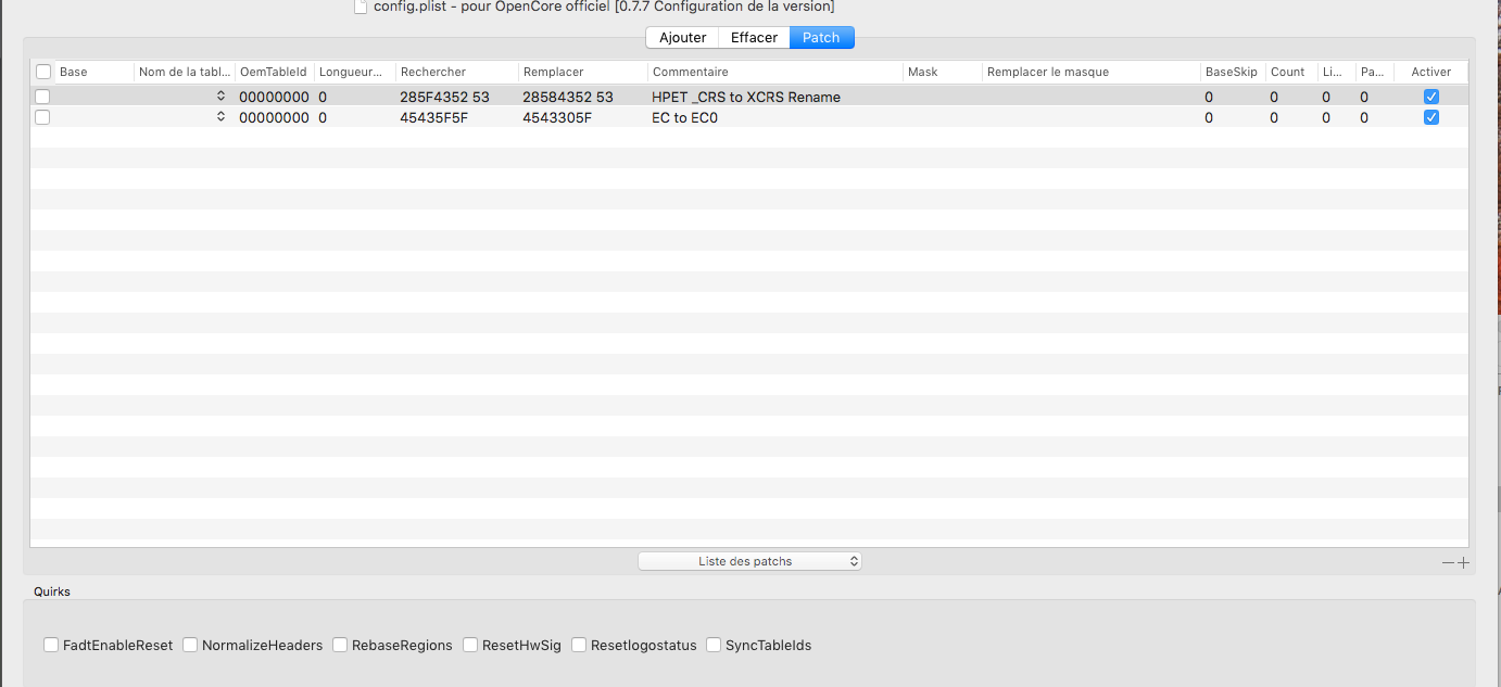

Unfortunately while it looked logical I made a mistake with the ACPI address of the two XHC0 controllers. I realised this after using your DSDT.aml with Corpnewt's SSDTTime python script. I used SSDTTime to generate a pair of custom SSDT's for your system:
SSDT-EC.aml
SSDT-USB-Reset.aml
Plus an ACPI rename patch for EC0 to EC , which your system requires.
These are attached in the results folder below, along with an individual SSDT-USBX.aml.
I would recommend do the following:
Remove the current SSDT-EC-USBX.aml from your system /OC/ACPI folder and config.plist.
Add the three SSDT's and the ACPI Patch rename patch attached to your setup on the USB pen drive.
Remove the XHC0 rename patch we added previously from the config.plist on the USB pen drive.

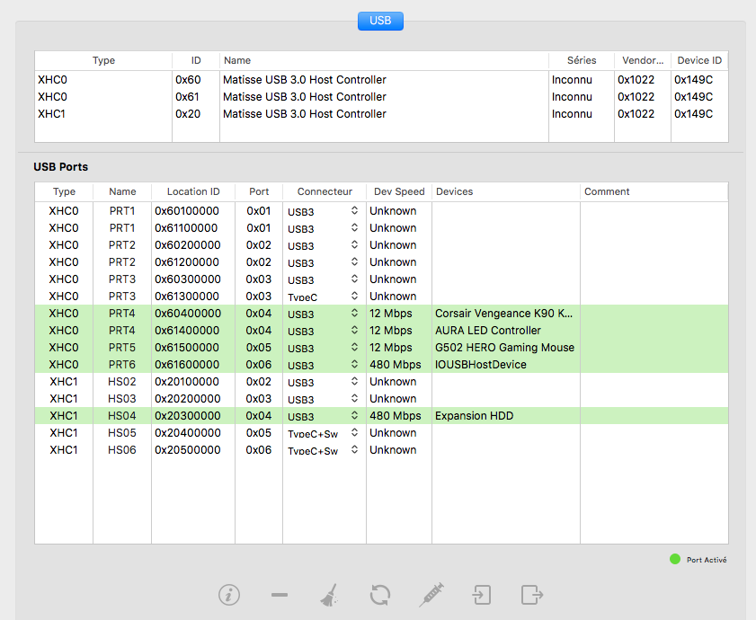

When you reboot in to macOS do the following:

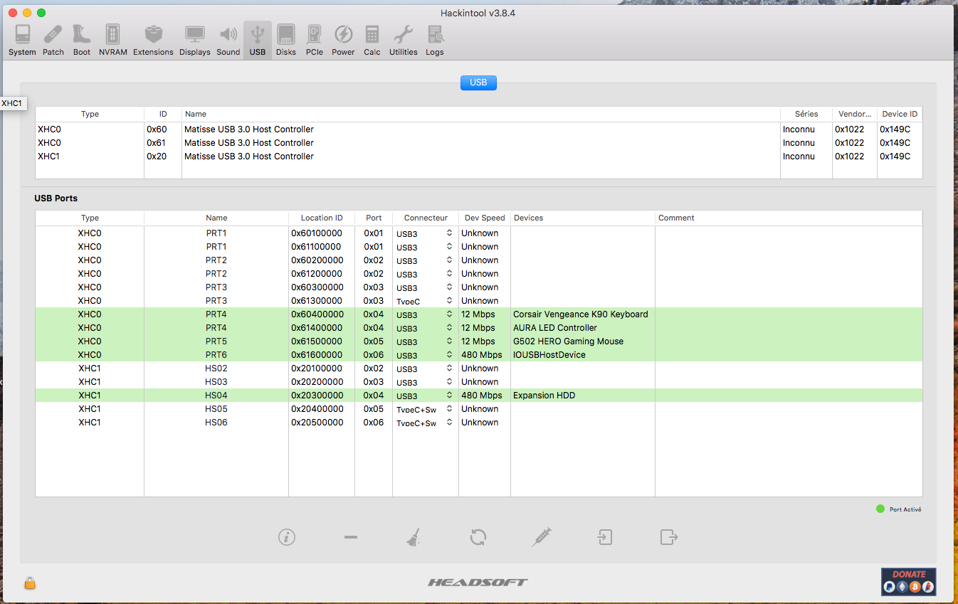

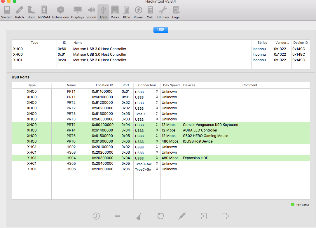

Clear all the USB ports shown on the USB window in Hackintool, using the Sweeping brush icon (third from the left).
Refresh the USB window using the refresh con (fourth from the left) looks like circular arrows.
See what difference this makes to the ports and controllers that are displayed.
Post a screenshot with all the ports displayed after the refresh and addition of the custom SSDT's etc.
