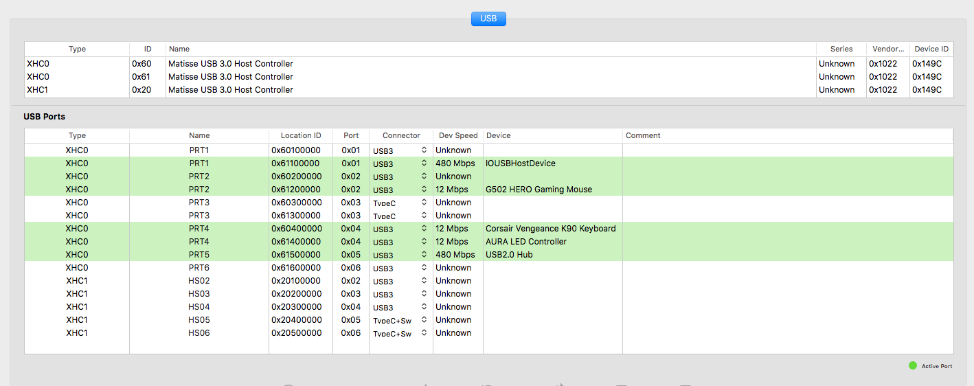

the build is for audio production purpose so i have a usb audio interface (ur22 mk2), the soundcard is compatible with the built in macos usb audio driver AND also has his own driver besides (yamaha steinberg usb driver) witch enables more customizations like buffer size and such. but it has to work even without the custom driver (tested on many macs i had over the years)
The problem is : when i plug the soundcard into any usb port it will not show on macos as an audio device (plugged before boot or plugged afterwards dosent change anything), if i install the driver, same thing In hackintool's usb section the port used by the soundcard shows as active and the "device" section shows "IOUSBHostDevice" with a speed of 480m/s
i've tried using a powered hub in case of usb power issues but no luck here
Hope someone can help me with this, at least getting on a path to dig on
Many thanks
i include a screenshot of the usb section and my whole EFI folder if it can be useful

Do you have any devices connected to either or both of the Internal USB2 headers on the motherboard? Usually these are used for connecting Bluetooth modules, case front USB2 ports, USB2 card readers etc. As none of the 4 possible USB2 ports are included in your USB configuration shown in the Hackintool screenshot.
2 x USB2 headers highlighted on motherboard image below:
Screenshot 2022-02-07 at 13.17.33.png ROG Strix X570-F Gaming motherboard
Here is a list of the USB ports available on your system:
Screenshot 2022-02-07 at 13.17.09.png Bottom entry corresponds with the Internal USB2 headers.
What also begs a question is why the Controllers and ports have duplicate Names. This is not normal to my mind.
I could understand this better if the two XHC0 controllers were named XHC0 & XHC2 respectively. But as they are both named XHC0 it just doesn't seem correct. As you have an XHC1 controller in your setup using that name is not advisable, so XHC2 is probably a better name.
Having two controllers named the same is probably causing some issues when you configure your USB setup. If there were some way to differentiate the two XHC0 controllers and use an ACPI rename patch to change one of the two controllers, that might make it simpler.
Creating and adding an ACPI rename patch for renaming any USB controller to something different is easy to put together. But without being able to differentiate the two XHC0 controllers it would rename both controllers to the new name.

do the internal usb3 (who goes to the usb 3 case header) has to be in "internal" too ?
i can differentiate the both controllers by their ID but their name is the same
How do i make a custom rename patch ? do you have some good ressources on how to do so ?
