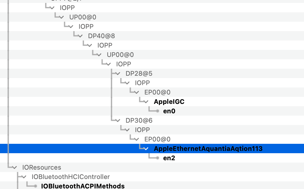

I'm interested in the X870e Proart.. does everything work correctly? Are there any problems with sound and ethernet?
Thank you very much
Thank you very much
Both ethernets work with a kext and caseysj patches
Audio works with AppleAlc kext
Reactions: Pabo
