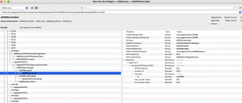

I know what the Belknap framebuffer does, my point is that you only need @0,name, not @1,name... etc.
Can you send a SysReport zip and OC log from the latest BIOS and with your BIOS settings? I'm pretty sure that the MMIO values changed from the first time we did it.
Are you sure that you need AGPMInjector? Big Navi should have it working OOBE.

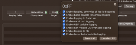

Do you have Debug Target set to 0x67?
I have tried with 0x67... but the log shows the same as in the release version...
In the end I changed to:
And it has generated...
But it's weird because on the previous x670e-f board the LOG did come out with 0x67 🙆‍♂️
I will try again with 0x67

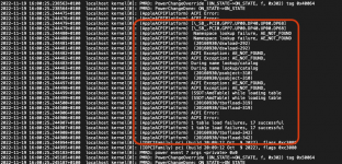

@PoMpIs The last log was fine. Give this a try.
Tested..
It seems to start a little slower... but it works fine..
Now this appears in the LOG:
I get an ¿error? on DP68... when removing the patch you did for the x670e-f

Tested..
Are you sure it actually boots slower? It should boot faster... I'll look at the patch when I get back home, I wasn't sure if it's still needed on this mobo.
