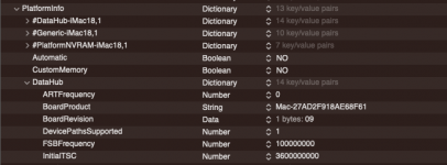

The attached SysReport (CPU) includes FSB Frequency, which is 102272740 for my Ryzen 7 7700X, Trying this now.
@CaseySJ if that makes no difference please try 100000000
Reactions: CaseySJ
The previous value made no difference. Will try this now. The only change I'm making is shown in the red box. If other changes are needed, I can include them.
UPDATE: Alas 100000000 seems a little worse than 102272740. With HDMI/DP audio, the latter produces longer passages without static. But in both cases, USB DACs and Line-Out are unchanged (i.e. still awful). ;)
