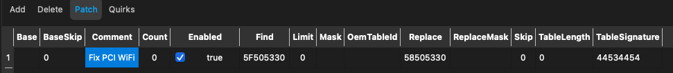

On another forum there was an Ace Magician user who had incredible problems and finally gave up and sent it back. However he mentioned a patch seems to fix Wifi, I added it to this version of your EFI. See what happens.

You sure know how to make someone's morning, I've been trying different iterations of the Airportitlwm.kext and Ventura - Windows hijacked my Sonoma... I sure haven't missed having it on a drive! Anyway, I've gotten as far as being able to turn wifi on at the titlebar but it was still locked in sys prefs. It actually first removed the exclamation when booting with the Sonoma14.5 kext, riddle me that one!
I mentioned the other card I ordered, put it in my tower today and wifi immediately came online. That gave me just enough motivation to get nowhere with hours of verbose boot screen time on this ryzen mini pc.
I'll try the patched file this afternoon, thank you very much.
