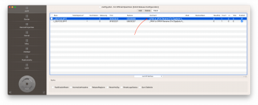

@CaseySJ my ACPI looks like this..... UPX DIsable was Disabled
