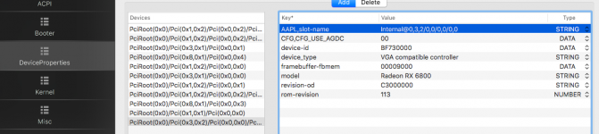

Okay @eduard0, it looks like you're missing a fair amount of necessary SSDTs in your build, namely:
SSDT-CPUR.aml
SSDT-EC.aml
How does your USB ports fair? If they're not working fully you may also need SSDT-XHC0-TO-XHC or PTXH-TO-XHC2-NO-PO9-10-11 renames.
I also noticed you never installed SMCAMDProcessor.kext after AMDRyzenCPUPowerManagement.kext.
And you added the wrong agdpmod setting and haven't populated the device tree for the AMD GPU. It should be set to agdpmod=pikera for RX6800, NOT agdpmod=ignore as it is right now.
You also need these device properties for your RX6800XT.
SSDT-CPUR.aml
SSDT-EC.aml
That’s one of John’s EFIs from this thread with my Generic data filled out and the appropriate core count.
