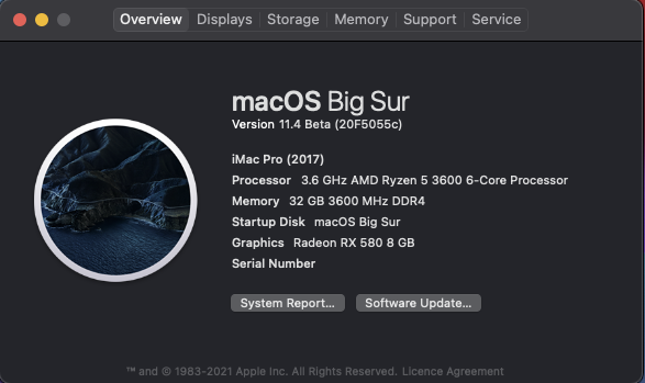

Can't seem to get it to work with my 3600 though.
Try going into your config.plist and changing your processor type to 1537 Save and restart.
That should get it to kick in
Reactions: Shaneee
Well, at least its not showing unknown anymore...
@Shaneee if he is then would that mean 1537 relates to the 5600X only? (No it can’t be thinking about it, must be an older version of the kext)
I don't think so. OpenCore sets two CPU types for AMD by default, Xeon W for 8 cores or more and the i5 for less. Without seeing the Lilu debug to see what the kext is trying to replace can't say for sure it would be the same CPU type to replace.

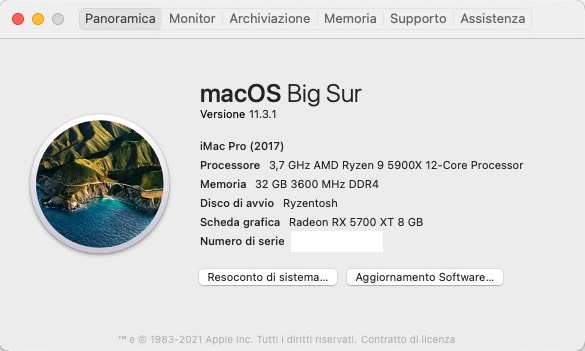

WHOOHOO!
I forgot to update kext even after I downloaded it 🥴
It works here too with last 1.0.2 build

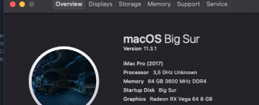

I’ve got the latest 1.0.2 and I see unknown on my ryzen 5 3500. What do I need to put in cpu type? 1537?
It's within the PlatformInfo > Generic section of your config.
Yeah I know where to put it I was just confirming what to put in there for my cpu to display properly. Thanks.
1537 is the correct value to change it too for a 6 core CPU 👍

hi everybody. it is only possible on Bigsur 11,4, beta ?
I don't see where i made a mistake
i am on an external SSD with bigsur 11.3.1
Where is that folder located? You only need the .kext inside your kext folder in your EFI directory and make sure it’s added to your config.plist.
