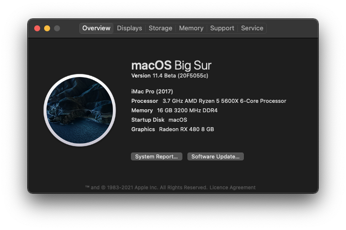

It's Now Fixed for me. 🥳
Any luck on yours @Shaneee ?

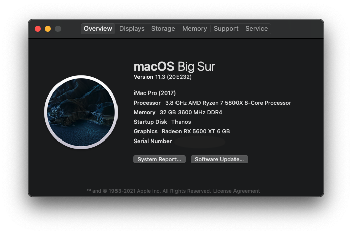

Try the latest version Bud.
Its now working for me.
Reactions: RyzeCooker
Whoo! It's working for me too! With your help with the boot issue I had a while ago - fixed by going back to HfsPlus.efi - you are fast becoming my EFI mechanic! ;) Thanks so much!
