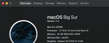

The latest builds of Acidanthera's RestrictEvents also fixes AMD CPU names in About This Mac:
Required is just the latest build of the upcoming 1.0.2: RELEASE:
This also removes the need to map memory on MacPro7,1 SMBIOS:
Note
If your CPU is shown as Unknown on OC 0.6.7 or later try setting ProcessorType to 1537 for 6 cores or less and 3841 for 8 cores or higher in the config.plist under PlatformInfo > Generic.

I have two slots and mapped all 12, never experienced a crash after sleep.
2,145
Even with this I'm stuck with Unknown lol

@Shaneee add a boot argument
  • revcpuname=value custom CPU brand string (max 48 characters, 20 or less recommended, taken from CPUID otherwise)
2,145
Not sure how it would work with spaces. Although in theory without this it should still show as an Intel CPU. ProcessorType isn't set in PlatformInfo so I'm not sure what's going on.
Edit: Even with revcpuname=AMD it doesn't change lol

@Aluveitie What boot argument did you add to get it going?
Ive tested the memory without my map and its perfect everywhere with no errors showing at all. might as well not use a custom map anymore if it works this well.
895
Nice, I’ll probably switch too.
The boot arg I’ve added is revcpu=1
2,145
That was the first thing I tried. Guess I need to fix the Unknown string first...
