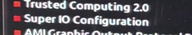

There were a few options that you might need to look at.
The first image on page 5 of 7.
SuperIO is common name for Serial Port, it should be disabled.

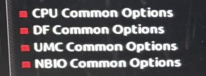

Page 7 of 7
NBIO sub-menu usually contains a few common bios entries that may need attention.
Otherwise the bios looks OK.
Hi @Edhawk
I've attached the NBIO sub-menu screenshots & also disabled SuperIO as per your suggestion. Further, I initially copied the entire EFI folder after extracting your zip file which is why my pendrive wouldn't boot, then l looked inside it again & found "__MACOSX" & "EFI" folders. I then copied that "EFI" folder & then it booted & now I'm getting this below error !
