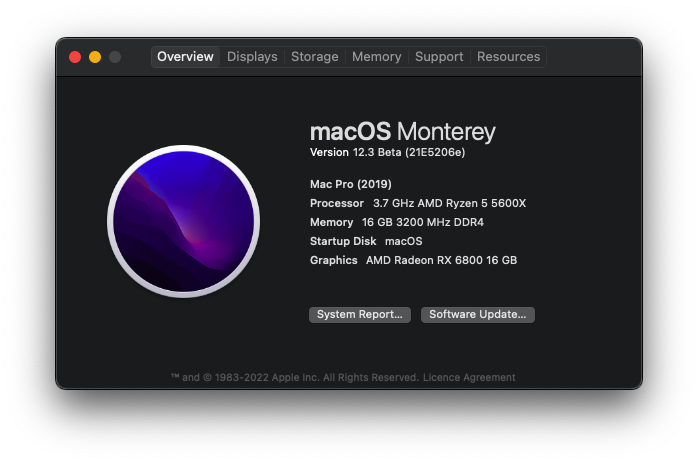

Has anyone tried the Monterey 12.3 Beta 2 update yet? I really don't want to guinea pig it and lose all my git keys again from a Time Machine restore.... Its kind of a pain to recycle them
2,145
@marinekev88 Yeah works without any changes from first 12.3 beta.

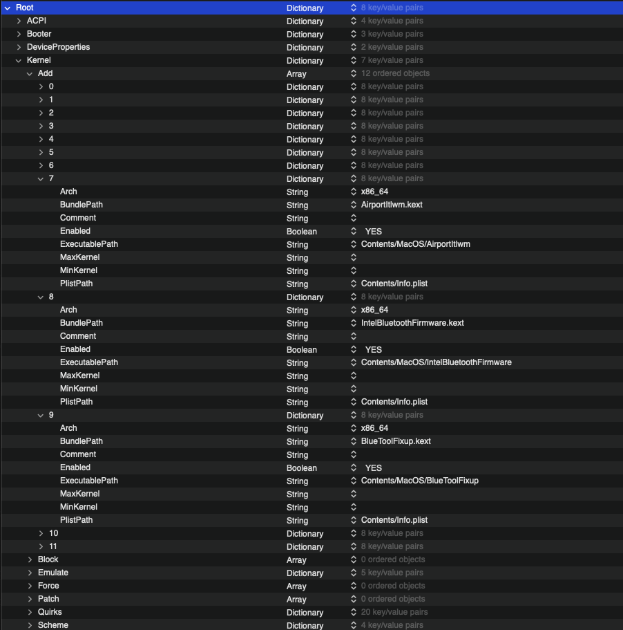

Side note, do you have a screen shot of your config.plist kext injection section? I am wanting to setup bluetooth functionality and using IntelBluetoothFirmware.key and BlueToolFixup.kext
2,145
@marinekev88 I don't need anything for BT on my system but I have an Intel NUC which does. This is how the config looks for that system on Monterey,

Yeah working here also. BT won't enable because BlueToolFixUp isn't there to fix it.
