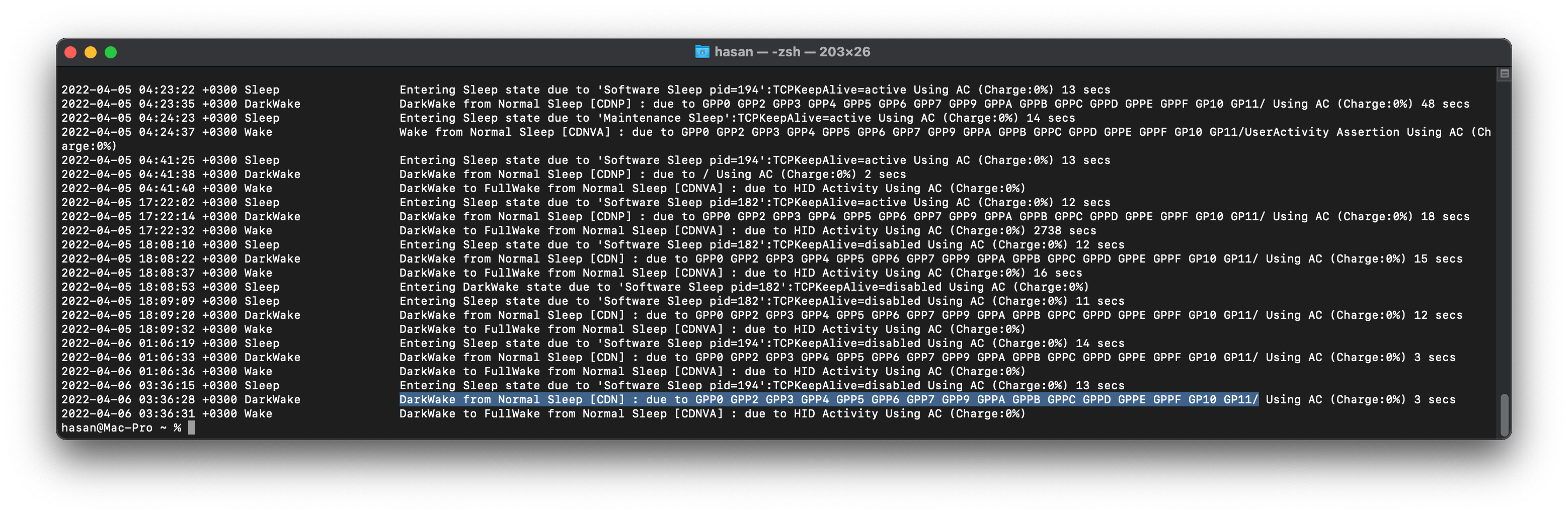

I'm now on Aourus Master and I have a problem with sleep after sleep wakes up immediately again. I use @Shaneee EFI 0777 without change (thanks) BIOS F35, otherwise everything I have in the description. I also have BCM94360CS2 Wifi Wlan Card to Desktop PCIe Wireless Bluetooth 4.0 Adapter For Hackintosh macOS. PC will immediately wake up after sleeping. Can anyone help me find the problem? Thank you
EDIT: If I drive off USB BCM94360CS2 Wifi Wlan Card to Desktop PCIe Wireless Bluetooth 4.0 Adapter Works all OK. Therefore, the mistake is about in USBports. Does anyone USBports.kext for Aorus Master?

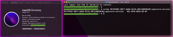

OpenCore 0.7.8 with MacOS Monterey 12.2.1 on Gigabyte Aorus X570 Pro WiFi
I though I'd post my latest EFI for people using the Gigabyte Aorus X570 Pro WiFi motherboard.
I was on MacOS Big Sur with the OpenCore version 0.7.0 for a very long time and decided to update both the OC and the MacOS. I first updated OC and config.plist following the official guides and made sure the existing install of BigSur was working fine. Then I went ahead and upgraded to the latest Monterey 12.2.1
Had a few hiccups with the upgrade process as it restarted a couple of times, but eventually the upgrade went through fine.
What doesn't work:
1. The onboard Intel l211 Ethernet does not work. As it is known now, the SmallTreeIntel82576.kext supporting this controller doesn't work on Monterey. So, I went ahead and bought a PCIe 2.5 Gigabit Realtek 8125 based card (Asus PCE-C2500 2.5GBase-T PCIe). This works great with the LucyRTL8125Ethernet kext. (Please disable it in config.plist if you are not using this card)
2. Onboard Bluetooth does not work. The resources say you can expect it to work with BluetoolFix include, but I haven't had success yet.
Other than this, everything else is working fine.
Build Specs:
  • CPU: Ryzen 9 3900X
  • Motherboard: Gigabyte AORUS X570 Pro Wifi (Bios Revision - F35)
  • Graphics: Asus TUF Gaming RX 6800 XT
  • Case : Lian Li PC-O11DW Dynamic XL
  • NVMe: Western Digital WD SN850 1TB PCIe Gen 4
  • Installed Operating Systems: MacOS Monterey | Windows 11 Pro
  • Bootloader: OpenCore 0.7.8
Note:
  • I've used the kexts SMCAMDProcessor & AMDRyzenCPUPowerManagement for power management and monitoring. If using monitoring, please also download the companion app - https://github.com/trulyspinach/SMCAMDProcessor
  • The CPU core hex values need to updated in Kernel - Patches of the config.plist to match your AMD CPU config (Refer README here - https://github.com/AMD-OSX/AMD_Vanilla)
  • Please use this EFI at your own risk. Make a backup of your existing MacOS install/data before you do any sort of upgrades.

Has anyone ran into issue where you shutdown the hackintosh, and then boots up all on its own to the opencore boot menu? This is happening to me many times, where it suddenly powers on its own after few hours I left after shutting it down. Dorthania's suggestion of using fix shutdown SSDT doesn't work with AMD builds since it does not show PMEE parameter in DSDT at all. I just want to know this before I actually take the effort on building custom USBMap.kext
Edit-- Working on building USBMap for my motherboard... I got the mapping figure out but it won't let me boot. oof. I'll keep trying.
Edit2– Remapped and disabled wake up on lan seems to have fixed it.

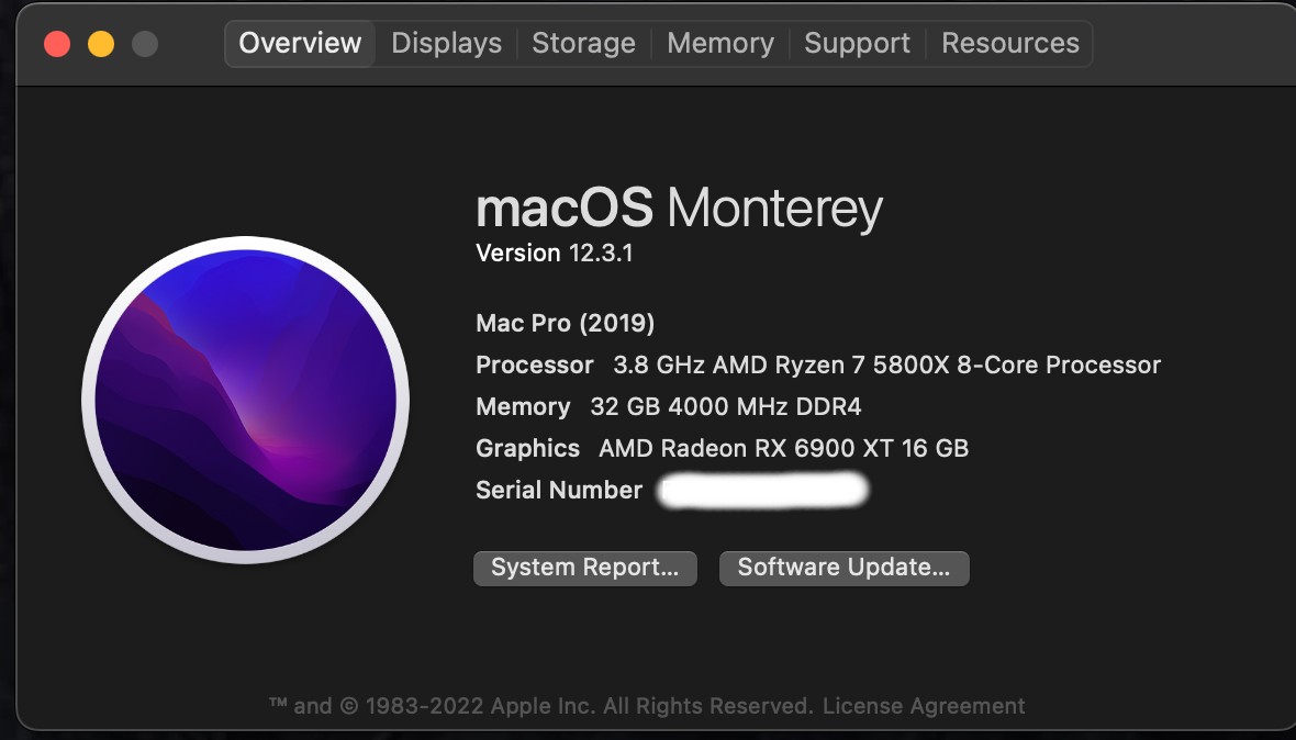

For me the solution to get 12.3 working was adding the AppleMCEReporterDisabler.kext
I also used the path to make the RX 5700 XT become W5700X and improve graphics performance:

Another one with X570 Master and having sleep-shutdown issue, cant figure out why, i have fully mapped usb, ssdt for tb3, cant figure out what is the problem

AppleMCEReporterDisabler.kext solved my boot issue on 0.7.9. and 12.3.1
sleep hasn't worked for me for sometime, shutdown has not been an issue though.
