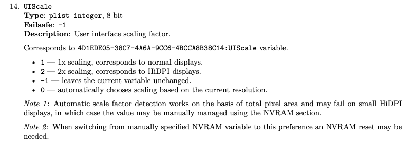

I did also have large opencore icons, but after crashing my OC and fixed it again, the size came back to normal.

@svan71 In the config, UEFI -> Output -> UIScale

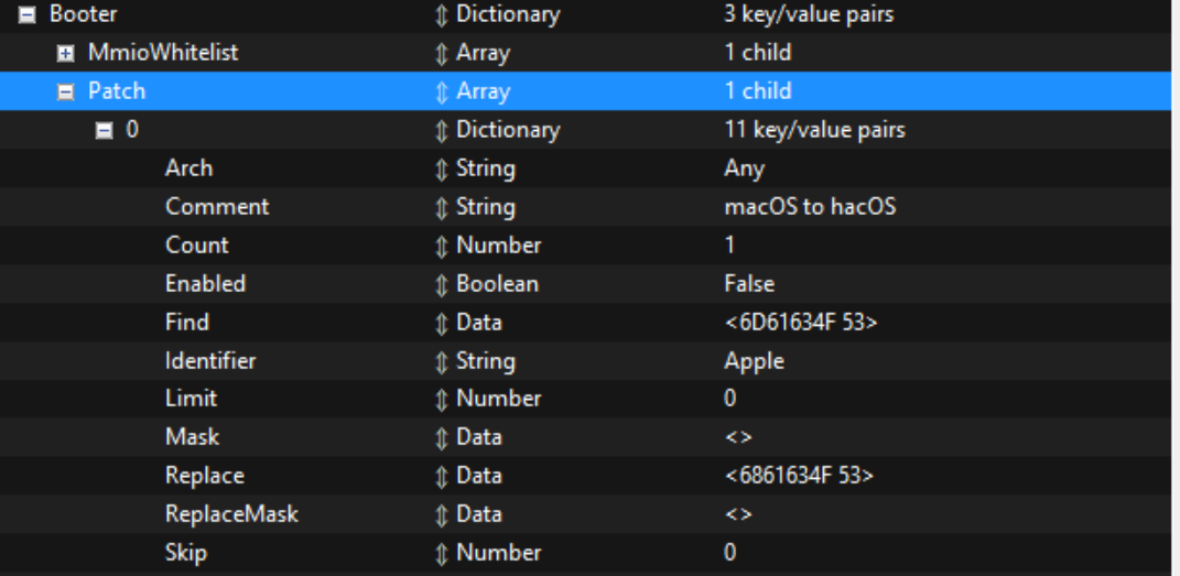

Shaneee one last question as I know you probably don't want to be bothered with supporting this EFI. On the 0.7.6 which seems to be working just fine there is a missing patch that was on 0.7.4. Should there be any reason for concern?
That patch isn't required and wasn't enabled on the previous config. It's just an example anyway.

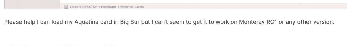

Isn't the Aquantia AQC-107 the card or very similar to the card used in the iMac Pro? Surely the ethernet controller from the iMac Pro is supported in MacOS Monterey.

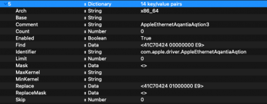

Are you using Mieze's Catalina or Big Sur Aquantia Kext patch in your OC config.plist? Looks like this in OpenCore config.plist:
Plist attached with just the Aquantia patch contained, which can be copied and pasted in to your own config.plist.

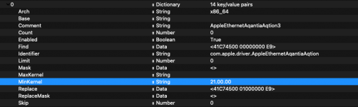

Here is Mieze's revised Aquantia patch for Monterey:
Patch attached below.
