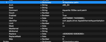

Just looking for a confirmation - there isn't a patch for onboard 10g aquantia nics yet?
919

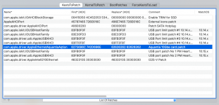

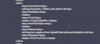

Not sure if this is what you need but there is a patch for the Aquantia 10Gbe card.
Screenshot 2022-01-31 at 00.10.42.png OpenCore Kernel/Kext > Patch
Clover Kext and Kernel patch in text and GUI formats.
Don't know how this would be different from a builtin 10Gbe port, but it may be worth a try.
DarkSilentSC
Jun 4, 2021
66
Your posted Find / Replace code seems different to what I have. Look for my post on Gigabyte Aorus Xtreme in this Success Stories thread for detailed Kernel/Patch description

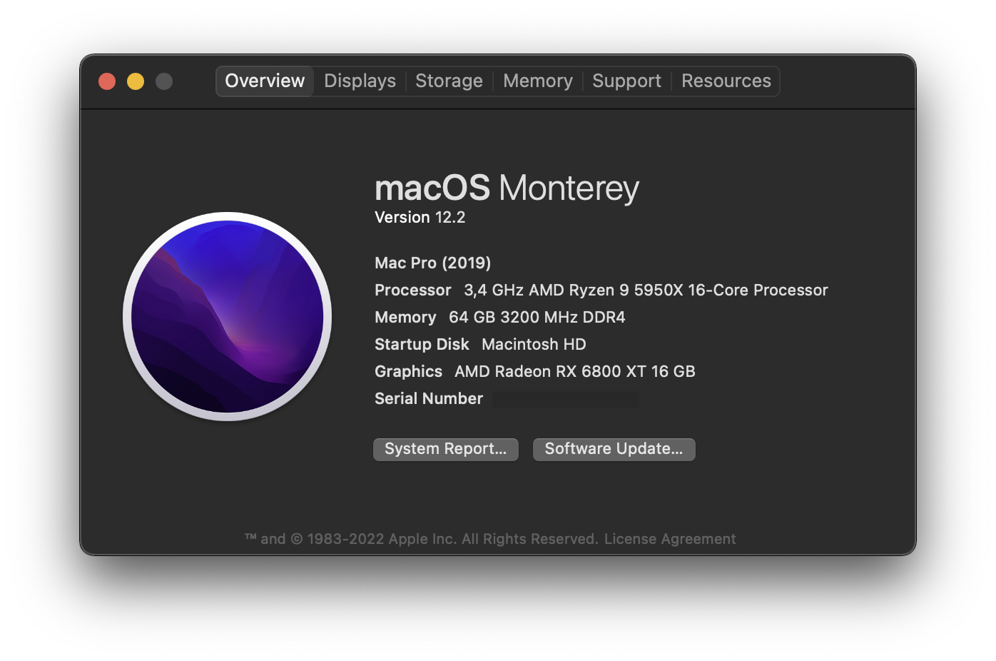

OC 0.7.7 & Monterey 12.2 work fine here!
I did an upgrade from Big Sur. I just had to disable the Intel NIC, and use the Realtek one instead.
However I cannot get the OpenCore GUI working again. I cross-checked every configuration setting with the guide, and everything seems to be OK. Is anybody else also affected by this cosmetic issue?
