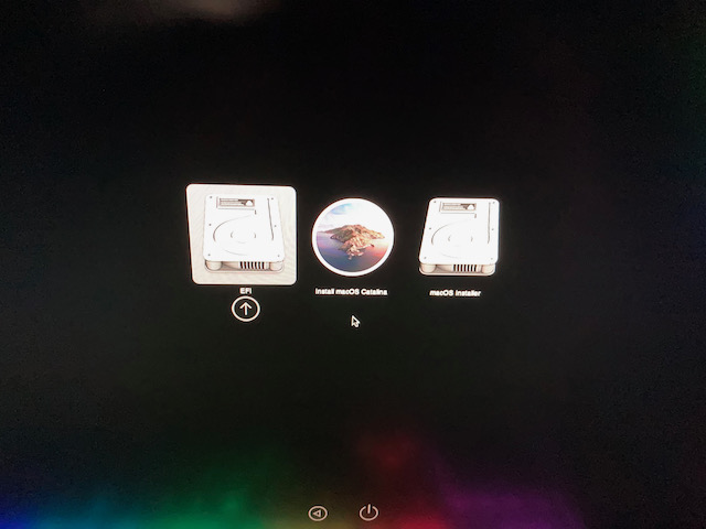

I'm getting kind of weird issue. I've been trying to upgrade my boot loader to OC from Clover and when I boot this EFI off of a USB (and I'm pretty sure the same thing will happen if I put it on the NVME EFI) it won't detect the installed copy of big sur. I tried changing the scan settings but otherwise I'm using the vanilla EFI from the top of this thread. HW is a Gigabyte AORUS X570 Pro, XT5700, Ryzen 9 3900X, w/a Sabrent NVME. Any thoughts or ideas are appreciated
Can you see your USB macos installer with the EFI?
When you installed originally did you do it on clover And did you do it with CSM enabled in the bios and do a legacy instal by mistake?
Are you using the bios settings laid out on page one of this thread?
With your system spec the EFI should work out of the box for you with no changes other then your smbios details needed.

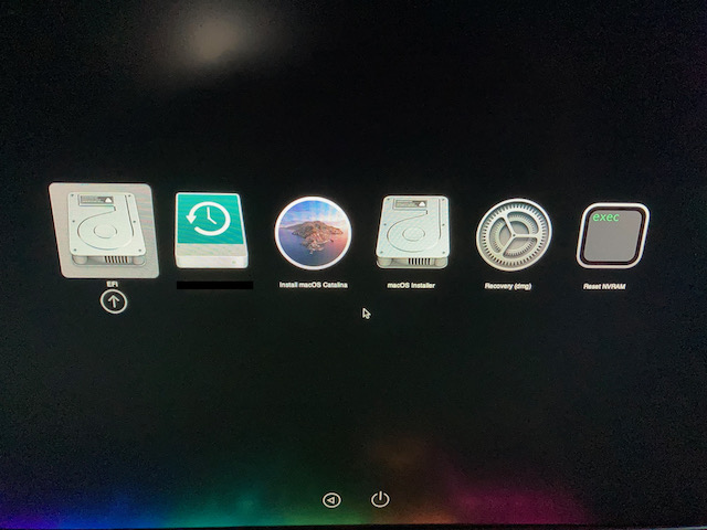

Thanks for the reply! I don't believe that I did a legacy install and I can see the USB MacOS installer. I just double checked the BIOS settings and those are fine. The 3 options I get when I get to the select screen are EFI, Install MacOS and MacOS Installer. When I press spacebar I can then see the Time Machine drive and recovery options. Is it possible the SMBIOS could be messing it up? I just selected iMacPro1,1 and saved it to the config file but could something there be preventing it from detecting the APFS drive?
@tj4736117 Show me a screenshot of the bootpicker please mate?
the Drive labeled MacOS installer is your nvme drive. You have a broken snapshot by the look of it.
Select it!
Select it!

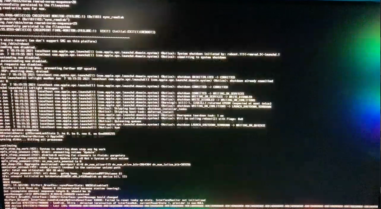

Selecting that brings up the boot menu which gets about 10--15% into the loading bar before rebooting. I turned on verbose mode and logging to see what I could get. The log file was empty so I tried to catch the output on video. Sorry for the quality but here's the last set of messages before it reboots. The "We don't support SMC on this platform" error seems to be the problem and the only real google hit I found said that someone solved it with a clean install. Any ideas? Otherwise that may be the route I need to go.
I was just to suggest the same thing and do a clean instal cos your snapshot or your seal is broken fella.
Oh well. At least it's easy to move the files between installs :) I'll update later in the week when I get the chance to rebuild it. Not in a hurry to rock the boat as long as Clover is working.
Reactions: AudioGod
If it works with clover then why don’t you make a TM backup of your system and then fresh install big sur using OpenCore and then restore your time machine backup?
that way it’s no pain for you and you end up with a lovely fresh installed system using OpenCore instead of Clover that is obviously messing with your install and snapshot otherwise you wouldn’t have this problem to start with.

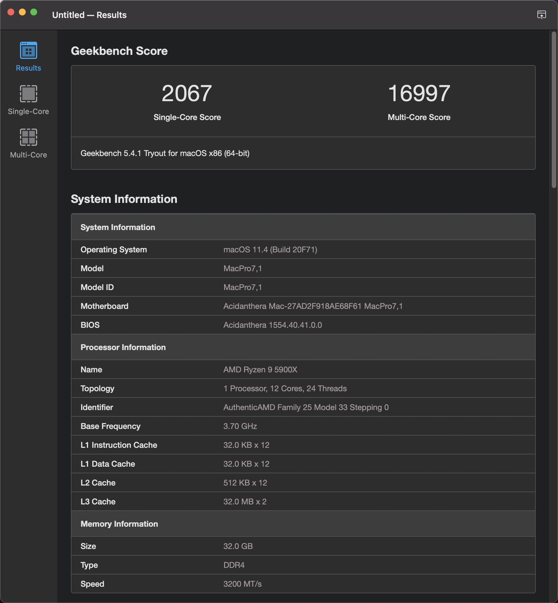

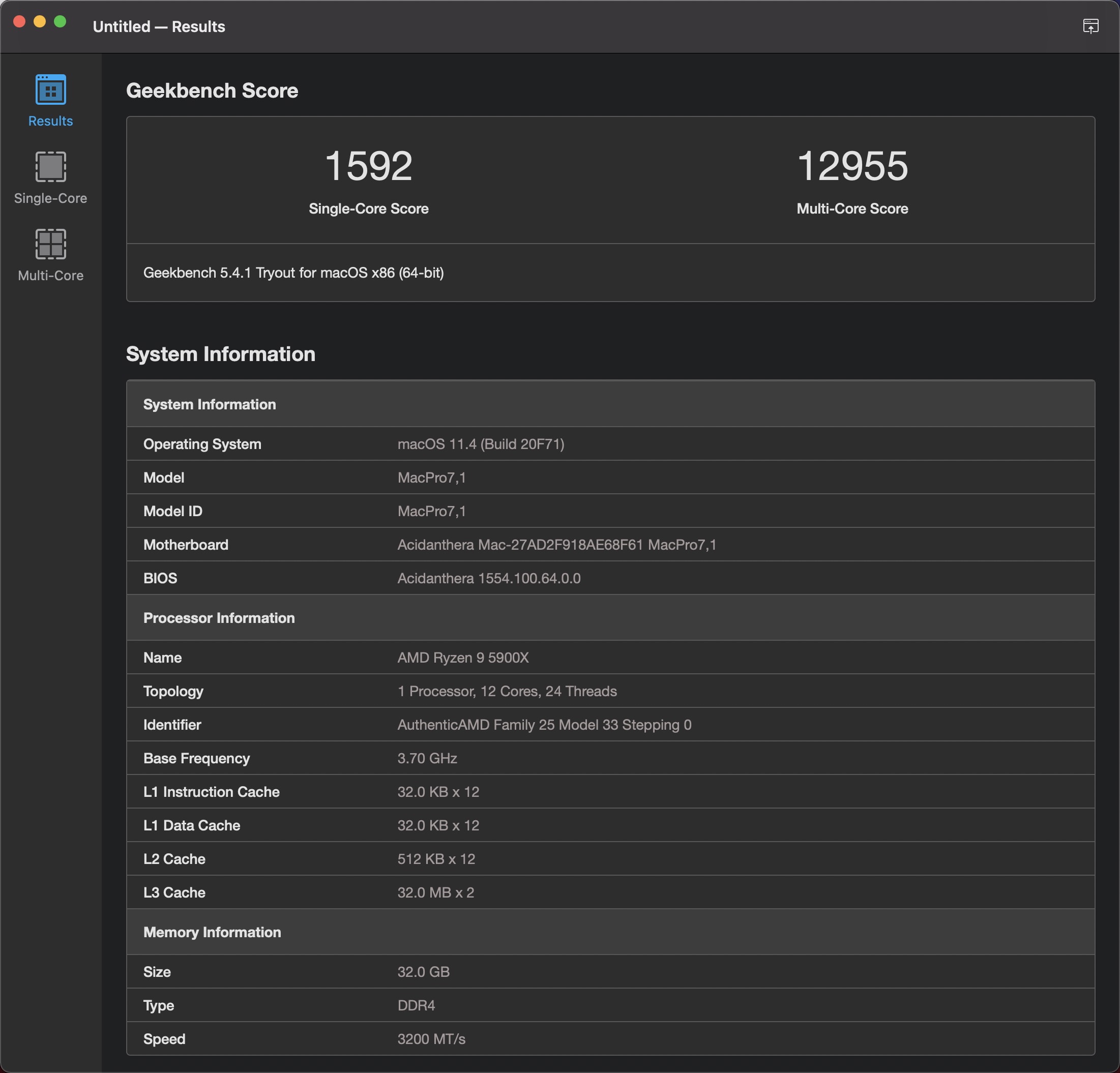

Thanks for sharing this. However after a week of trial with your EFI I've found major performance deficiencies with your version of EFI (OC070). My GeekBench score suffered more than 20% of losses single core score dropped from 2067 down to 1595 and multi-core score from 16997 down to 12996 . So I switched back to my original EFI (OC063 based) then everything suddenly goes back to normal again.
After carefully reading your posts again I realised your GeekBench score was always at this level and so soon as I use your EFI I will get the same level too.
Not sure what's cause of this though but just hope you can notice this and maybe improve your EFI and unlock all potentials of your hardware.
Here is my score before and after:

I think your GeekBench is way too low for your hardware.
Here is mine based on OC063 EFI
What version of geekbench are you using?
my scores are spot on and correct across MacOS and Windows.
I think your using an older version there buddy.
check again with the latest version.
edit, hold on how you scoring over 2000 single core?
surely you must realise that’s not normal, check any bench mark for a 5900x.
Something is very wrong there my friend.
@charlesbizi I will rest my case with absolute proof.
Please notice that the very top scores are overclocked to the max and under water.
What you have with the 2000 score is a fake result. Not faked by you but just wrong.
My Results,
That’s with PBO boost and perfectly inline with all the official geekbench results.
No problems on my side I’m afraid to say but that 2000 single core score is awesome but it’s a shame it’s not real. Hehe
If that was a real score then you would own the fastest single core CPU in the world with no exotic cooling and somthing Derbauer could only dream of doing with LN2…😂🤣

My GeekBench Version 5.4.1 (503823)
I'm totally baffled. I'm really new to this so I just downloaded this and run the test and never done anything weird to my hardwares nor over clocking. My CPU was cooled normally with AIO and graphic is official AMD air-cooled.
So really unsure what happened here lol
Really I wish I know how to hack the score on this lol!
