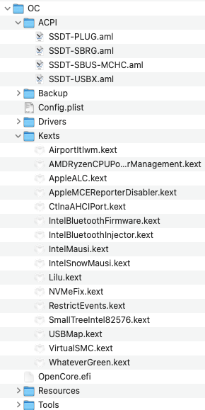

What’s with all the extra kexts you have going on in the kext folder?
i see 4 that are not needed and 2 of them 4 that have nothing to do with your setup.
AppleMCEReporterDisabler (not needed)
intelMausi and IntelSnowMausi (both useless with your setup)
CtlnaAHCIPort (why?)
To get your Bluetooth going try fully shutting down the system and then unplug it from the mains and wait a few minutes, plug it back in and boot back up and this should kick your Bluetooth into life.
I've cleaned up my kext list per your response and bluetooth is now back. Thanks!

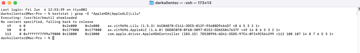

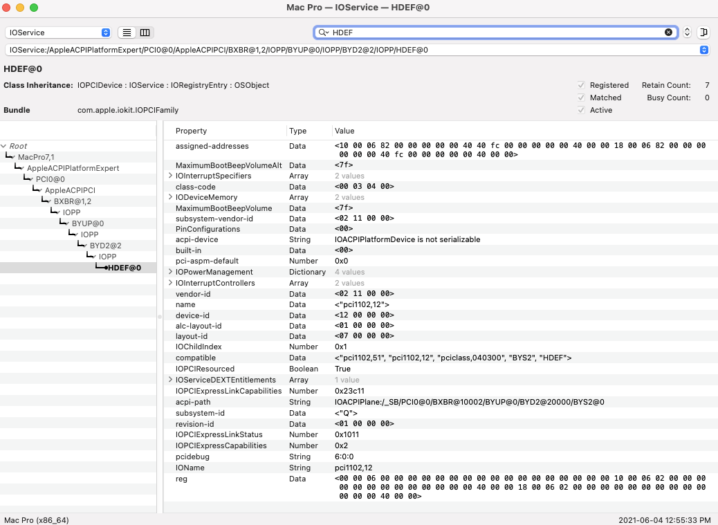

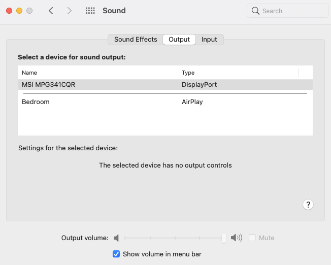

None of the alcid is working... I'm afraid something else is up. Putting more screenshots as below.

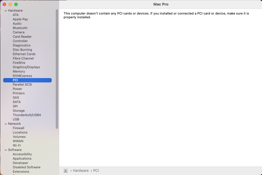

About that Creative Labs stuff.. That's my Sound Blaster AE-5 that I was using for Windows. You can ignore that if that's impossible to be used in hackintosh. Am I supposed to use "Starship/Matisse HD Audio Controller"? I don't see any Realtek entries here for some reason...
@DarkSilentSC Are you selecting the internal speakers in the sound properties?

We don't want to populate the PCI Tab (its cosmetic only when you do)
Those list doesn't appear at all... uwu

I think all 3 modules are working as per above. Not sure what's going on owo

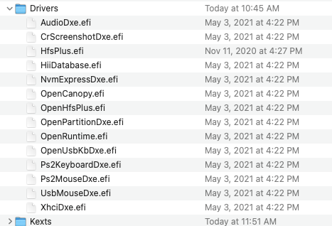

Could be that I messed up driver list as well. XD Please have this a look
Get rid of everything apart from HFSPlus, OpenRuntime, OpenCanopy if you're using it and AudioDxe again if you’re using it
Cleaned up the drivers, but that didn't make any difference... ooof

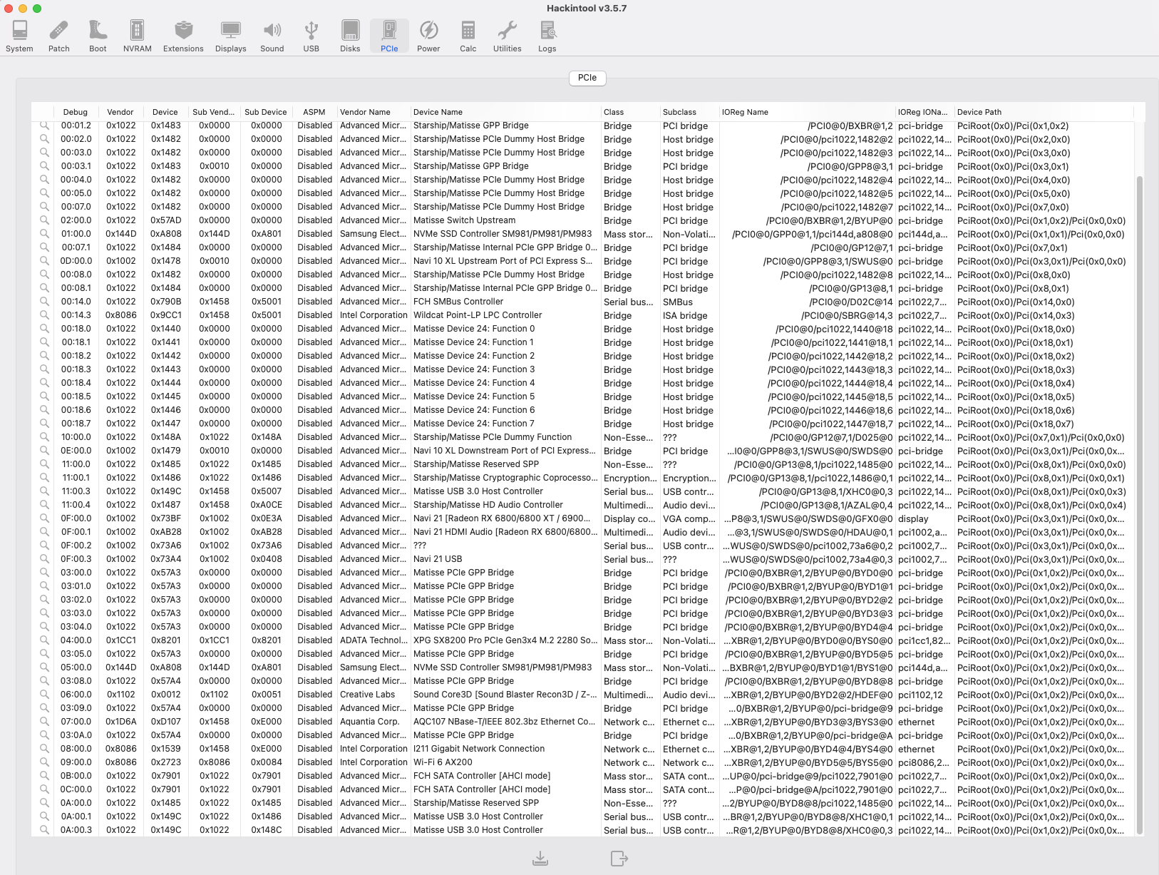

Update - Hackintool list literally shows no Realtek devices at all... Shouldn't that appear regardless of alcid number placed in boot args?
Ok try this in that case.
Okay! I got the ALC1220VB audio devices listing in Sound menu with volume control.
AudioGod - YOU ARE A GOD - THANK YOU SIR.
