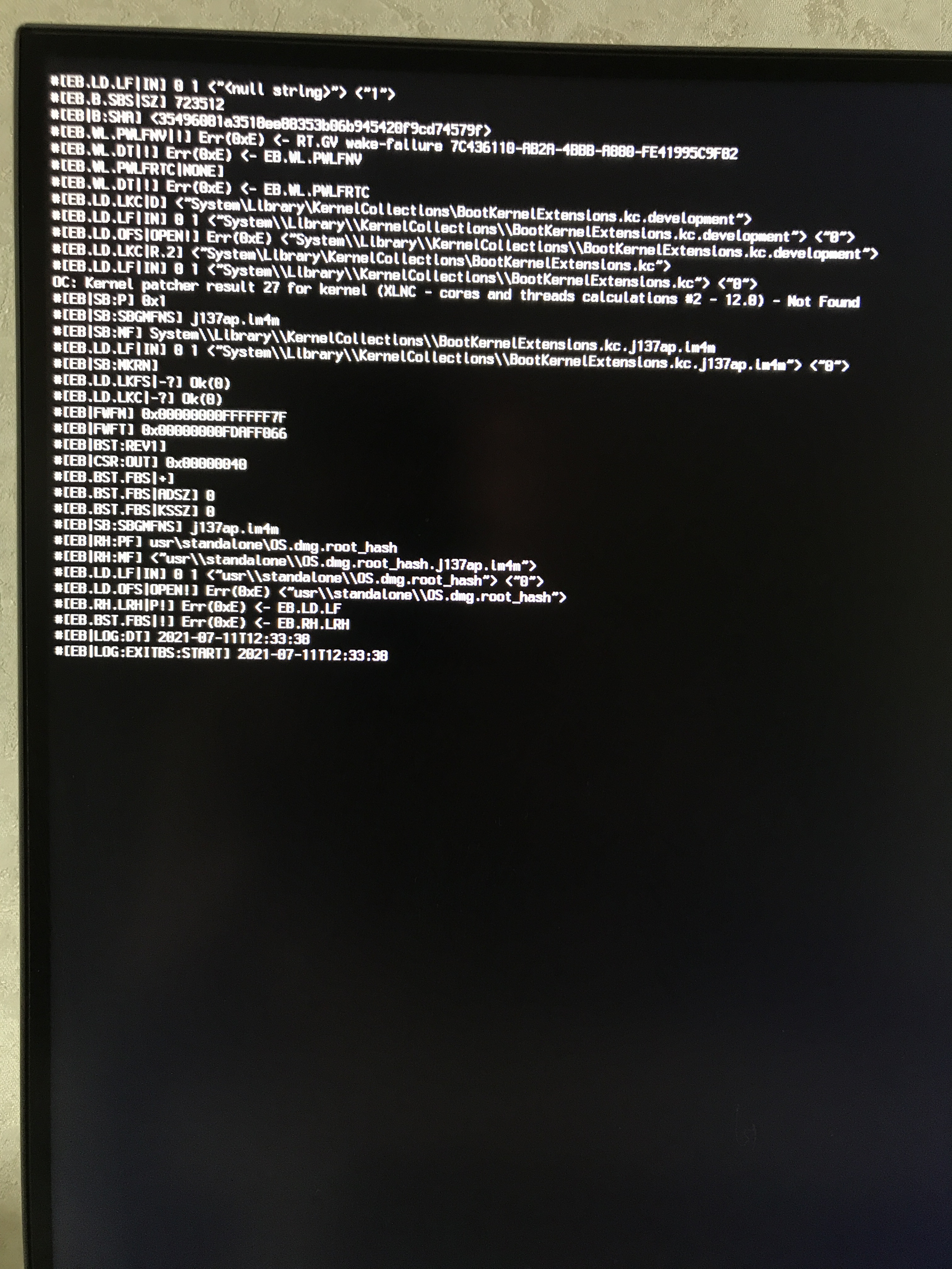

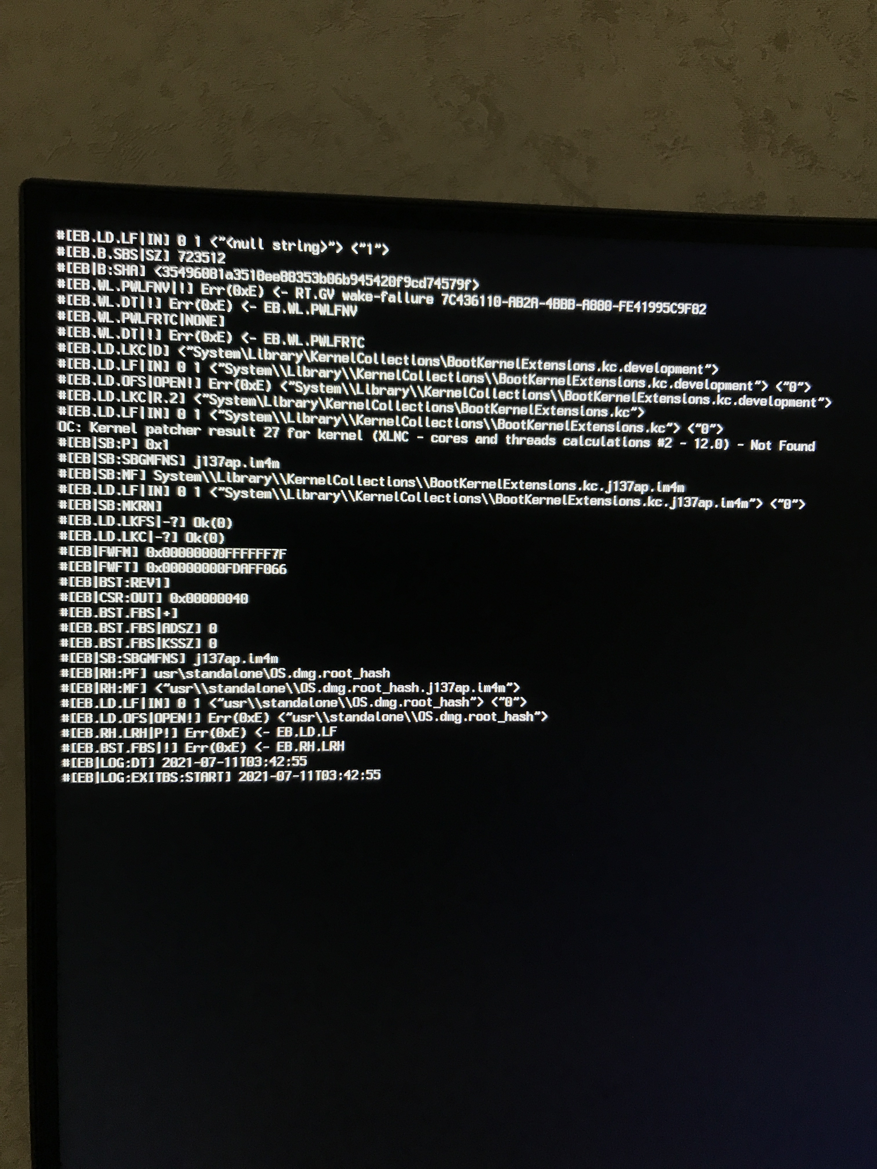

Hi, I try to installing it, but I’m stuck at #[EB]LOG:EXITBS:START] 2021-07-11T03:42:55
Can y help me? My config is Ryzen 7 5800x, Aorus pro rev 1.2, 5700XT, 32 Gb Ram
@xenearz Makesure you are using the correct bios settings listed on page one of this thread and you're using the latest bios revision.
I update my bios version to F34b from F33, bios settings are correct, but I’m again stuck at this screen :(
Did you add your smbios details to the EFI and have you got above 4G decoding disbled in the bios?
Did you add anything other then what I provided inside my EFI because you don’t need to if you did?
If you have everything setup correctly it will work buddy.
