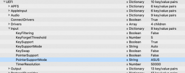

Very Good job. I haven't checked everything, just that asus reference i don't understand, perphaps to do with your asus MoBo ?
Na that’s how it is as standard even on the sample config.plist, I’ve just never changed it.
