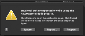

FreedomDK
Aug 15, 2020
Hi and thanks for your valuable work. I try hard to get all Waves Plugins to work in Logic X Pro. However some of them fail.1619471496270.png
Have you got any experience in how to fix this? I already installed Pavo's Discord fix which solved it for some of the Waves plugins, but not all unfortunatly.
Help is much appreciated.
And super cool computer you've build :D
AudioGod
Nov 7, 2020
1,386
Hi,
unfortunately not all waves plugins work on a AMD hack and other then the ones you have already fixed using pavos trusted fix I don’t know of any other fixes for the remaining failed units. Some is better then none I guess plus there are plenty better options out there that work just fine in my opinion.
