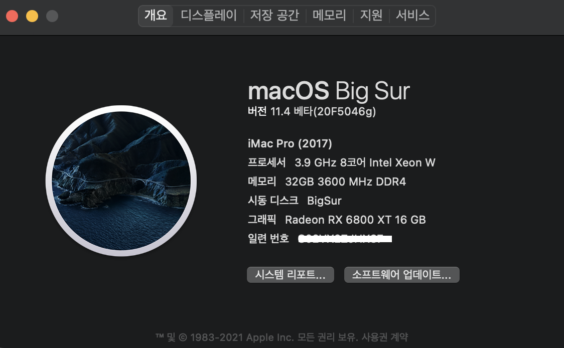

chiefsucker
Feb 23, 2021
20
Screw it, yolo and crap:
Maybe beta isn’t more unstable than release these days with macOS.😜
Everything works fine so far. I can remove my GPU disable hack (finally!), so sound will work out of the box. And then I can release the turtle and let him out into the deep ocean (no more GT 730, yay). I use DisplayPort and my first subjective impression was that the colors were slightly muted, but it was mainly a calibration issue and the overall image quality is way better now than with the ancient GT 730 I had to use because of missing drivers. I guess I’m one lucky bastard.
For full reference: I had to add agdpmod=pikera to boot-arg, because I would get a black screen fairly late in the boot process when WindowServer activates. I also left WEG enabled, I guess it mostly has a negative performance impact right now?

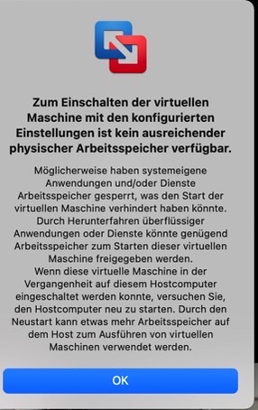

singing_fish
May 12, 2020
Thank you very much for the best OC related information I ever read, AudioGod.
It works nearly perfect here :)
Just one issue is left. If I try to start a VirtualMachine I get the error message: "to start the vM there is not enough physical memory available".
On the same PC with Clover and Catalina it works nice.
Sadly VM Ware is very important to me.
Any help with this is welcome,
thank you,
René

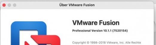

singing_fish
May 12, 2020
Thank you for your response,
I used VirtualBox for a long time but since I am working for different carmakers I need VM Ware, because it emulates the internal IT Systems.
VirtualBox machines will be noticed as "intruder" and immediately blocked :(
Well, I'll try a little to solve this problem.
If somebody is interested in running VM Ware Fusion on AMD, see the attached file for the working version (ok, at least with clover and 10.15.xx).034858F2-9473-4077-A808-3C325FBDDABC_4_5005_c.jpeg
