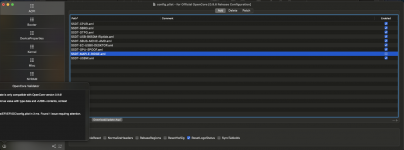

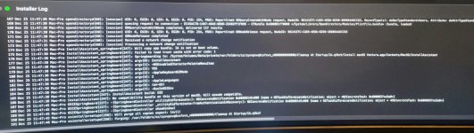

Thanks for the instructions.
I used your configs and generated some new serial numbers in 2 ways.
The first way was through GenSMBIOS
The 2nd way was through the OpenCore Configurator.
Both produced the same outcome. Here's a pic of the logs.
Not sure what's up at this point, but at least we got this far....
Does the installer log just freeze/stop at this point? If so, does the same error message still appear, "macOS Ventura is not compatible with this Mac"?
The last 5 lines in those previous pictures only show up after I click "OK" to exit the "macOS Venture is not compatible with this Mac" dialog.
So. the installer log doesn't quite stop, it will keep showing logs if I try more actions, like repeatedly trying to install.

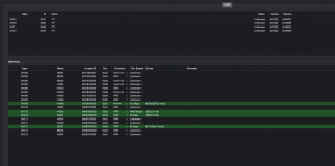

I have two issues with my build (Asus Tuf Gaming B650M-Plus Wifi w/ AMD 7950X)
1. Keep getting "Disk not ejected properly" after wake (USB hard drive plug directly at the rear). Don't want to use the Jettison app for this fix.
- USB Ports already have been mapped
2. YouTube videos would play at 10x after wake if all cores were overclocked at 5.0GHz or above. Anything at 4.9GHz or below, then is fine. Normal overclock with PBO is no issue.
Besides that, the build is working great at 99%. Thank you

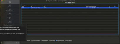

In general: TB Controller in Windows is on PCIO.GPP1.NVME.
Removing NVME Device I can inject SSDT-Maple-Ridge and UPSB Device.
TB is on GPP1. GPP1 is defined in SSDT-4 "CPMTBASL".
But I have also GPE and GPP1 in DSDT.aml
Currently I have:
Dropped CPMTBASL because it gave me ACPI errors. LPC0.EC0 not found.
With this setup, no ACPI Errors. 22 tables loaded successfully.
I have tried:
  • Dropping CPMTBASL and of course injecting SSDT-Maple-Ridge. SSDT-Maple-Ridge injects with removing NVME Device under GPP1.
  • patching DSDT.aml and also trying to replacing NVME device with UPSB and everything underneath, so basically injecting what's in the SSDT-Maple-Ridge directly into the DSDT.
Hotplug works fine, and the IOReg also looks fine with both methods. So UPSB ->DSB0->NHI0 etc. are successfully injected as well as the XHC3 USB.
But as soon as I restart, I have a bootloop and need to CLRCMOS to get it starting again.
