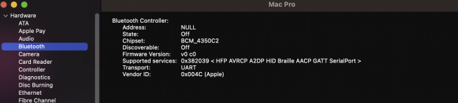

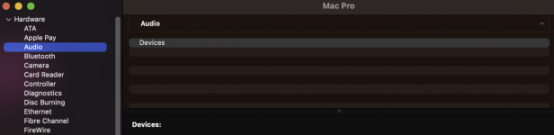

Hi CaseySJ, I was successful install Ventura using EFI OC 091 Asus x670e Gene for my X670e Pro Prime and Fenvi T919 for WF/ BT. I have problem with BT, audio and thunderbolt/usb4. What should I change to make its work. Thank you so much. IMG_6839.pngIMG_6840.pngIMG_6841.pngIMG_6842.png
fabiosun
Oct 9, 2022
478

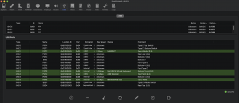

@banhmi
You have to map well your USB (for audio and BT)
for thunderbolt i see the same but it works well (only hotplug is problematic)

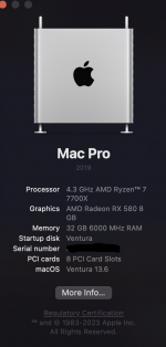

Hi everyone,
I'm new in hackintosh. After hundred of time reset Cmos and thousand of reboot , I was successfully installed Sonoma. Thank you everybody, who spend a lot of time to create and share the EFI. I'm extremely appreciative. Thanks a lot.

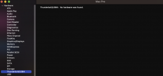

I got the bios of the Asus ProArt X670E corrupted after numerous attempts to get TB hotplug working.
Short story long,
Two days ago I thought to have accomplished to thing I was painstakingly trying to get working.
I used the TB3 SSDT within your package which didn't give me anything pointing towards a TB device not under PCI nor under Thunderbolt. For the latter I just read the evidence that I'm not alone. After adding the SSDT-SBRG however, I got two new PCI devices presented. The first was the Thunderbolt device and the second was my UA Apollo x4 that's connected to it. I raised my arms, resulting in back muscle cramps, shouted "yeahooouuch *******" and when the cramp stopped I played around with some DAW's that won't run on Windows.
I also checked some data in the IOReg app and I finally could see full paths to the PCI devices which previously were missing, even when my x4 was working so without the SSDT's which I still can't understand tbh. Oh and before I forget, I fully mapped my own USB ports and dumped all the ACPI shizzle using Windows prior to my second journey on the OpenCore route (had OC running on a Gigabyte X570 board without any issues for years).
So totally overjoyed I switched on my Hacky this evening and after 30 seconds I really knew something was wrong...again.... I got a black screen and my case fans nearly did "wingardium leviosa" my case through the room. I think you also have the LED on your Mobo to see the cycles/checks the Mobo performs prior going to the bootmanager. Normally the cycle ends with a white LED, lowering fan speed and the boot manager is presented/used. The white LED never appears. I tried resetting, pulled the plug, pulled the mobo battery, short-circuit the clear CMOS header, really every single thing to get the bios to reset. At first it helped but when I configured every setting back to which is needed to represent the OC settings (disabled sound/bluetooth/WiFi, these two d*mn annoying Asus Bloatware pushers for Windows and some other things) and Save/Reboot the Bios settings/System I got back to no white LED/Bootmanager. At the end nothing helped and I really thought I bricked the board, with a great and special boatloader that is.... Thankfully that USB port that can flash a bios saved the day and I'm now writing this in Windows totally afraid to boot up Ventura.
I Googled the issue and I've seen guys having the same corruption issue with Gigabyte boards a while back but not with Asus boards. I also read the OpenCore manual again, zoomed in at the OpenCore Boot Issues section but I couldn't find a definitive answer to the question why OpenCore can do something destructive to the Bios making it unable to get to the white LED cycle. Why does OpenCore need to change the bios to work and why does this result in a corruption, this can't be behaviour by design?
I'm clearly missing something here. Did I fubar my system because I used the SSDT-SBRG.dsl for instance? This SSDT was added just before the system went dark. Still, apparently it's needed to get the Thunderbolt device showing up and have otplug working. As I'm writing this I'm really in doubt of having seen it working (hotplug) or that I dreamed seeing it work. One thing is for sure, the PCI devices were visible which was not the case before I added SSDT-SBRG.
@CaseySJ or anyone elase, did you encounter something like corruption? Does anyone have got TB hotplug working with both the dsl files or maybe with just one or none? Is there something I totally forgot to configure perhaps?

I had hotplug work on the x670e hero but when rebooted or shut down the bios reset, but it also happened when activating hotplug on the titan ridge on pcie and not just on the internal tb4. It's definitely an am5 bios bug.

1,282
@RapidAdjustment,
I commend you for the effort in trying to make hotplug work on AM5 platform.
This may be hard to hear, but I really don’t think Thunderbolt hot plug is going to work in any acceptable manner.
If we just avoid any Thunderbolt SSDT and connect our Thunderbolt devices before boot, they will work. They may or may not work after wake-from-sleep.
If Thunderbolt hot plug is needed, we have two options: (1) a real Mac or (2) an Intel Hackintosh with a flashed GC-Titan Ridge add-in-card.
On the other hand, older Intel motherboards with on-board Titan Ridge controllers are also good options.
