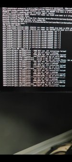

After adding CaseySJ - probeBusGated Disable 10 bit tags - 12.0/13.0 patch, booting is fast
Unfortunately, when the boot is about to complete and enter the desktop, the screen is black, the USB keyboard is unresponsive, and the machine is unresponsive. I recorded the guide video, and the final picture is like this. . .
1,285
@daliansky,
I wasn’t able to open the ACPI tables that were posted earlier (DSDT, SSDT, FACP, etc). If you set the following parameters in OpenCore config.plist, those files will be generated in a folder called SysReport in EFI partition:
  • Misc -> Debug -> Target = 67
  • Misc -> Debug -> SysReport = True
After making these changes we just need to reboot and get to the OpenCore boot picker. Now the SysReport should be ready.
The two parameters above can then be changed back to their previous settings.
