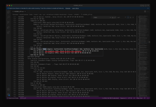

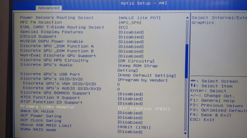

Today, when I was adapting the mainframe with the same specifications from another manufacturer, I found through the BIOS that there is an option for Primary Video Adapter. It is estimated that the default setting is Int Graphics (IGD) when the factory leaves the factory. I'll contact the factory to see if I can get a full-featured BIOS. I will update on this thread.

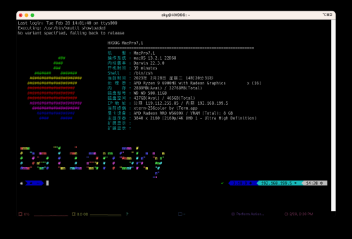

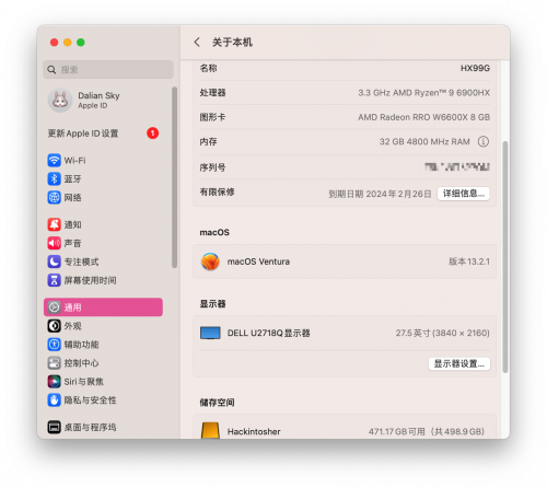

The good news is: it can be installed, but only two USB ports can work normally;
Existing problems are: a. Unable to wake up; b. The USB 3.1 bus where Bluetooth is located cannot work properly.

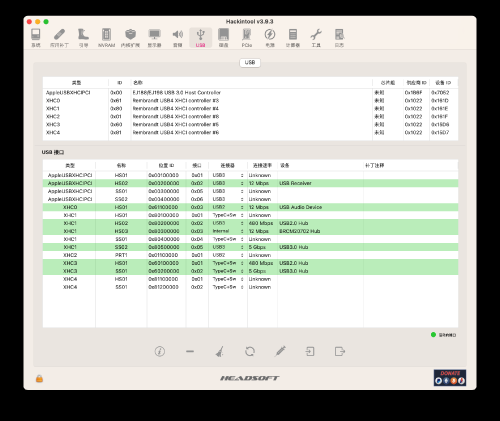

When I plug the device in the two usb4 ports, the device is recognized in hackintool, but when using diskutil list, it gets stuck and the device becomes unresponsiveUSBPorts.png
