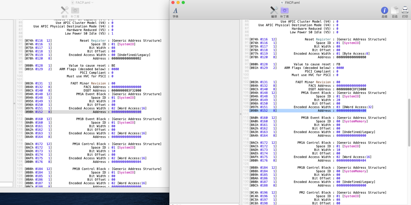

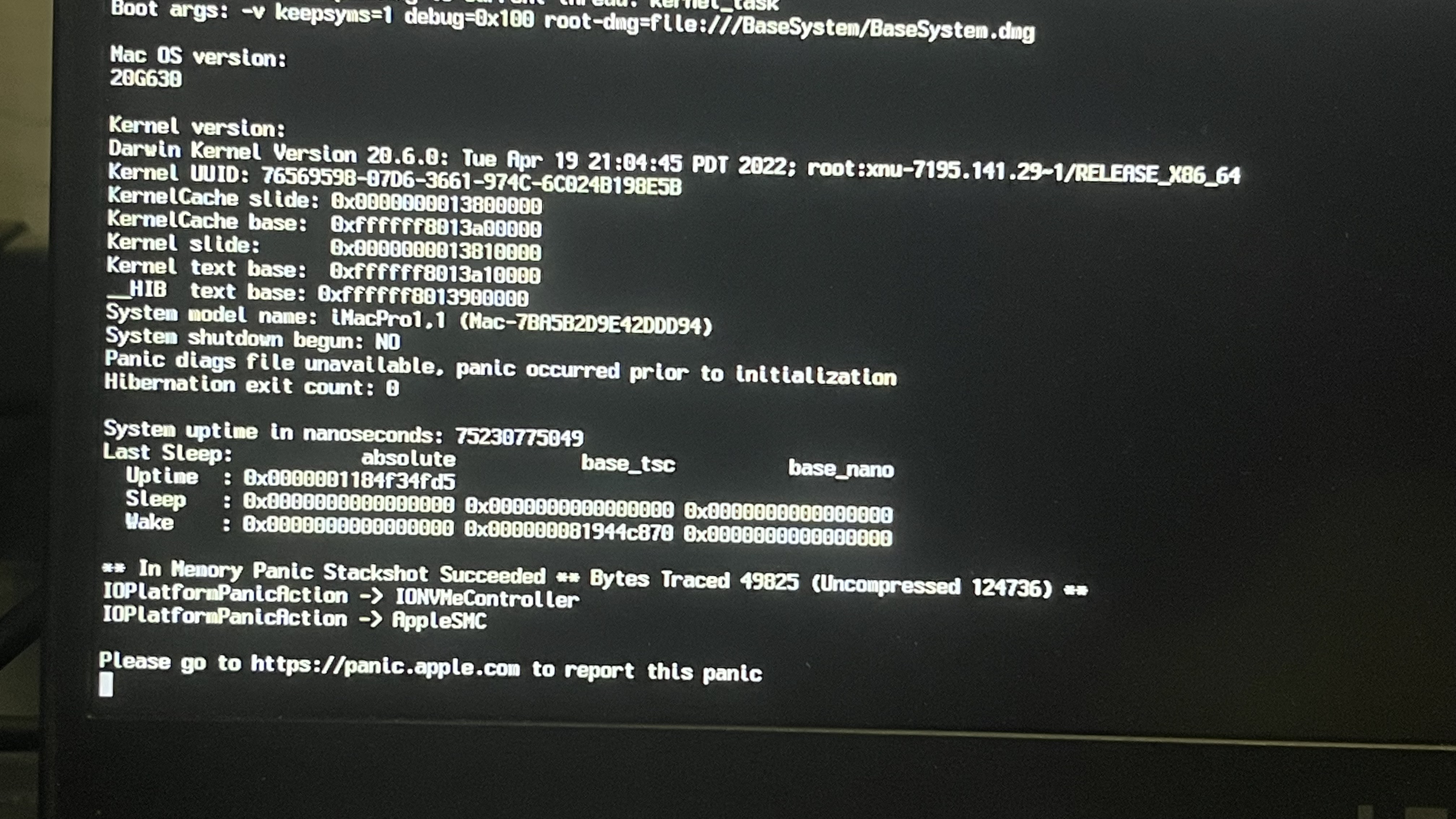

Panic from Monterey 12.6

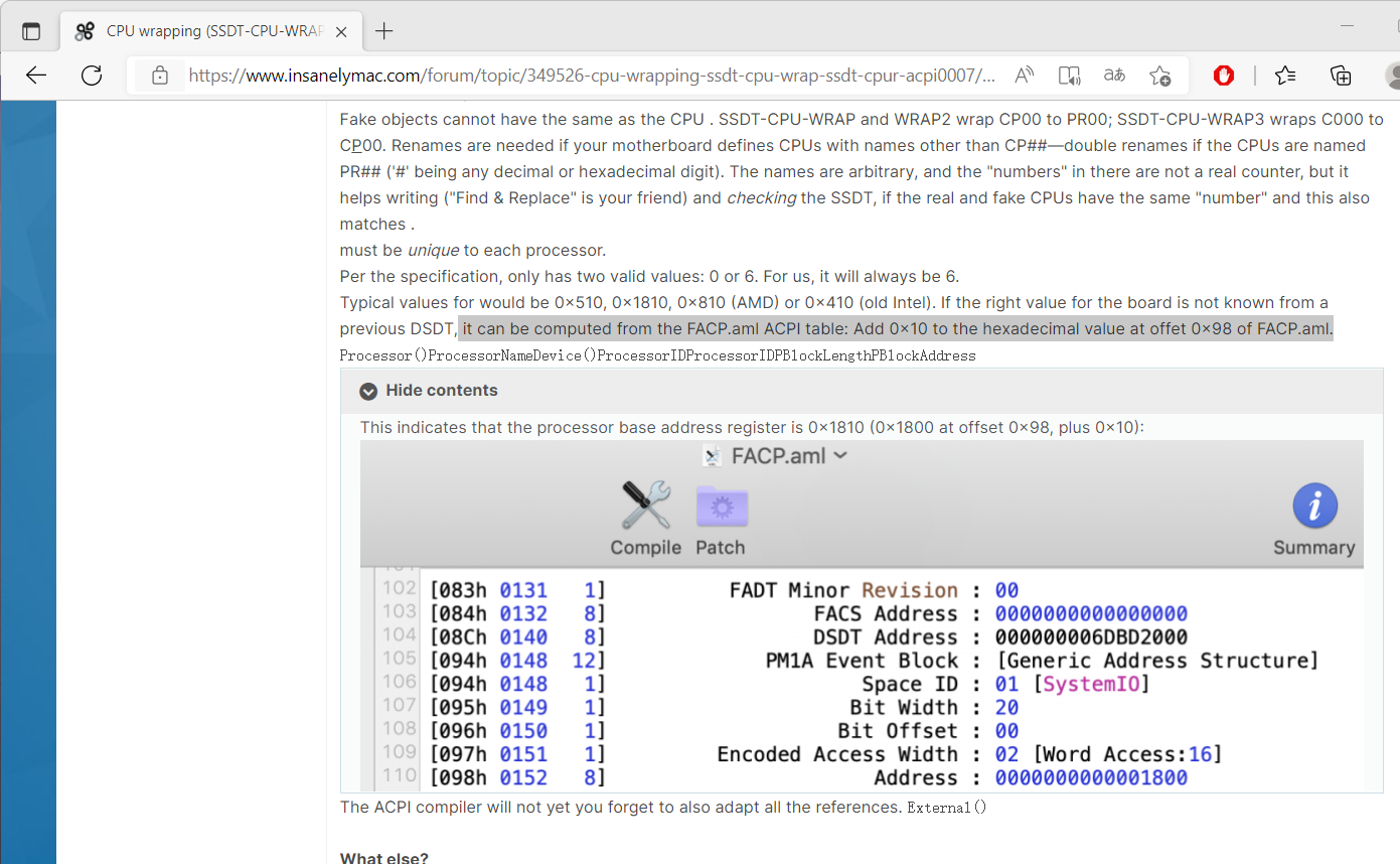

I compared @cr4700 FACP.aml again, and found that his is 0x800, is the correct AMDCPU parameters, my FACP.aml is 0X400, this website says that 0X400 is the old Intel, which I think is strange, this is AMD's FACP.aml, how to use Intel CPU parameters
That's correct. Which was why I provided the alternative SSDT-CPUR-5800Hs to you both before to test. Reason being was that I'd found two things that differed between your DSDT and my B550 Ryzen 9 5900X build DSDT which you had been using up till then. One was these values of 0x400 on yours and the second was the naming of the CPU registers from processor to device, which required a different wrap.

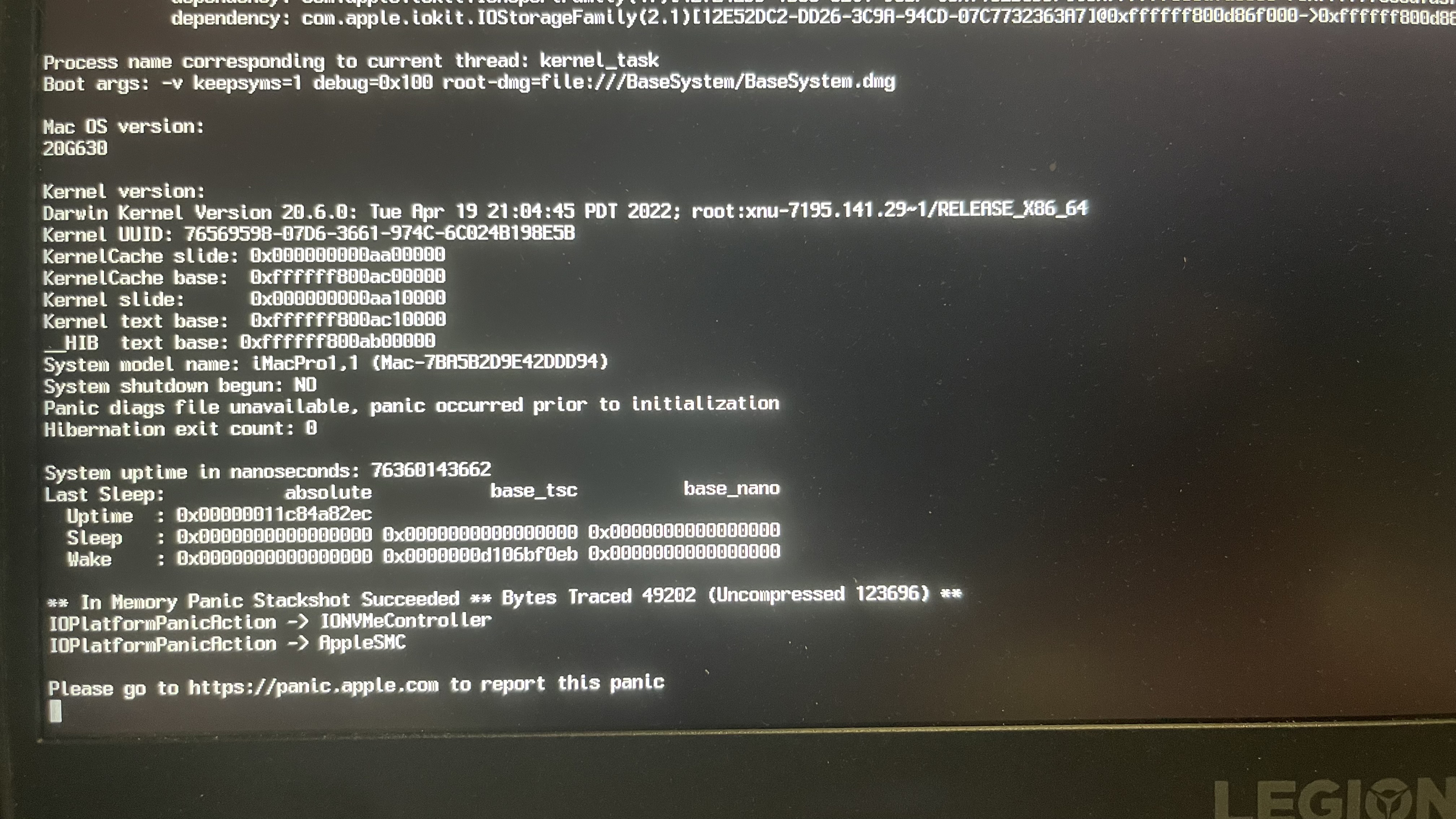

在第一次重新启动后以及当它开始在ssd上提取时,如果没有我的nvmefix.kext,它就不会超过ionvme。我相信这是因为我正在使用的SSD类型。我在所有其他运行相同SSD(XPG Gammix)的台式机上都有nvme kext,所以这可能就是为什么这些台式机没有遇到麻烦的原因。我现在是几个重新启动到蒙特雷升级。如果我试图使用Big Sur EFI进行升级,它会崩溃,我必须使用Monterey EFI启动Big Sur才能让它在没有内核崩溃的情况下进行升级。
您好,您能提供您现在正在使用的 EFI 吗?我也一直遇到这个问题。我无法进入安装程序

使用EFI后,它仍然卡在这里,安装了版本11.6.7,这个问题已经好几天没有解决了

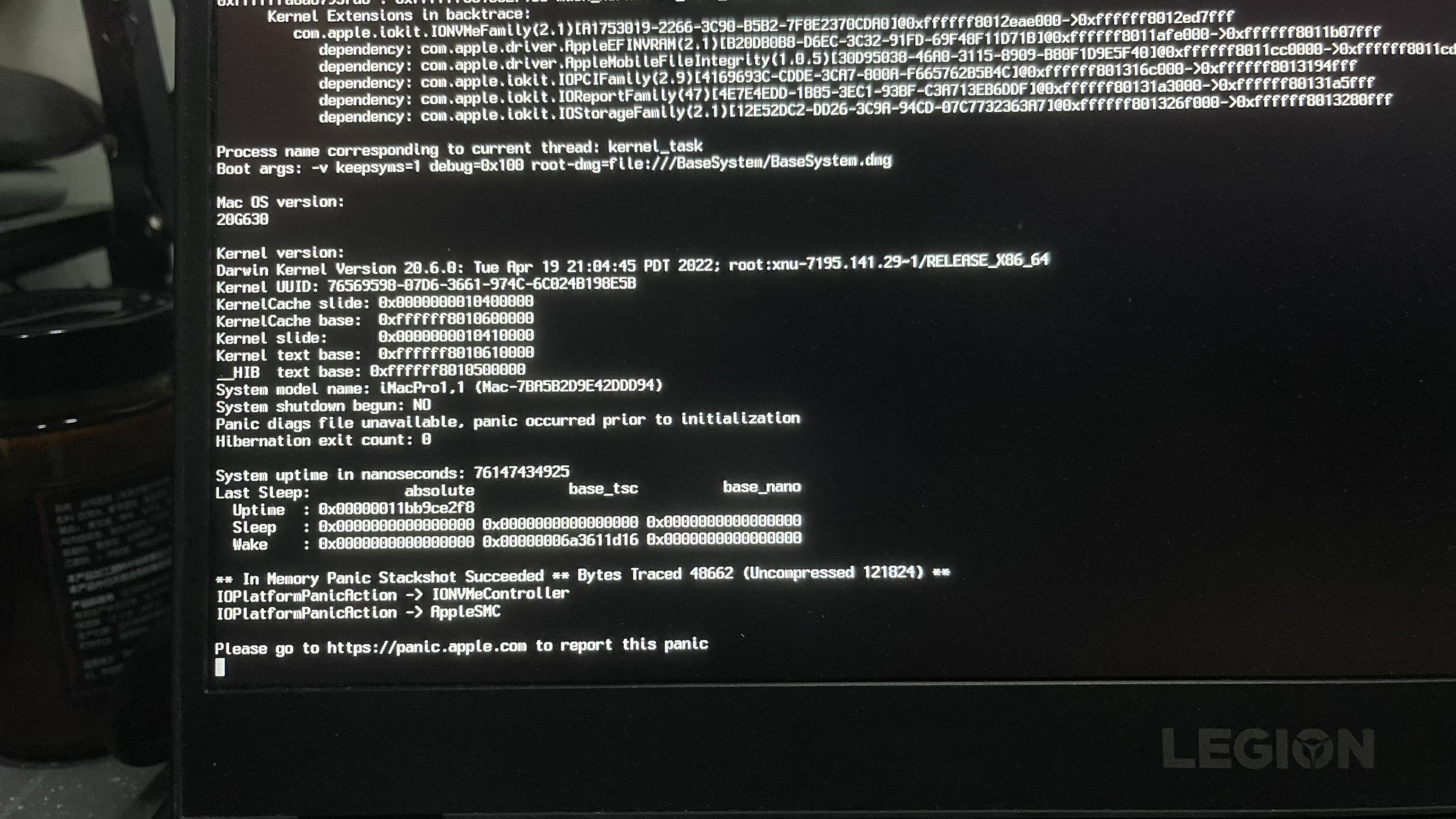

After using your EFI, it is still stuck here, installed version 11.6.7, this problem has not been solved for several days.

Hmm, make sure to RESET NVRAM when loading off this EFI, even if it hangs there, keep trying, it will eventually go past that. Make sure NVMEFIX.kext is present as well.

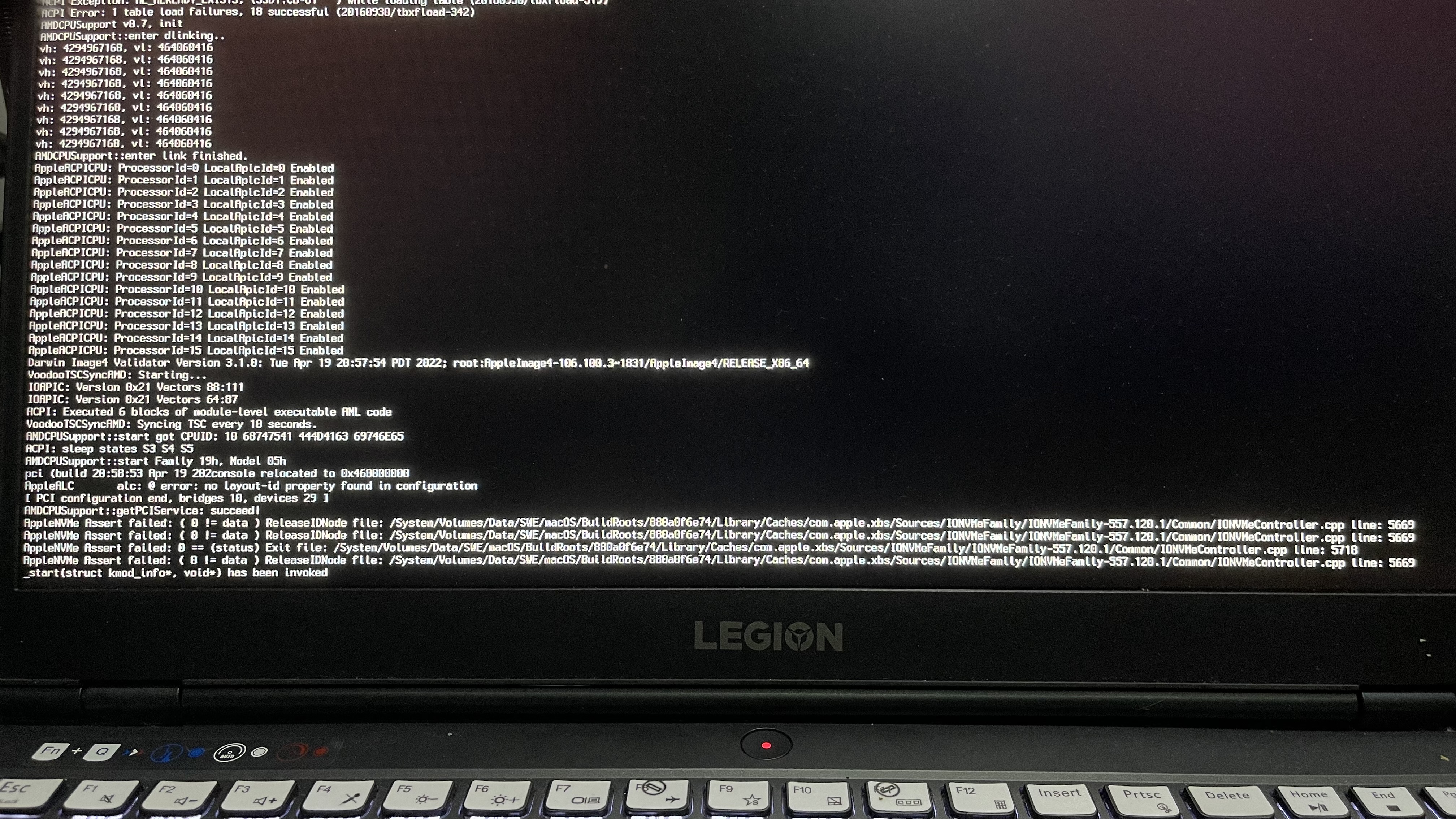

Back to trying to install an older version of Big Sur to get the XHCIPortlimit (or whatever its called)... When I try to boot the installer we made the other week with the older version of Big Sur, it forever loops with this error... (It does boot into the latest Big Sur, with USB support, no GPU support tho of course.)
Sorry, I have tried for more than 30 times, but these two interfaces are still not entered into the system, I do not know the reason, BIOS closed AMD-V, PSP and security boot, please kindly advise again, thank you

The problem is solved. The hard drive is incompatible. I found the Type-C interface to work, I could expand the second screen and connect it to my iPhone, and maybe just use an OTG cable to solve the USB illiteracy problem

Yes, most of us had to replace the oem Samsung ssds to get it to work.
