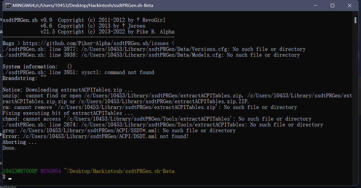

Well, there is a problem, I'm not install rignt now. So, I run ssdtPRGen on my windows. And then........
I can't get any useful information. It will report couldn't find such file or directory.
( I use Git Bash to run this shell script )
Okay. Well you could use SSDTTime to generate your DSDT, then use GenSMBIOS or SSDTPRGen to create the serials.

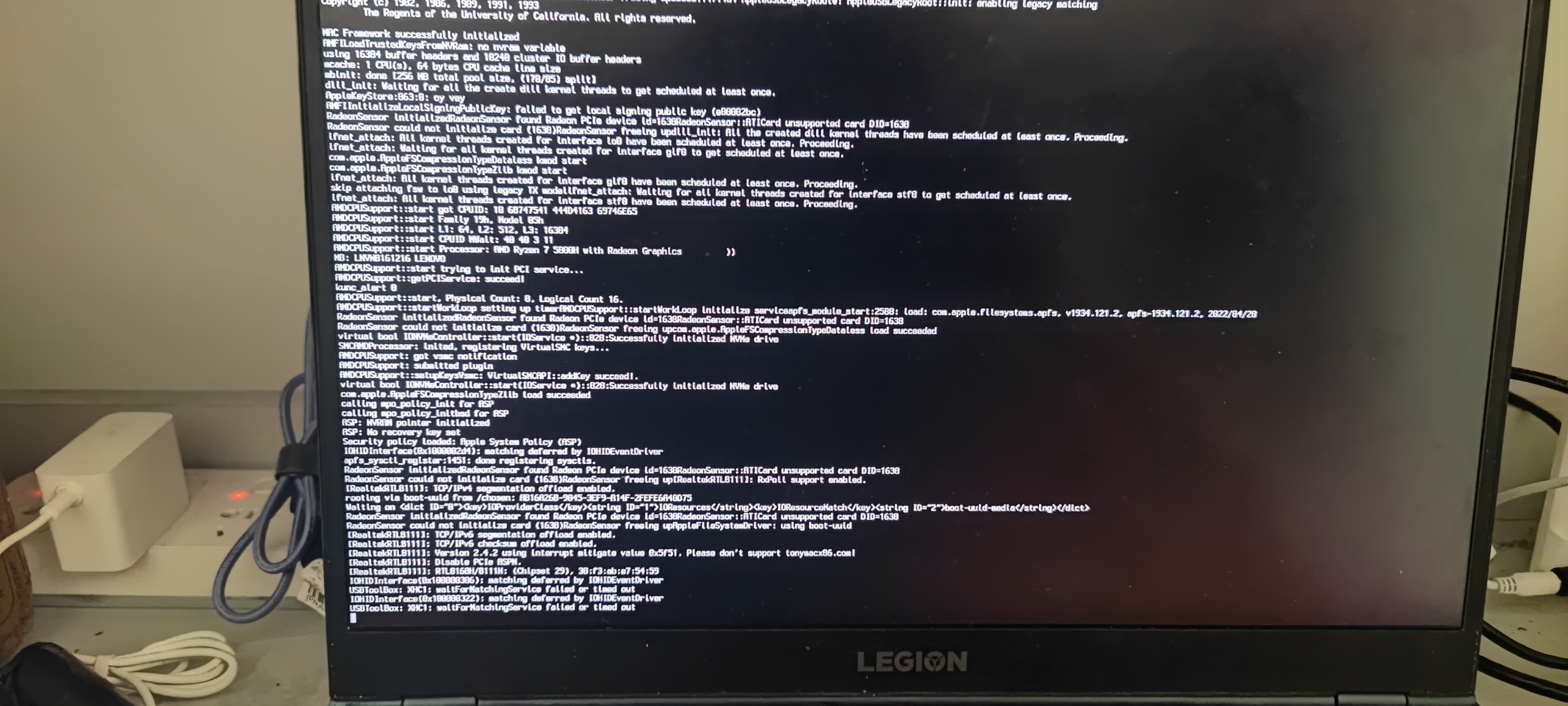

When I try to Setup, an error occurred........
Startup process will stop here
and then.......
I searched this sitution on Google, some blog write this error occurred because USB driver lost. Then I try to refresh UTBMap.kext,but it still didn't work.......
and then.......
Okay. Did you also install USBToolbox.kext along with UTBMap.kext? USBToolbox should be loaded first after UTBMap and after the first 4 main OC kexts - Lilu/WhateverGreen/AppleALC/VirtualSMC. Do not forget to disable USBInjectAll and to make sure to disable XHCIPortLimit in the. SSDT-EC & SSDT-USBX must also be enabled and also the SSDT-LEGION5-XHC0-TO-XHC.aml and GenericUSBXHCI.kext.

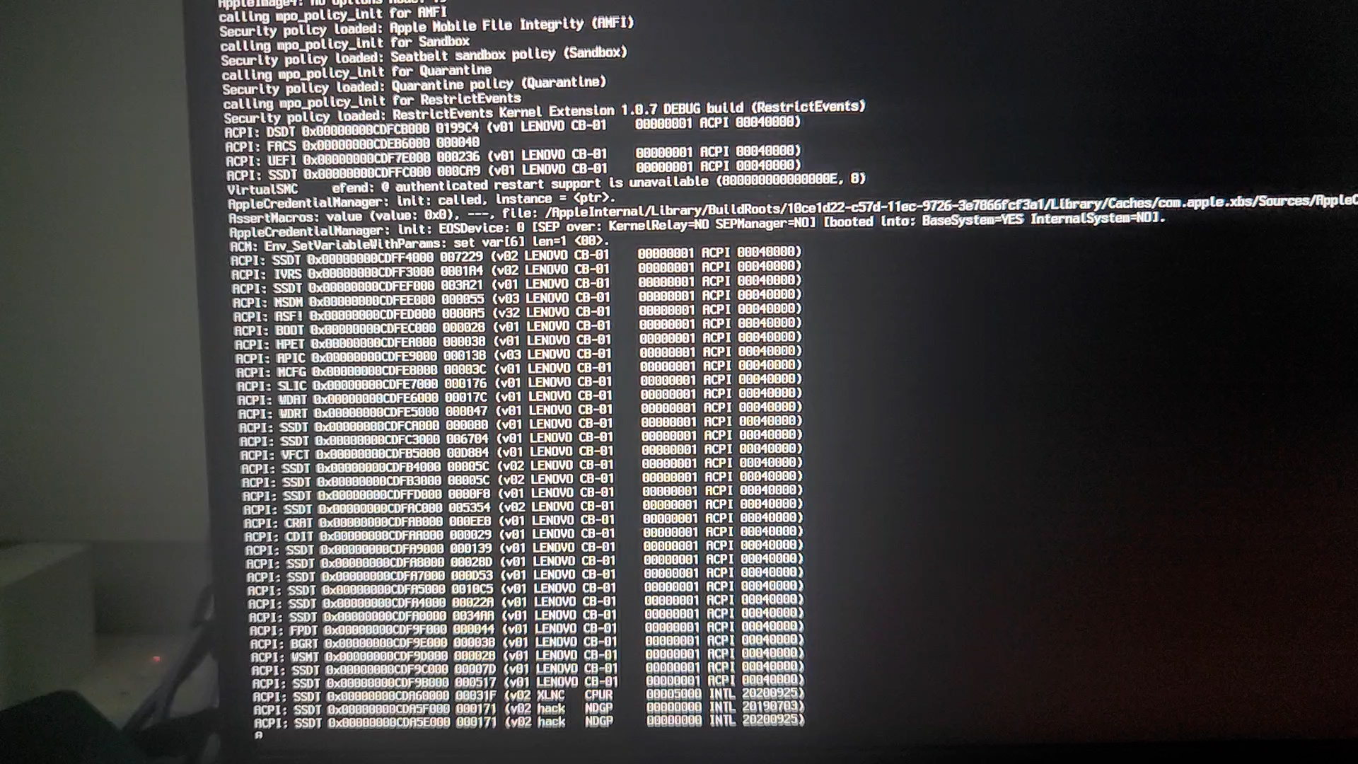

I‘ve tryed this EFI file,the first time, it stopped at In Memory Panic Stackshot Succeed. When I want to try it again, there is no panic, but my computer reboot automaticly.......
No it’s his latest one, not the first one.

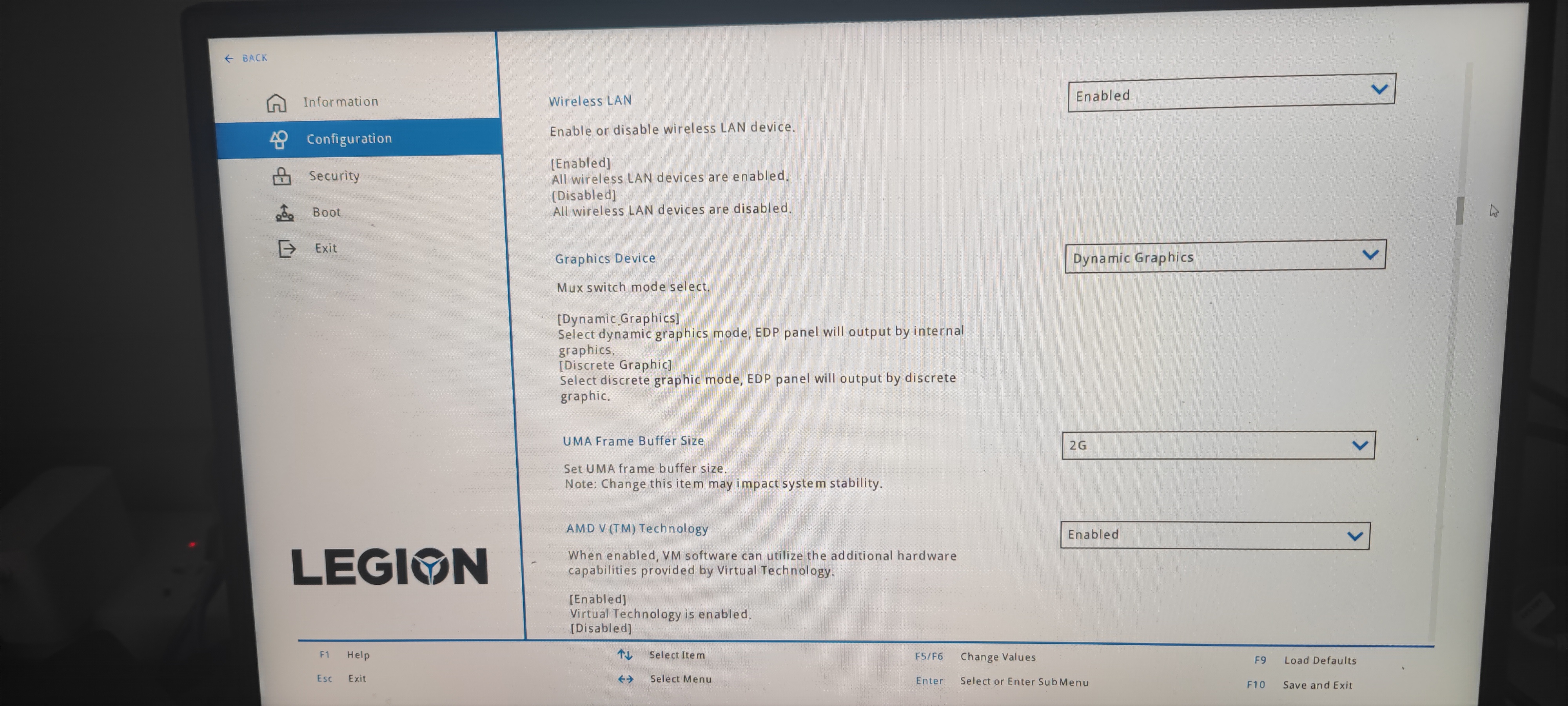

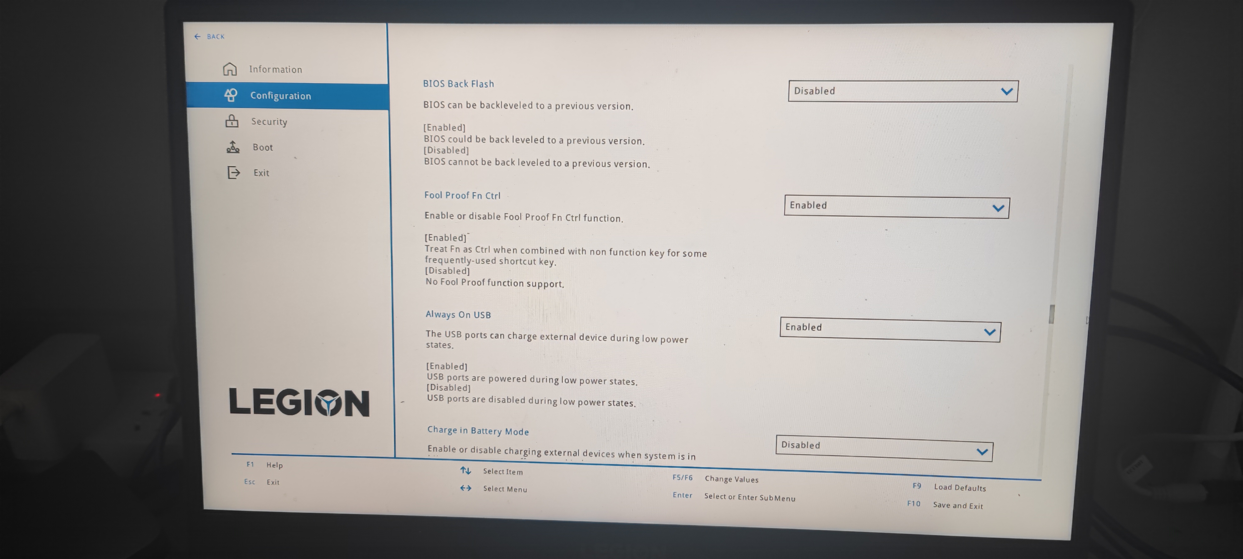

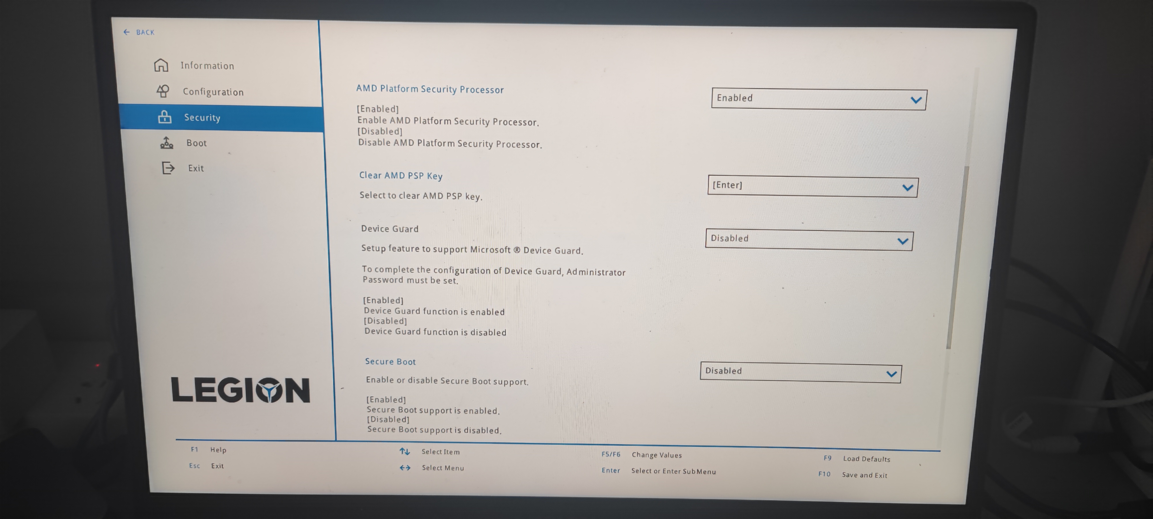

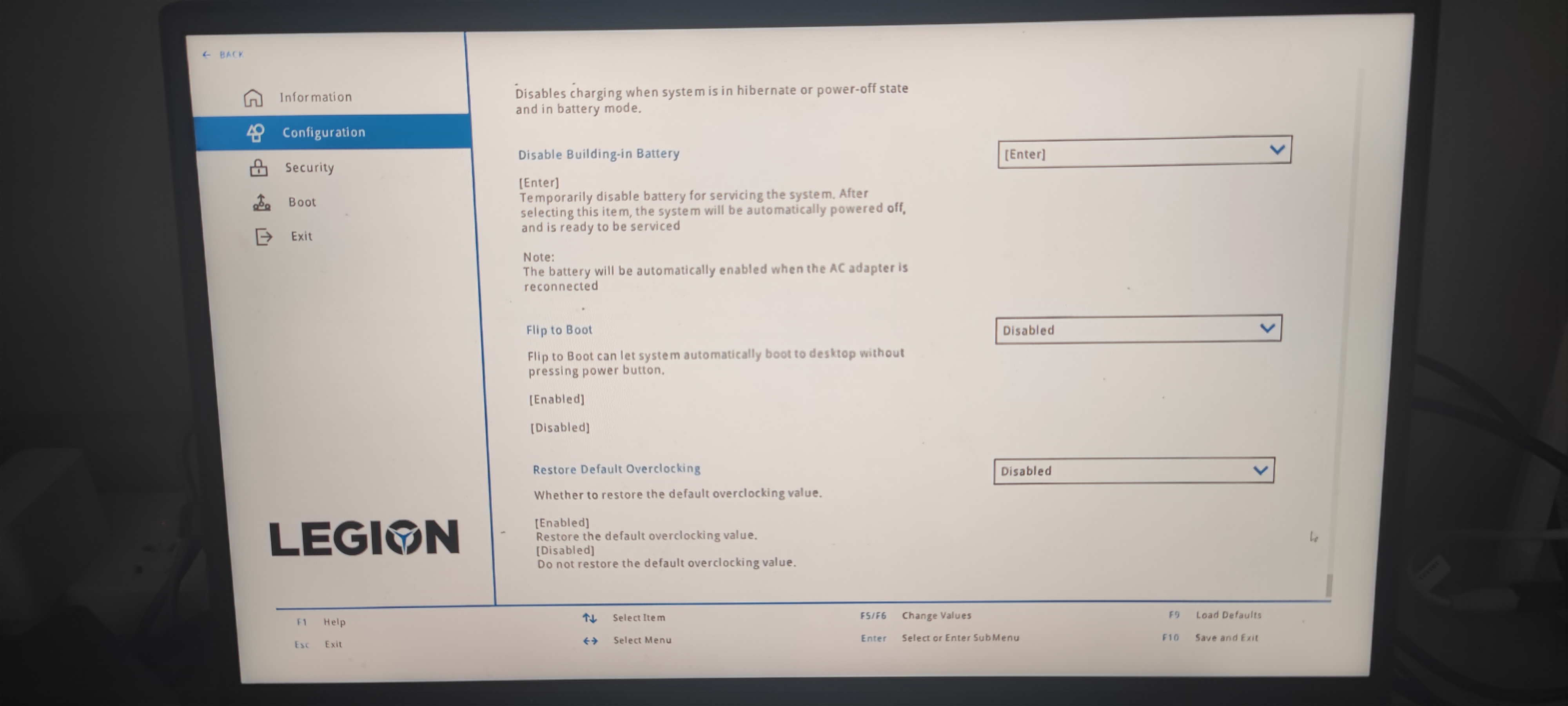

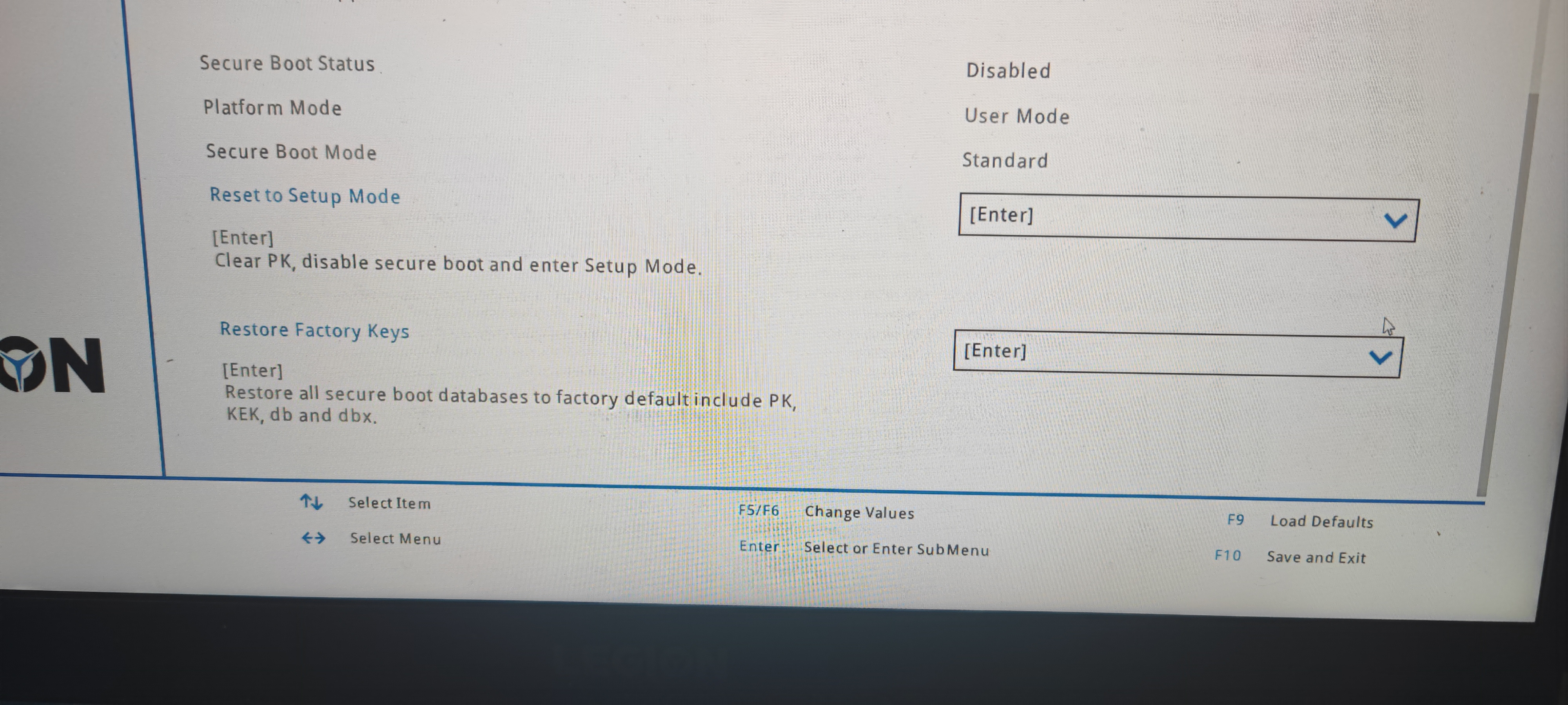

Maybe, there are some different in my BIOS setting.......
I can't find AHCI Mode setting option
CSM Switch
Above 4G Decoding Switch
SVM Switch
Serial Port Switch......
Did you install Monterey or BigSur? Try using this EFI, installing Monterey may require cpus=1
Unfortunately his system is different to yours - he has a Nvidia RTX card on the system which needs a SSDT-DDGPU or SSDT-Disabler installed.

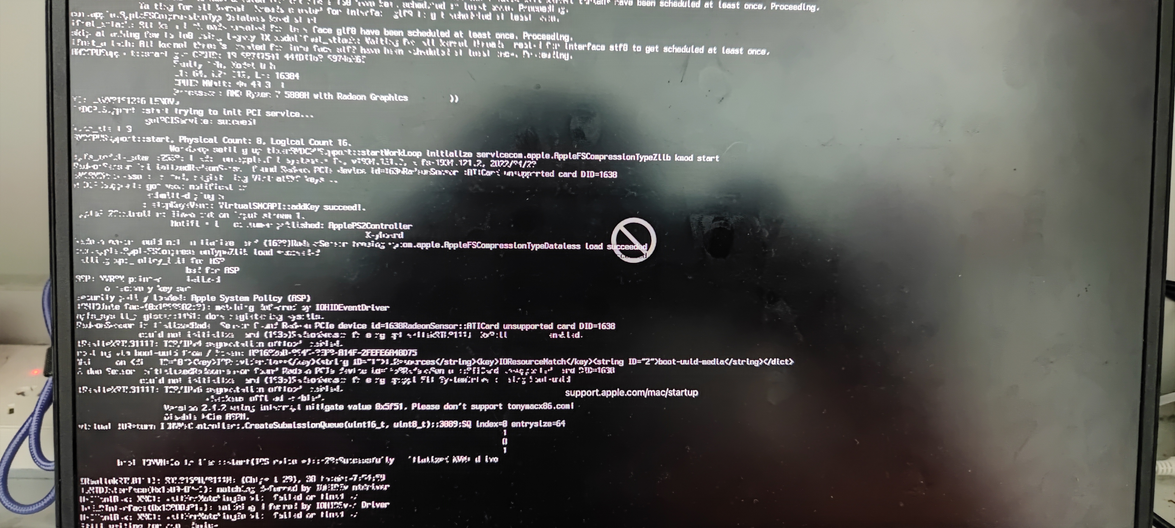

And, when I try to going into install interface, it will REBOOT automatically after this command
You might need to disable your WiFi and Bluetooth drivers to get past the installation screen.
CSM Switch
SVM Switch

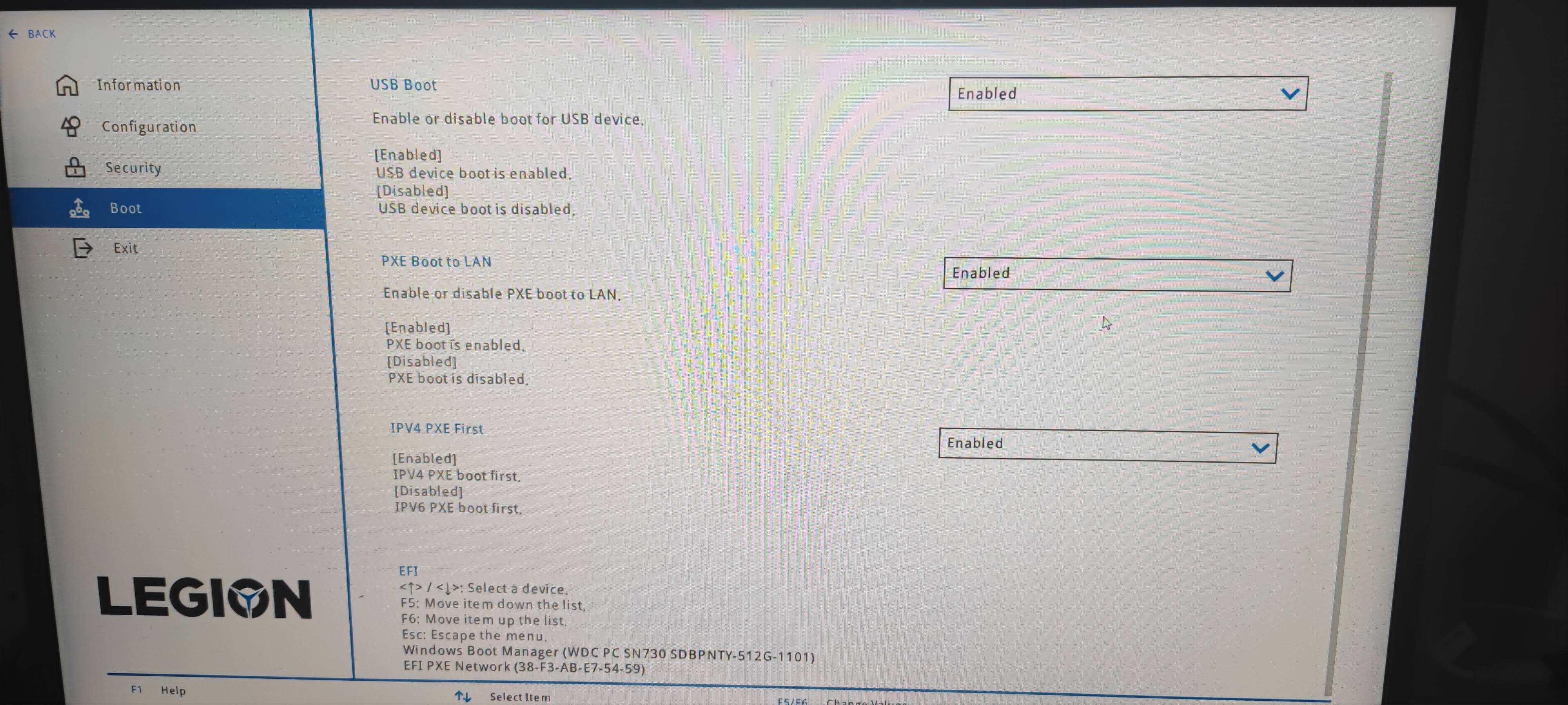

Ok @lyx,
1) AHCI is the hard drive interface. It would normally come under Peripherals or PCI Configuration.
2) It looks like your Virtual Machine settings have already been enabled under AMD V Technology.
3) AMD Platform Technology may need to be disabled (that's their version of TPM I believe).
You'll need to disable PXE Boot to LAN however - that's to boot the system via a network so is not required.

@lyx your graphics options are set incorrectly for running macOS. You need to change the graphics from 'Dynamic Graphics' to 'Discrete Graphics'
IMG_20220624_180949.jpg Dynamic Graphics selected, which would use the AMD Integrated GPU to drive the display.
You need to set the RX6600m discrete graphics to drive the display.
Reactions: OG Nerd
View attachment 6318 Dynamic Graphics selected, which would use the AMD Integrated GPU to drive the display.
@Edhawk - @lyx's system is different to the others. Despite being a Legion 5 he doesn't have a RX6600M fitted, he has Nvidia RTX card instead.
That's why he has to turn off the Discrete graphics and use the Dynamic one instead. On his system I am working on a build similar to my VCS
which allows for booting via the AMD APU. He has a Vega 3 card so it should work.
