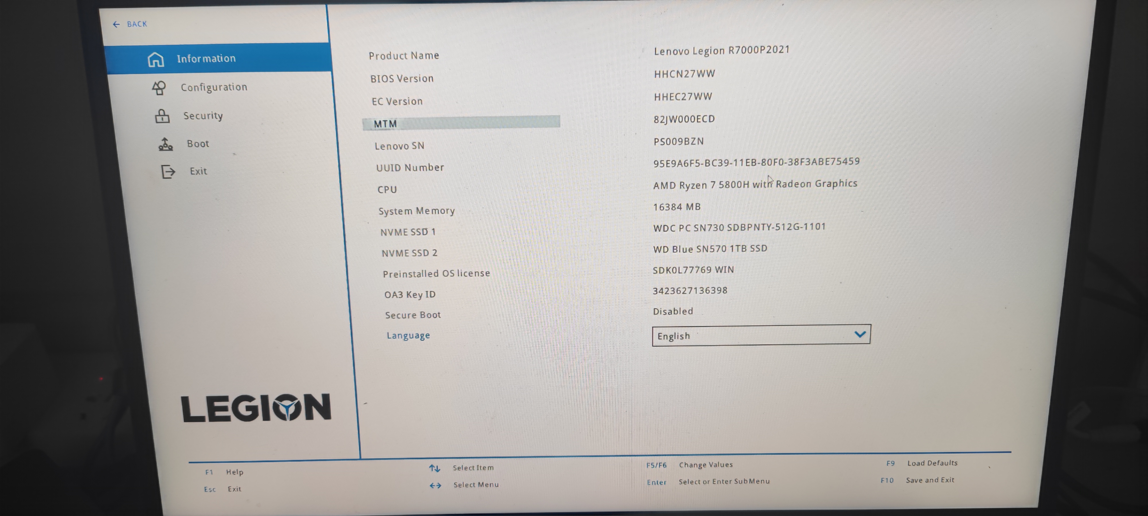

Brand: Lenovo
Model: Legion 5 6th Gen
CPU: AMD Ryzen 7 5800h
Ram: x2 8GB 3200mhz ddr4
Display: 15.6 1080p 165HZ

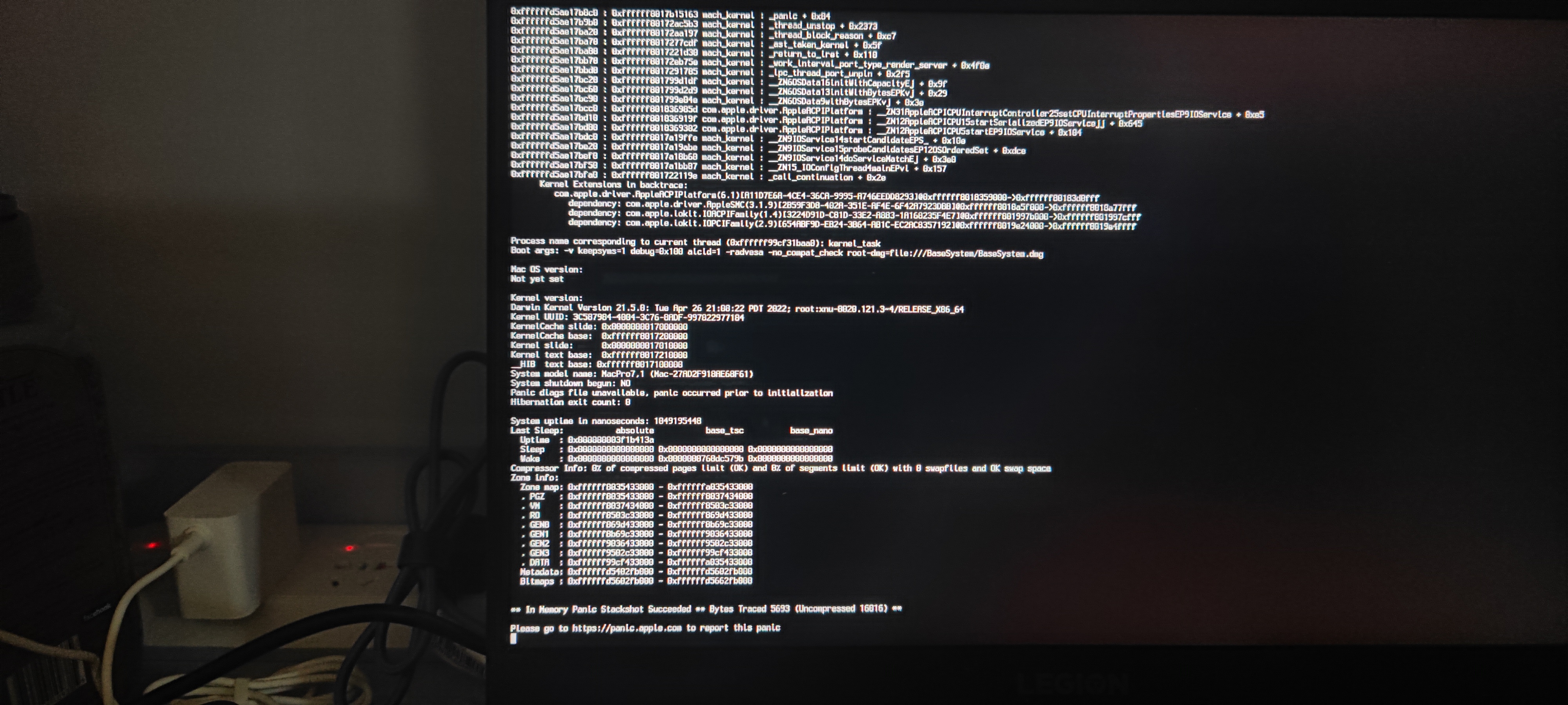

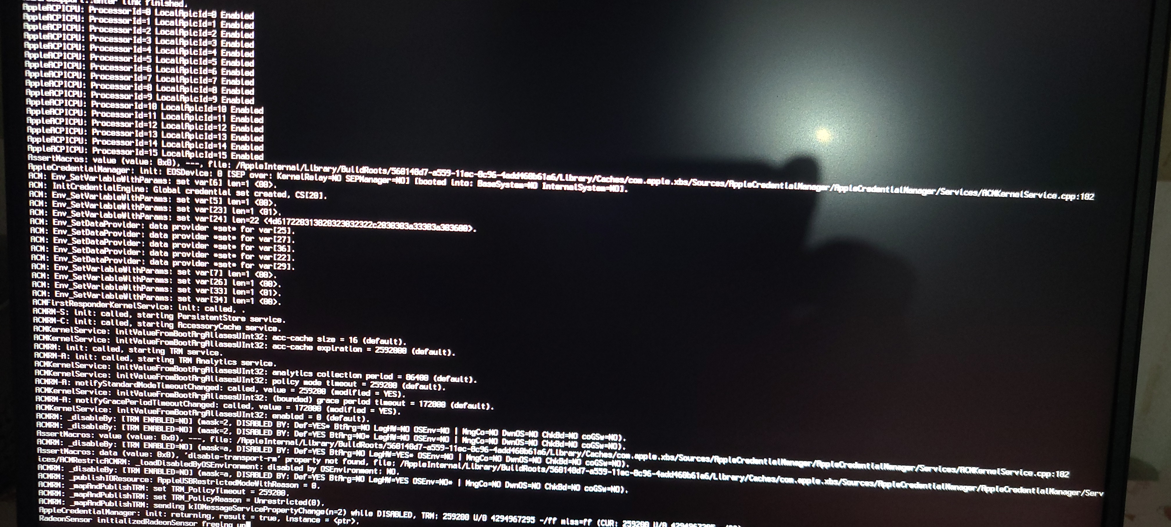

Panic from Monterey 12.6
OG Nerd
Dec 7, 2021
284
Yes for now unfortunately. If you can boot up with 8 cores, that is as good as it gets.

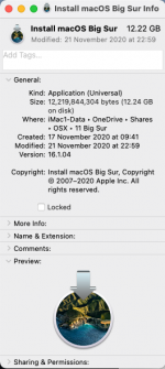

If possible I would recommend installing Big Sur 11.1 or earlier, so the Kernel >Quirk > XhciPortLimit entry can be enabled in the config.plist to enable all of the USB ports, without having to use the truncated kext you are currently using.
I don't think Apple are offering downloads for early versions of macOS Big Sur. Corpnewt's GibmacOS doesn't go back as far as 11.3 or earlier, which you would need for the XhciPortLimit quirk to work.
I can share a copy of Big Sur, provide a link via PM to download the OS from my OneDrive shared folder. Copy of Big Sur as shown in the screenshot below.
Screenshot 2022-06-25 at 00.17.26.png 'Get Info' details for the early Big Sur release I have stored on my OneDrive share.

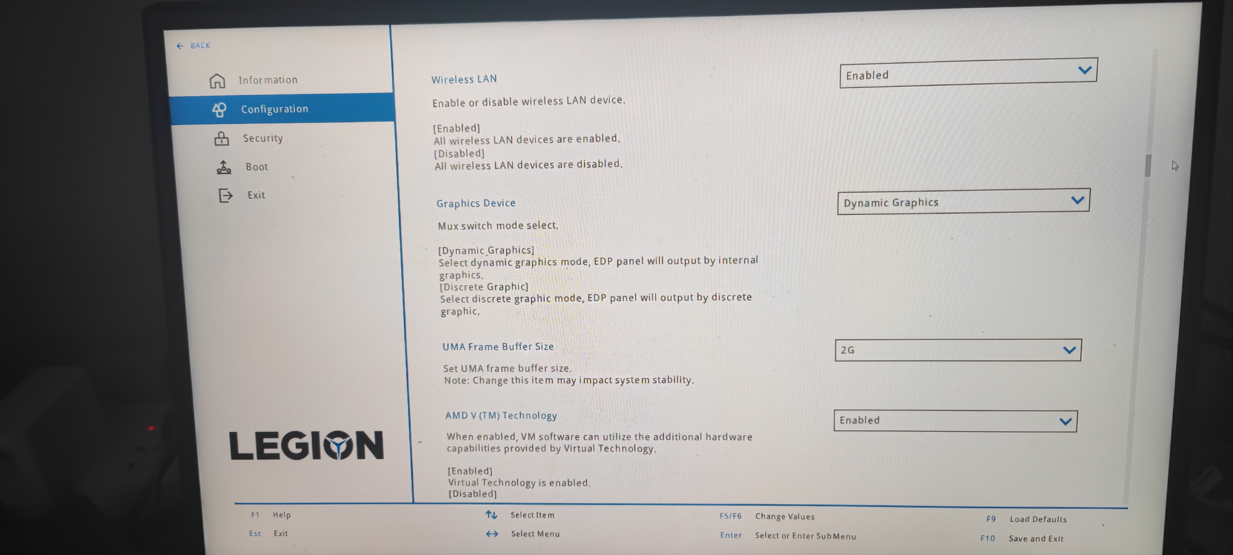

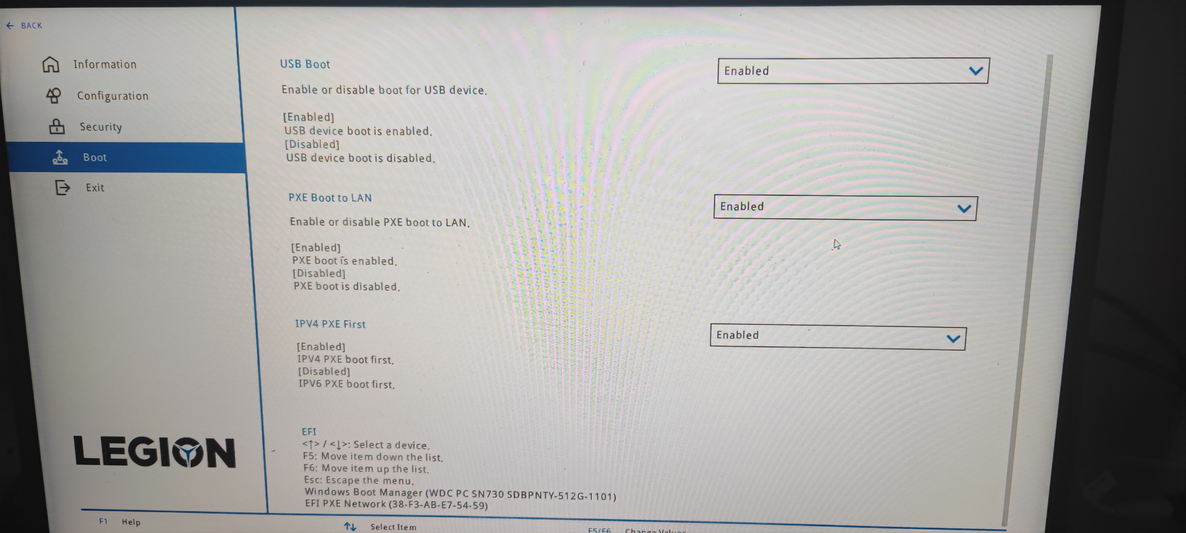

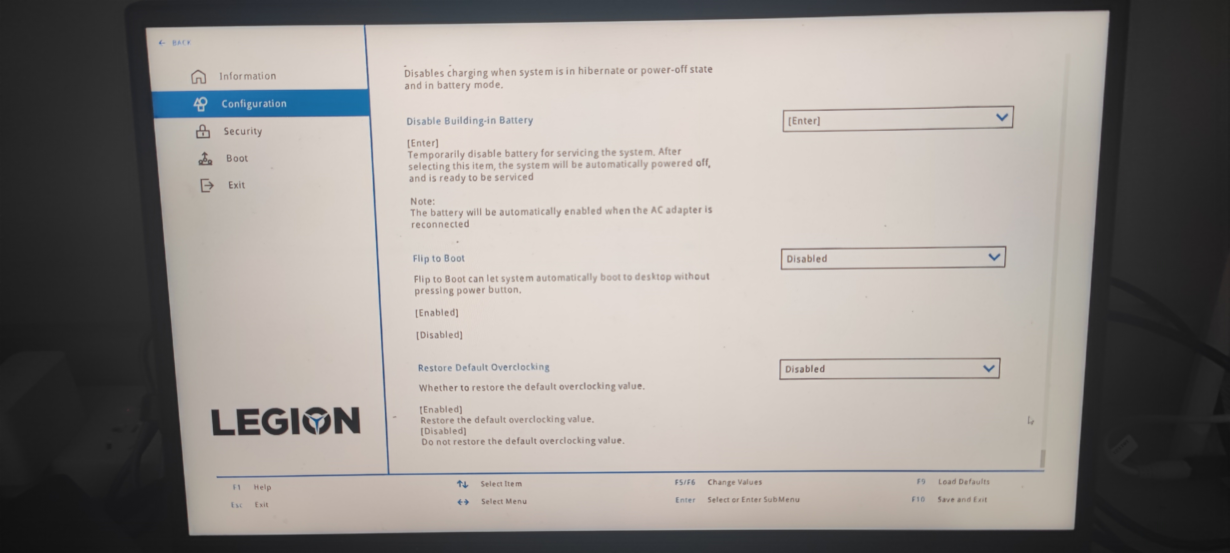

Maybe, there are some different in my BIOS setting.......
I can't find AHCI Mode setting option
CSM Switch
Above 4G Decoding Switch
SVM Switch
Serial Port Switch......

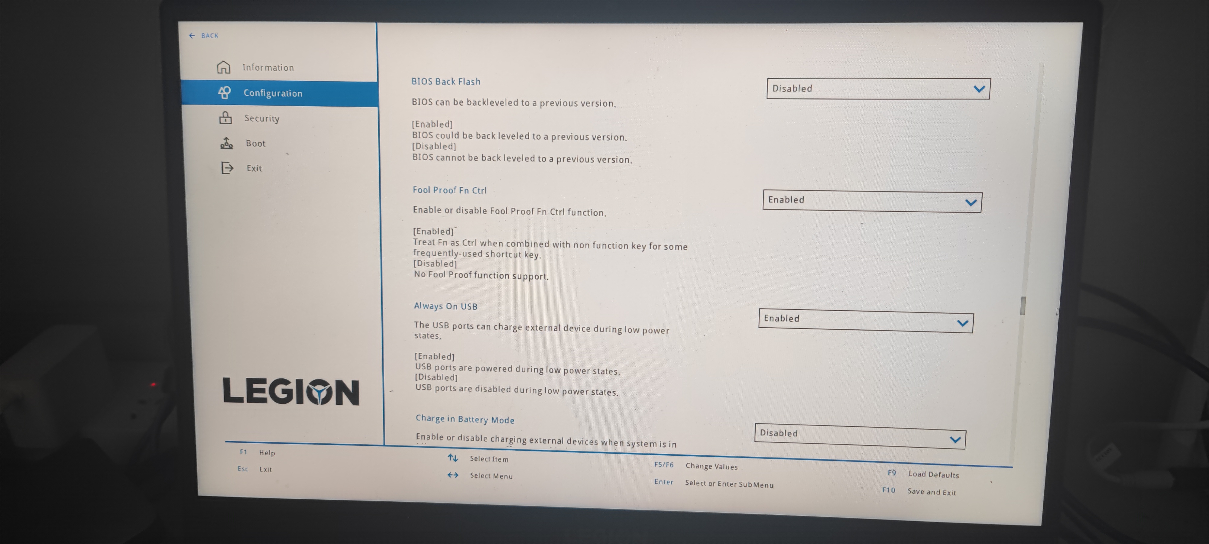

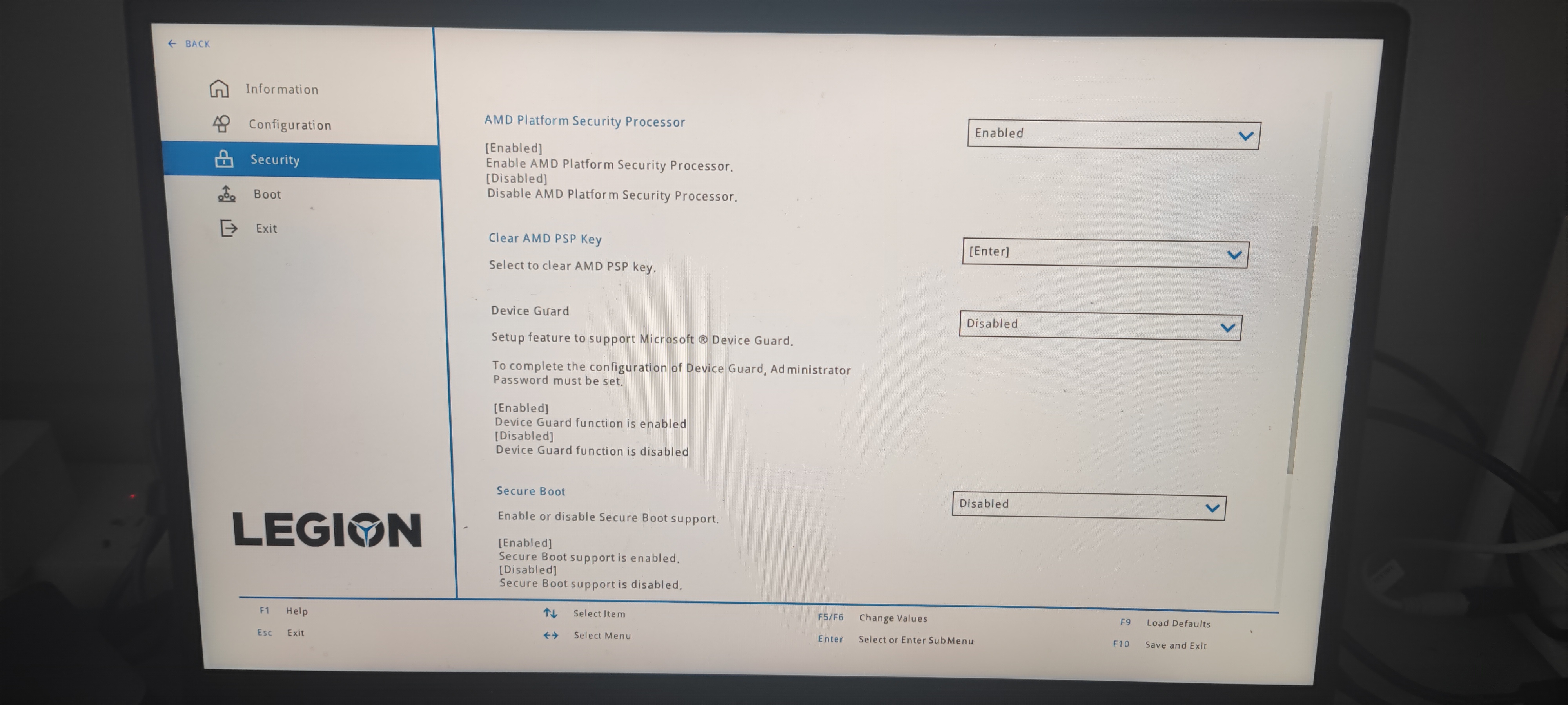

On my legion I had to do the following;
Graphics Mux: Discrete
AMD V: Disabled
Always On USB: Disabled
AMD Platform Security: Disabled

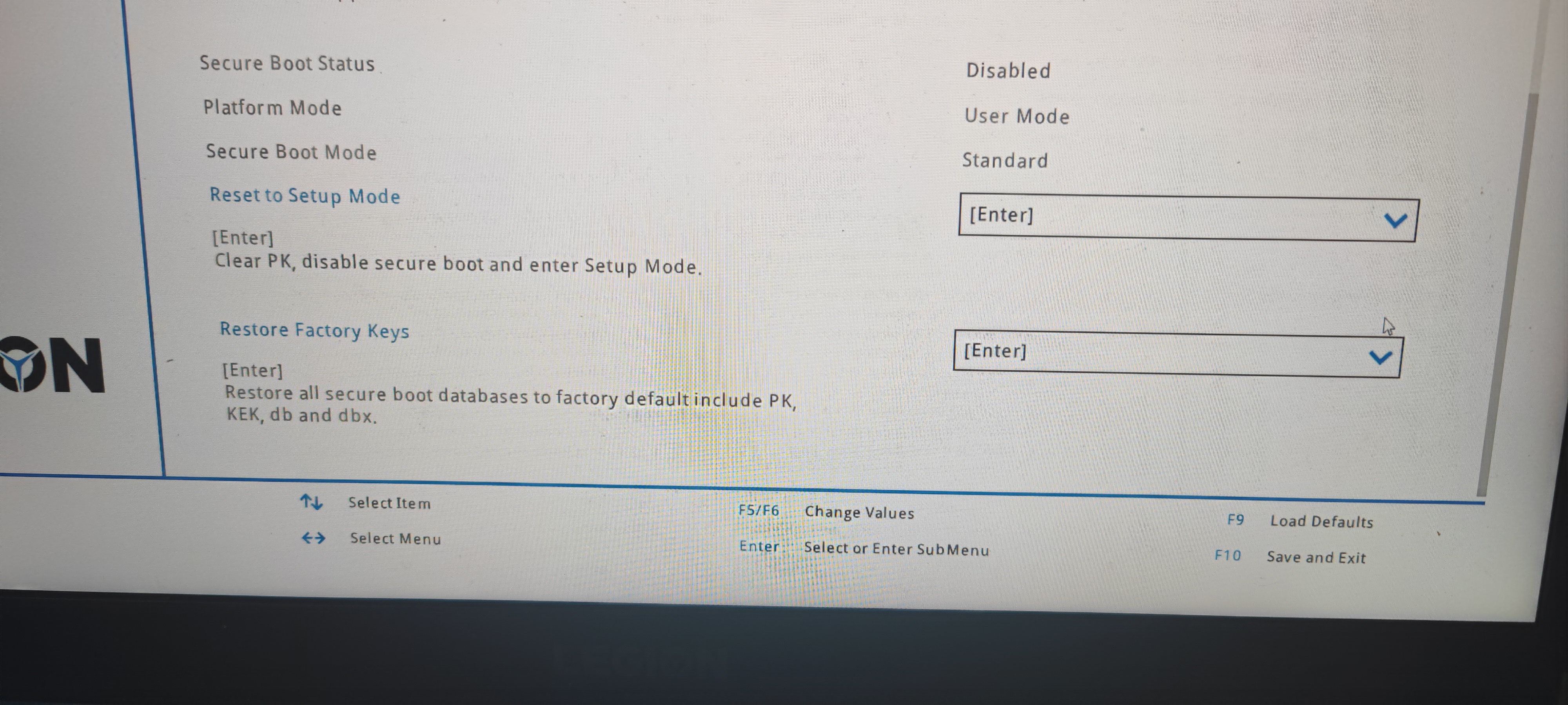

Secure Boot: Disabled
@lyx have you made sure your gpu is set to Dynamic?
@lyx,
I also noticed you seemed to have radvesa activated? You need to delete that from the NVRAM boot-arg.
AMD V: Disabled
No he can't use Discrete mode because he has Nvidia RTX 30 card, not RX6600M.

As for the Monterey Kp on AMD I have actually resolved that already. My latest build for the VCS with dual core Ryzen APU can boot Monterey 12.4. no problem.
However the settings used are very specific. AppleMCEReporterDisabler and NVMeFix must be used.

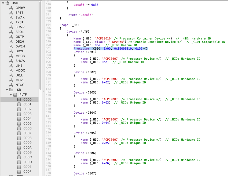

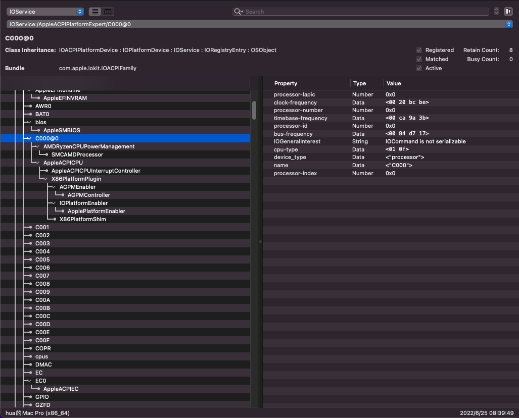

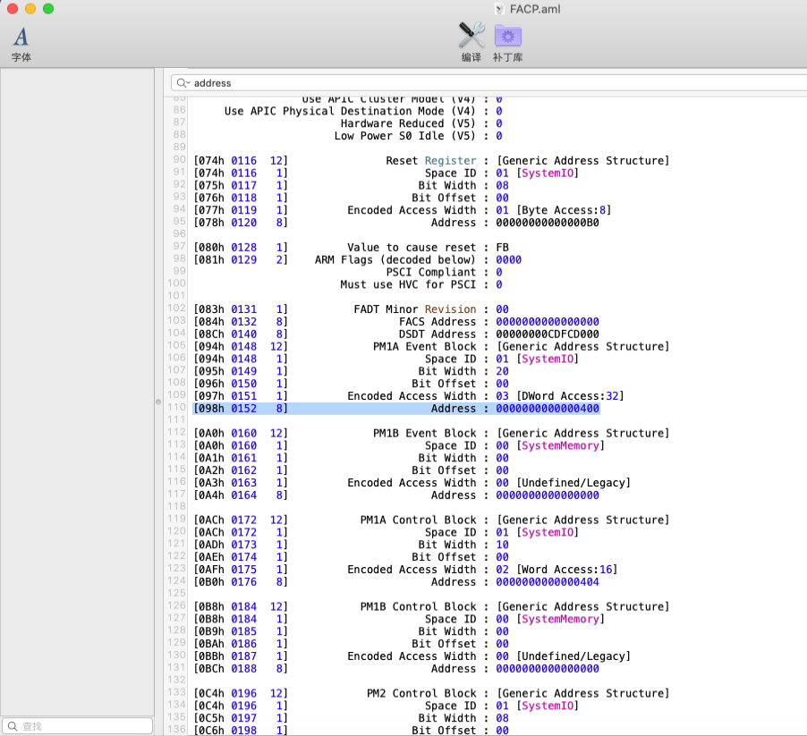

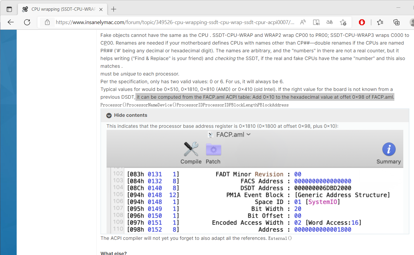

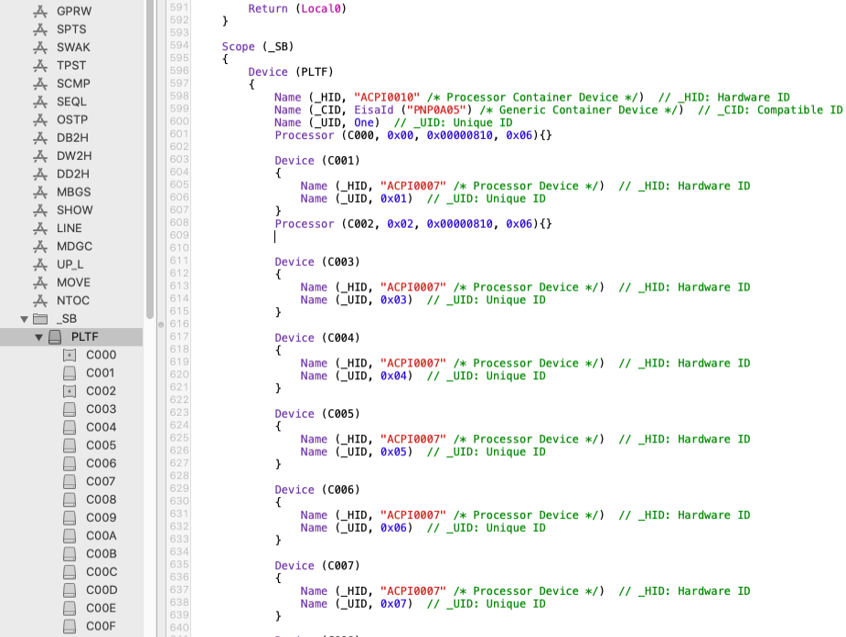

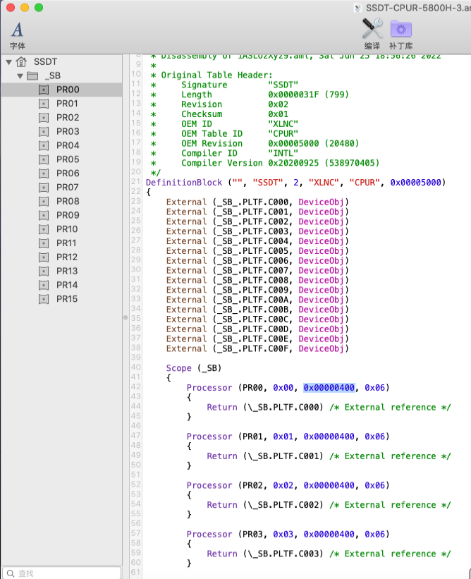

I have tried Middleman's SSDT-CPUR and Shaneee's CPU patch, but nothing worked. I did some tests, writing the CPU definition in DSDT, changing only one core, and got the following results
The number of CPU cores is 0x00,0x01,0x02, and 0x03. As soon as 0x01 is loaded, there will be a kernel panic. I define the CPU core in DSDT to skip 0x01 and get the following result: no kernel panic. You can see that AppleACPICPU: is recognized, but the system will not load
@zxc2689963 you should be using this latest one. The one you have points to the wrong registers >
  • SSDT-CPUR-5800H-3.aml.zip

I have looked at the DSDT.aml tables provided by users from post #1, 14 and another later post.
I have inspected the DSDT.aml and other SSDT's provided and come up with what I hope are a few helpful solutions.
There are a few notable items that appear in the DSDT.aml table.
  1. Graphics card is named VGA, not GFX0, - so WhateverGreen.kext would never match with the VGA device.
  2. Processor is named C000 - C00F inclusive, not PR01 etc.

    1. SSDT-CPUR-5800H-3.aml [provided by @Middleman) as this uses the correct naming convention for your CPU processor entries

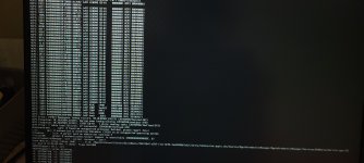

Post a photo of the Verbose text if it kernel panics.

You need to use the ResetNvramEntry.efi tool (press SpaceBar to display tools) before trying to boot with this EFI. So as to clear any existing Nvram settings, otherwise your system may not work with this EFI.
Thank you, I tried, loading as shown in the picture, black screen restart
zxc2689963
Feb 27, 2022
135
I checked SSDT-CPUR and found that some parameters are wrong, 0x00000400+0x10, the correct one is 0x00000410
  • SSDT-CPUR-5800H.zip
