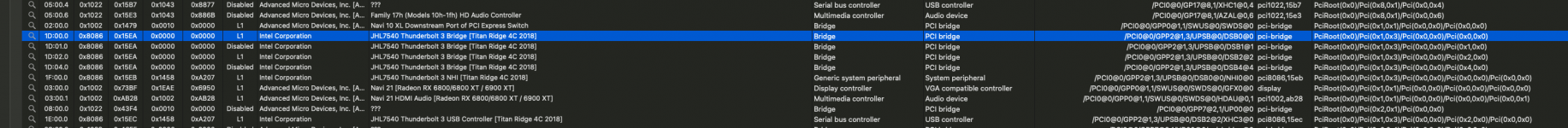

This is how far i get now, see attachements.
Still something funky here.
I can see the card randomly after som reboots.
I use the same SSDTs you sent over here for @@rexxver, since we have the same motherboard.
Also i made my own jumper, i can see the card so i dont know if its working 100% or not :D

Some observations:
  • Link Status on both ports is showing an error code
  • Current Link Width is empty
  • Link Controller Firmware Version is entirely missing
These problems may be due to a problem with the firmware or the flashing process. I would suggest re-flashing the card. Might be good to try NVM 33 first and then NVM 50.
