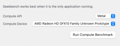

Lorys89
Dec 16, 2022
183
Rx6650xt view with spoof only
Rx6650xt with spoof and other modification
