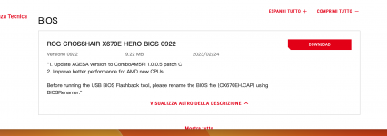

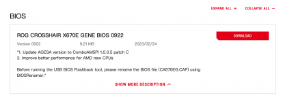

updated without problem

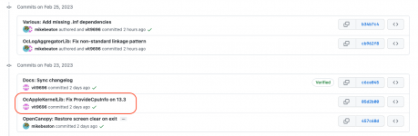

Although I'm not a video game player (haven't played one in 15+ years), I've seen a number of YouTube reviews on the subject. If you're "not at pro level" and playing at 1440p then Ryzen 5 7600X is a very good choice along with AMD Radeon RX 6650 XT.
Incidentally, the modified kernel in Ventura 13.3 broke not only AMD Ryzen, but also Intel processors with mixed cores (P-cores, E-cores). However, vit9696 recently updated the ProvideCurrentCpuInfo quirk, which means 13.3 can finally be installed on Intel systems with both P-cores and E-cores enabled. This fix will be included in OpenCore 0.9.0, but an interim build is available on Dortania.
On the Ryzen side, I wonder how the effort is progressing?
