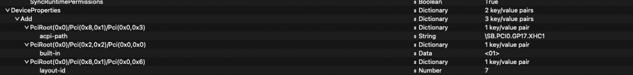

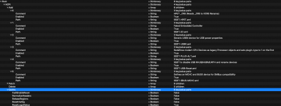

the PCI Devices are correct ? Or have to Delete the 1st with acpi-path ?
maybe i need remap my USB again or something is wrong.
your APCI settings also replace with my settings.
patches_OC.plist into my info info.plist
By the way i still need the USBTool Kext + Mapping ?

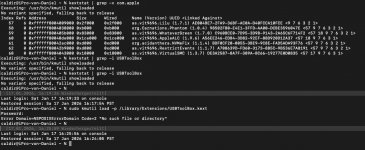

Found out some kexts not loading anymore USBTool and UTB dont know whats happen right know.
Your config put into my config.plist and replace after snapshot.

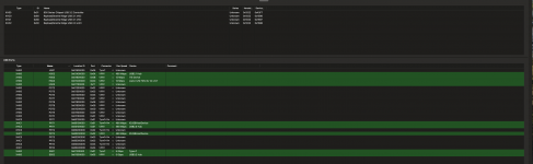

there is my USB Mapping in windows seems good
the 2 red beside the ethernet also dont work.
but the blue ports with usb work ... they are all on the same controller
This USB Mapping is so painful ^^

I would make the following points:
Ports 11, 12 & 17 under the first USB Controller appear to be ‘Internal’ devices, either directly connected to the motherboard or via a USB header. So these ports should be set as ‘Internal’ with connector type (255). I am not positive about the two LianLi fans but the ITE device is definitely an internal device.
You don’t have a Bluetooth device showing, is that correct for your system?
Pay attention to the screen showing the Companion ports, as these are helpful when looking to correct and/or matching port types.
The two Red ports you can’t see may be attached to a USB 3.2 & 2.0 hub, which would mean they don’t show as individual ports. But the same port, such as port #5 & 10 under the first USB controller might keep being highlighted when a USB drive is inserted.
Reactions: Caldir

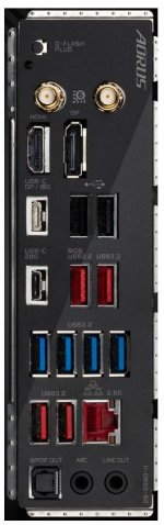

Red Ports Behind beside Ethenet, Blue Ports behind
the Blue Ports Behind work. Testet

Your motherboard only contains 2 x physical USB2 ports (both on the rear I/O plate with Black Tang). These are the only ports that should be set as USB2 (0) in your USB configuration. So you have way too many ports set incorrectly, even if they haven't yet been included in the port discovery.

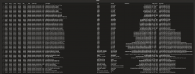

hmm 2 Controller dont seem to work, thats maybe the reason why my front USB never worked :D

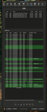

The USB discovery from post #27 looks a lot better and more complete than the one above. Especially with the companion ports highlighted.

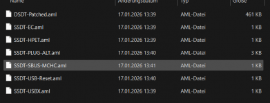

your DSDT is Complet i saw other X670e
the DSDT Patched Should load ?
i will try this weekend :D
i saw some other Asus EFIs what a lot more DSDTs ...
