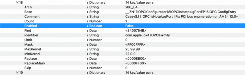

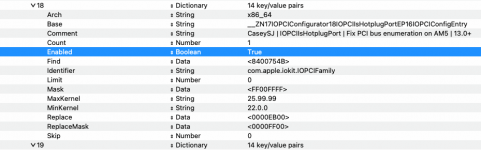

I would recommend you enable AMD Kernel Patch #18, which is aimed at fixing PCI bus issues on AM5 systems, like your B650M board. Enabling this patch might help with the issues you are facing.
Screenshot 2025-12-13 at 16.03.15.png current setting for patch #18
Screenshot 2025-12-13 at 16.03.00.png revised setting for patch #18

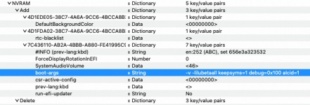

You don't need to use -lilubetaall boot argument in your config.plist, as Tahoe is no longer deemed a Beta release.
Screenshot 2025-12-13 at 16.09.30.png Boot Args, remove those not required
