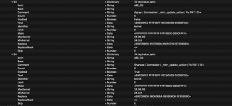

Those 2 are connected to gpu as I was told. I checked my config and validator didn't report them.
In attach you can see how those 2 look at my config.plist.
fabiosun
Oct 9, 2022
635
Thise errors are about ethernet patches
You can live with them
