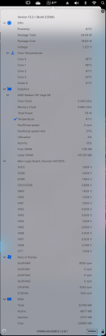

I use HWMonitorSMC2 on most if not all of my systems, to keep an eye on my system temps etc. It is free and can be downloaded from the link below. It works with VirtualSMC.kext.
This is a screenshot of the HWMonitorSMC2 app loaded from the Menu bar.
Screenshot 2023-03-01 at 23.25.12.png I have set my Radeon Vega 56 temp to show on the menu bar, next to the app icon. So it is easy to monitor the GPU temp.
The fans on my card don't kick in till the temp is around 53°C and then not at full speed.
There are additional Extension Sensor kexts available, which I have attached below. Just be careful which kexts you add to your system. You will probably only require the RadeonMonitor.kext with your system.
You may already be using the VirtualSMC sensors, SMCAMDProcessor.kext along with the AMD Power Gadget app and that may be all you need.
