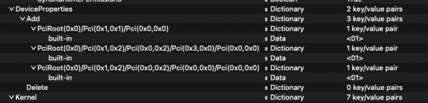

the only other thing i'm not sure about is removing the reference to Moozuki's wifi card, I couldn't see this in the config.plist?
Have you added the ROM as well? This is needed if you are to get Messages, iCloud etc. working.
You are not wrong about not being able to tell which DeviceProperties entry relates to the WiFi card.
Not without a bit of help from Moozuki.
Or being able to boot macOS on the system, and then using Hackintool or a similar app to see which Device your system doesn't use/contain.

Re the device ID for the WiFi card.. thanks for confirming it's not just me who can't find it! Do you think that system will run ok if I don't remove it?
Until I have the time to figure it all out, I would disable all of them. Then enable one at a time until you find the one that makes the ethernet show as internal.
There are 3 of them:
one for the ethernet,
one for the NVMe drive,
one for the WIFI/BT card.
The system should run fine without them.
If your system is booting you can use Hackintool to identify which is which.
The one for the ethernet is there so messages etc works correctly.
I need to remember to remove them before I upload my EFI, :cool: .

Ok thanks.. now for my next daft question.. how do I disable them? Is there a way to comment them out so that I don't have to delete them completely? 🤔
You will see an address like this: PciRoot(0x0)/Pci(0x1b,0x0)
Changing it like this: #PciRoot(0x0)/Pci(0x1b,0x0)
Should make it a comment that OC will ignore when booting.

You do not need those device properties for the hack to work, I just liked my internal devices to show as built in as a real Mac does.
And there is nothing saying the Pci addresses are the same on your board as they are on mine.
Ah ok.. so I can go ahead and comment them out and ethernet / WiFi / nvme should still work.. they just won't show as internal devices, but as long as they work I'm happy 👍😎
Correct, let me know how it goes.
