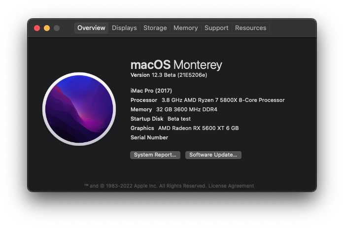

Updated to 12.3 Beta 3 today with no issues.
Attaching current EFI with serials removed.
