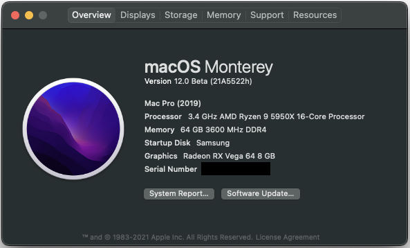

OpenCore 0.7.4 EFI Update (Monterey 12.0 Beta 8 Ready), 4th October 2021
Changes made include,
  • Lilu 1.5.6,
  • AppleALC 1.6.5,
  • WhateverGreen 1.5.4,
  • VirtualSMC 1.2.7,
  • RestrictEvents 1.0.5,
  • LucyRTL8125Ethernet 1.1.0,
  • SMCAMDProcessor 0.7,
  • New Universal AMD Patches Monterey 12.0 Compatible,
  • OpenCanopy Icons Updated,
  • OpenCore Updated to Revision 0.7.4 (Monterey Beta 8 Ready),
  • Memory Mapping is now Being done via RestrictEvents,
  • About This Mac now displays the correct AMD Processor info done via RestrictEvents,
Note 1 - If your not using a RX 6800 or any other Navi/BigNavi GPU then remove agdpmod=ignore from the boot arguments.
Note 2 - If you are using a 6 or Less Core Ryzen then go into the Config,plist and under PlatformInfo->Generic Change the ProcessorType from 0 to 1537, This will list your CPU info correctly inside About This Mac.
Note 3 - The SmallTreeIntel82576.kext is now fully working in Monterey 12.0 as of Beta 8.
IMPORTANT PATCH INFO TO SET THE CORRECT CPU FOR YOUR SYSTEM
Core Count patch needs to be modified to boot your system. Find the three algrey - Force cpuid_cores_per_package patches and alter the Replace value only.
Changing B8000000 0000/BA000000 0000/BA000000 0090* to B8 <CoreCount> 0000 0000/BA <CoreCount> 0000 0000/BA <CoreCount> 0000 0090* substituting <CoreCount> with the hexadeciamal value matching your physical core count.
CoreCountHexadecimal
6 Core06
8 Core08
12 Core0C
16 Core10
32 Core20
So for example a 6 Core 5600X Replace value would result in these replace values, B8 06 0000 0000/BA 06 0000 0000/BA 06 0000 0090
Or a 12 Core 5900X that I have it setup as standard would result in these replace values, B8 0C 0000 0000/BA 0C 0000 0000/BA 0C 0000 0090
EXAMPLE
