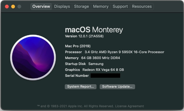

No issues upgrading to Monterey 12.0.1 (release candidate).

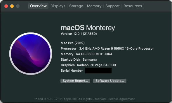

Just updated to macOS Monterey RC 2. No issues.
