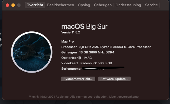

11.5.2, As always it's safe to update.

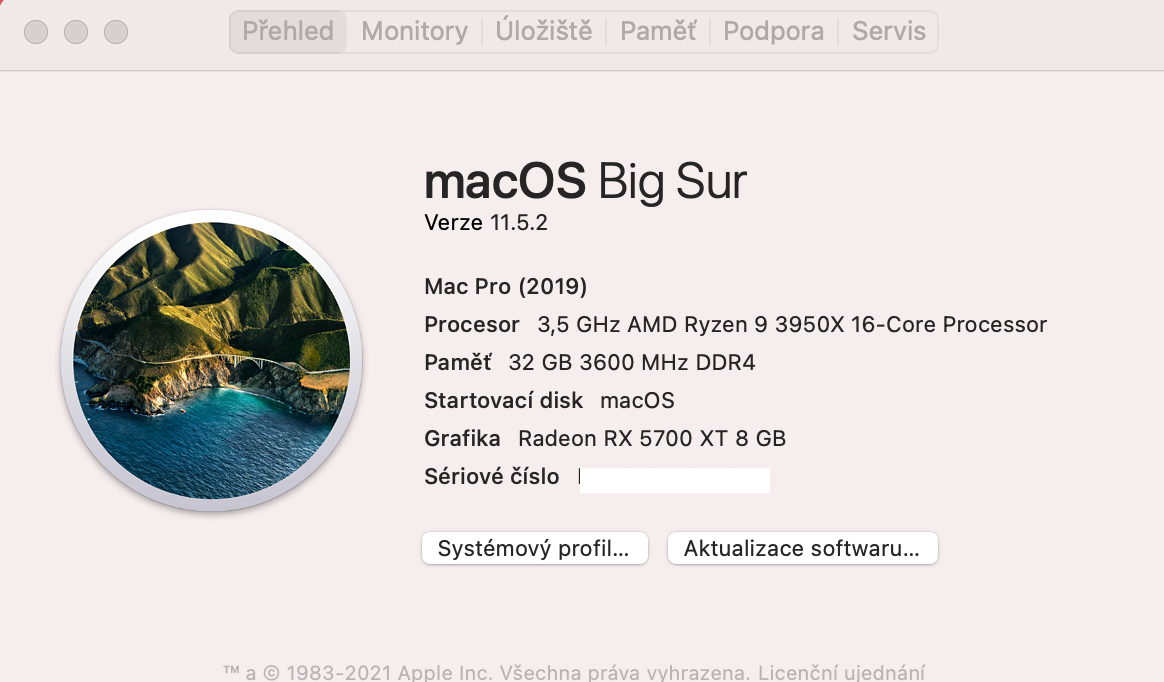

Monterey Beta 5
The new patches are working great. :)
