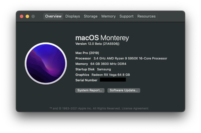

OpenCore 0.7.3 EFI Update (Monterey 12.0 Beta6 Ready), 7th September 2021
Changes made include,
  • Lilu 1.5.6,
  • AppleALC 1.6.4,
  • WhateverGreen 1.5.3,
  • VirtualSMC 1.2.7,
  • RestrictEvents 1.0.4,
  • LucyRTL8125Ethernet 1.1.0,
  • SMCAMDProcessor 0.7,
  • New Universal AMD Patches Monterey 12.0 Beta6 Compatible,
  • OpenCanopy Icons Updated,
  • OpenCore Updated to Revision 0.7.3 (Monterey Beta 6 Ready),
  • Memory Mapping is now Being done via RestrictEvents,
  • About This Mac now displays the correct AMD Processor info done via RestrictEvents,
Note 1 - If your not using a RX 6800 or any other Navi/BigNavi GPU then remove agdpmod=ignore from the boot arguments.
Note 2 - If you are using Catalina then in the Config.plist under Misc->Security Change SecureBootModel=Default to j160 or Catalina will not boot.
Note 3 - If you are using a 6 or Less Core Ryzen then go into the Config,plist and under PlatformInfo->Generic Change the ProcessorType from 0 to 1537, This will list your CPU info correctly inside About This Mac.
Note 4 - The SmallTreeIntel82576.kext is not working under Monterey 12.0.
IMPORTANT PATCH INFO TO SET THE CORRECT CPU FOR YOUR SYSTEM
Core Count patch needs to be modified to boot your system. Find the three algrey - Force cpuid_cores_per_package patches and alter the Replace value only.
Changing B8000000 0000/BA000000 0000/BA000000 0090* to B8 <CoreCount> 0000 0000/BA <CoreCount> 0000 0000/BA <CoreCount> 0000 0090* substituting <CoreCount> with the hexadeciamal value matching your physical core count.
CoreCountHexadecimal
6 Core06
8 Core08
12 Core0C
16 Core10
32 Core20
So for example a 6 Core 5600X Replace value would result in these replace values, B8 06 0000 0000/BA 06 0000 0000/BA 06 0000 0090
Or a 12 Core 5900X that I have it setup as standard would result in these replace values, B8 0C 0000 0000/BA 0C 0000 0000/BA 0C 0000 0090
12 Core EXAMPLE

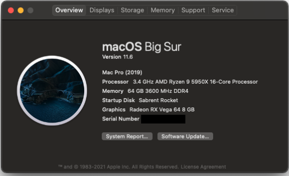

Just wanted to post that the upgrade to macOS Big Sur 11.6 went smoothly (using @AudioGod's EFI posted here). Normal update process, just click Update Now, Restart and let it do it's thing.

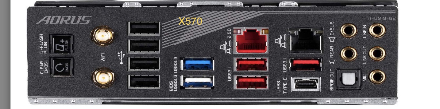

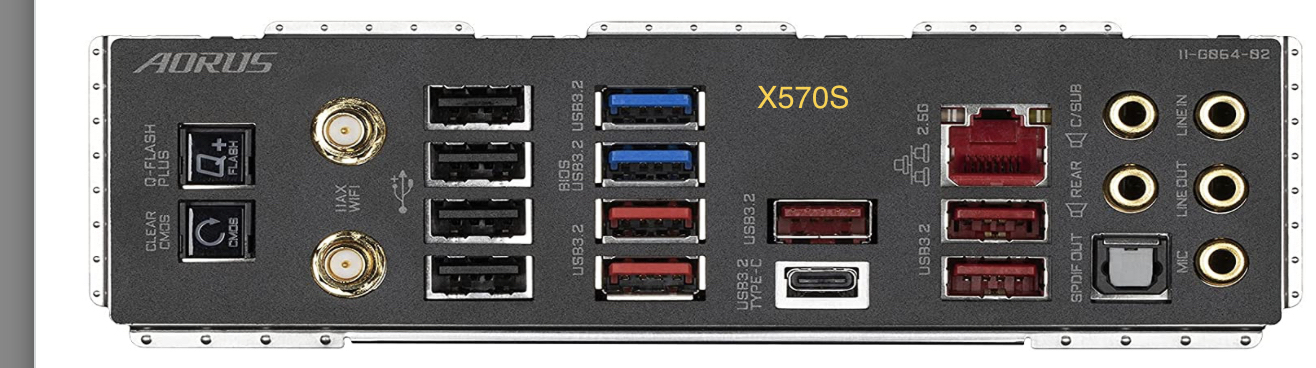

Hi everyone, just wonder is there anyone try Audiogod’s EFI on X570S Aorus Master?
Yep, It works fine. I added it to the list of working boards on page one with additional instructions.
Thanks for reply bro. I saw your instructions with X570 Aorus Master, but I wonder will everything work with recent released X570S (not X570) Aorus Master too? Do I need to create another SSDT for this board?
That’s unknown I’m afraid as nobody i know of has tried one yet but looking at the layout the only real difference is the passive cooling so in theory it should work exactly the same as the standard master config wise.
The X570S is just an X570. It the same model number according some reports, so same silicon. The only difference is board around it.
Probably just a concession from AMD to board partner since they didn't release an X670 with Zen 3 to sell new boards.
Reactions: AudioGod
Since they add 2 more USB ports to X570S, do I need to modify the usb map?
Yeah that looks like different mapping will be needed.
that’s a minor though.
Use USBToolBox in windows to map your ports very simply.
The Audio Codec might be different to (probably not) but that should be it.
Might be a little more complicated. The Type-C is marked as USB 3.2, could be one of the X570S that come with a 4th USB Controller to provide USB 3.2 gen 2x2 with 20 Gbit/s.
