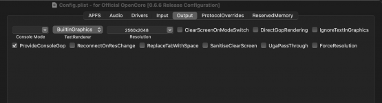

Something trivial that has bothered me maybe you can tell me what Im doing wrong. At the picker screen my icons are small (4k) any resolution I choose to change the size just ends up with huge icons. Any change I make has no effect. If I leave on max they are tiny any change = huge. ???
Use plist pro or Xcode to edit your configs. Do NOT use yucky configurators as they always mess things up.
you can try forcing the resolution.

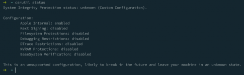

  • Clear your cache and repair your permissions (your need to disable SIP in the config.plist before you do so)
I already tried this a couple of times, but it looks fishy to me. I don’t have a comparison to a working clear cache & repair permission, but it looks like SIP would still be enabled on my machine:

I’m not sure if I shouldn’t add csr-active-config to the NVRAM->Delete dictionary (according to Vanilla probably yes)?
And here’s some Terminal output:
When I try to execute the same commands with sudo on the Terminal, I get the same errors. Looks like a SIP misconfiguration to me.
