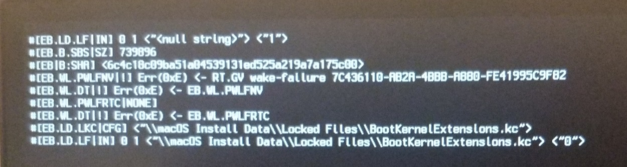

Thanks for your answer, I have better understanding now.
I did it exactly same way as my first installe mounting the EFI specific partition to copy folder in and so on ...
unfortunately, I formatted all previous drives thinking It would install seamless like previous time but the installer key is even not booting at all and reboots everytime without reaching opencore selection panel
I think I'm totally F#&é§ up now 😭😭😭I do not understand why this is not booting anymore on the key (may the install process have damaged the MB so that it cannot boot anymore ?)
I added 'debug=0x100 -v' to boot args and discovered I get a "wake failure" as shown in the pic below , then computer reboots
found on internet that it may be due to incorrect EFI structure, missing memory driver and so on which I cannot believe as I absolutely did not alter your EFI folder (except putting Seriel, MLB and UUID)
Recreate your usb installer bud.

I did it 3 times on 3 different keys indeed, same result each time. šŸ˜–šŸ˜«šŸ˜©
May it be linked to somethinh saved in NVRAM during a previous process that is not cleared up ?
Possibly. Did you not clear your nvram?
Reactions: fix38
nope, I did not thought it was necessary as I formatted everythinh and never had to do so in the past.
I do not know how to do it now afterward.

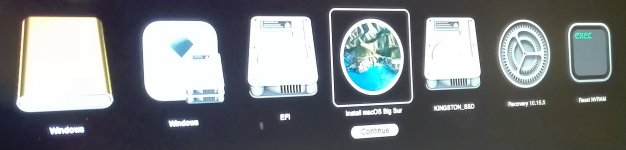

Press space at the bootpicker and it will reveal the option to reset your NVRam.
Or remove all power from the PC and then reset the bios either by removing the battery for a few minutes or by shorting the jumpers on the board,
Or update your bios to revision F33c AGESA 1.2.0.0 and this will wipe out your NVRam in the process.

I eventually managed to clear it all and re-install big sur...
It seem that it was due to unclear NVRAM and it is now running fine (eventhough I could not get the boot audio scheme to work šŸ˜… ).

At the bootpicker select the OS you want to select as the default boot drive and press Control and Enter. Done šŸ‘
