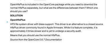

hey AG time to update driver folder :unsure:
Reactions: AudioGod
After the hassle you had with OpenHFSPlus I have already swapped back to the old driver. Forget it...lol
0.6.7 will be back to the way it was.
Reactions: svan71
I downloaded you’ve latest config on page 1, a few minutes ago and noticed openhfs still there ,
