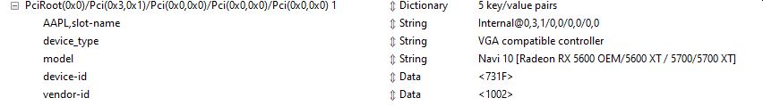

By the way, injecting the card the way you have could cause errors.
One good way to see it is to run Luxmark and check out what it thinks your GPU is. If it says anything other then what it’s meant to be then it’s conflicting. If you run a game and it’s causing trouble your get frame drops all over the place.
PciRoot(0x0)/Pci(0x3,0x1) containing fake card parameters is only used for getting DRM in AppleTV and Apple Music Streaming to work Properly. It serves no other functions so I don’t see how that could cause a hang in the installer for you bud. Very Interesting though

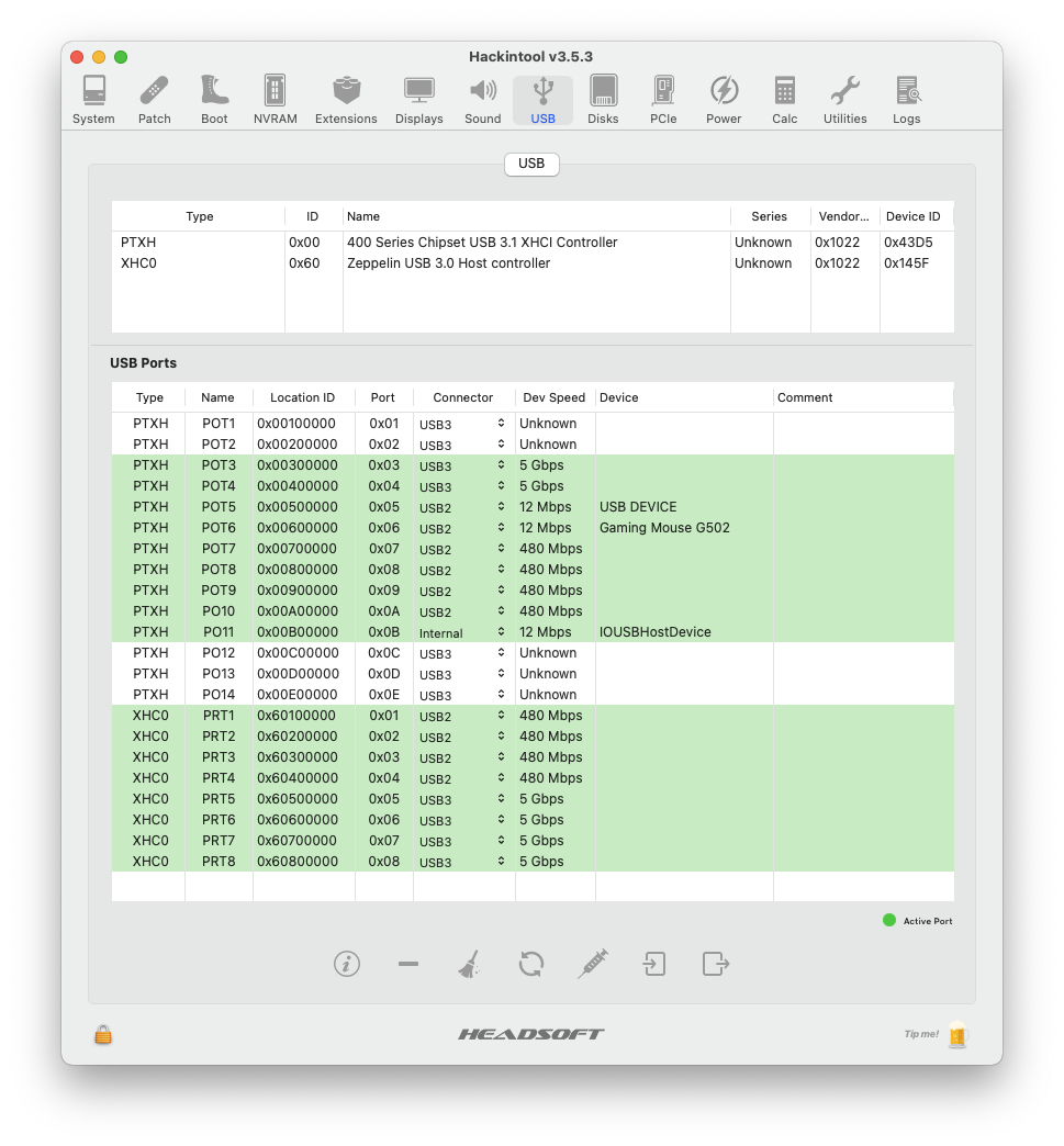

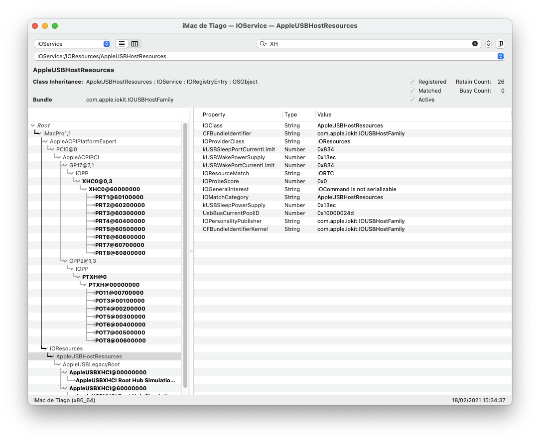

could you show me a screenshot of your XHC layout within the IO Reg or if you don’t know how to do that then show me a screenshot of the USB ports via hackintool. :)

So here it is my actual IOExplorer screenshot for USB ports
As so my Hackintool screenshot:
Please notice my USB port without any mapping:
I've removed PTXH/POT9 and PTXH/POT10 to keep bellow 15 ports to remove the Quirk XHCIPortLimit as mentioned on Dortania's tutorial.
The USB3.0 ports always maps to two IOPorts when using a USB2.0 or USB3.0 device (as you can check on my USB port comments) is this normal behavior?

As there’s 2 controllers it means you can do 15 ports per controller so you dont need to remove any ports if you don’t want to.
I see you have usb 2 outputs listed as being on usb2 ports, this is incorrect unless it really is a usb 2 only port. If the port is usb c for instance and you wanted usb 2.0 coming off it aswell then you would list both maps as usb c not usb2 and usb c. Same thing with a usb 3 port usb 2 and usb 3 coming off the same port would still be usb 3 on both maps.
You don’t need to use XHC-ssdt or any sort or name change as XHC0 and PTXH are fine and don’t conflict with smbios iMacpro1,1 or 7,1.
you have 2 examples of t he same ssdt.

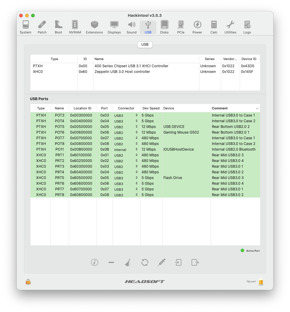

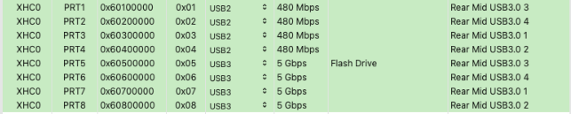

So I should map ,i.e XHC0/PRT3 and XHC0/PRT7, should be both configured as USB3 Connector type because it's a USB3.0 physical port?
I thought it only should have 15 IOPorts in total regardless of the number of controllers, thanks for the tip.

No it’s 15 ports max per controller not in total So yep you can totally bring back those 2 maps and yes that’s spot on, the physical port is what you list it as regardless or if it’s usb 3 or 2. 👍

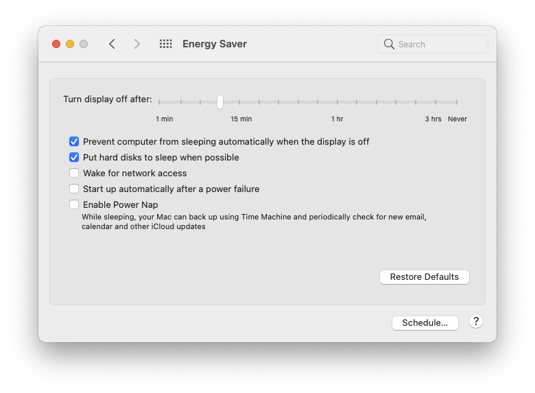

It showed up! Should I enable it?
Thank you a lot!
Thank you a lot!
Awesome, did you remove EC-USBX and replace it with USBX?
I have power nap enabled, I like that feature. You can see how I have it set on page one.
