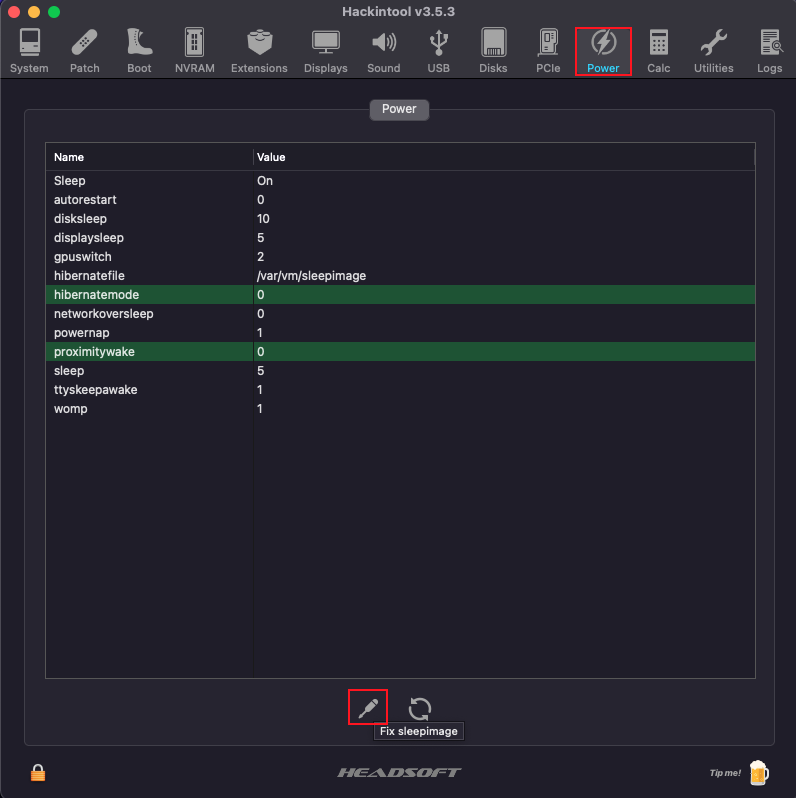

Ok buddy so try the following things please.
  1. On the X570 Ultra Enabling ERP in the bios causes exactly the problem your describing. If you have it enabled then disable it and try again or if it’s disabled then try enabling it and see what happens. (if neither work then could you send me a screenshot of your bios power management settings please?)

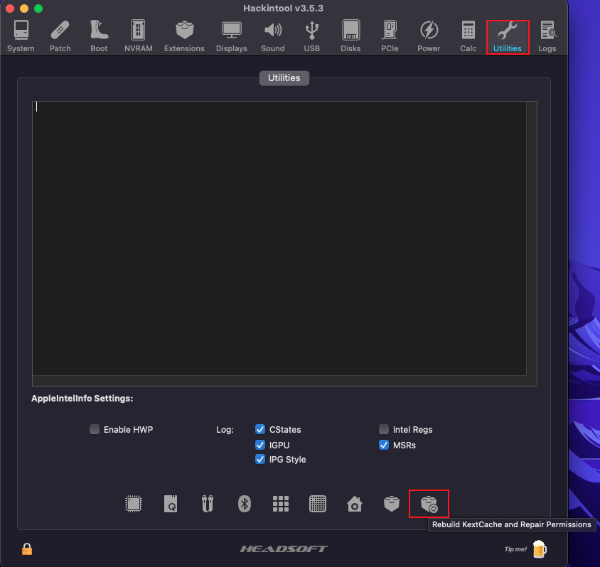

  2. Go into the config.plist and disable SIP then restart, open hackintool and check your power settings are correct and if it’s not then autocorrect it in hackintool. After that still using hackintool clear your cache and rebuild permissions then you can enable SIP again and restart. When you get to the bootpicker press space and reset your nvram.

@maclinuxg4 you have to have SIP fully disabled or it won’t work.
no dylib to add ? sur
No, why would you want to add Dylib?
Hackintool will work as is and to do certain tasks like rebuilding your permissions the only thing you would need to do is disable SIP.

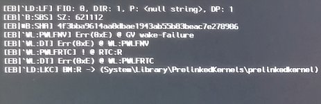

Thank you so much for this great and detailed work!!!
I have experience with opencore since 0.5.6 and was able to create a working stick/SSD for Catalina.
my hardware is identical to yours, except graphics, I have the Radeon RX 570 w/8GB;
boot-args: -v keepsyms=1 debug=0x100 npci=0x2000 alcid=29 (Above 4G decoding disabled);
everything within your config.plist looks so fine, but unfortunately I'm unable to boot your EFI;
of course I used GenSMBIOS and my MAC to complete the config for my machine;
error message: OCB StartImage failed - Unsupported
can you please help?
Do me a favour and download my EFI again and this time only remove agdpmod=pikera from the boot arguments and add nothing else in there or anywhere else other then your Serial Number, UUID and MLB and try again With out any other changes.
I did what you recommended, but I had to change the following two settings:
HideAuxiliary=False
AppleDebug=True
without changing that I saw just my Windows 10 boot option;
with these changes I see additionally the USB Stick and the Clear NVRAM boot options;
but I'm unable to boot, please see attached picture ...
@wore you didn't need to change HideAuxiliary to False all you needed to do was press space at the bootpicker to reveal the Aux Options and Having Debug set to True only helps with debugging.
Im just double checking my EFI on here now for you.
I just checked my EFI again to make sure and there's no problems there so the problem is on your side. What im not sure yet but im thinking bud.
Going by your setup it should just be a Matter of downloading the EFI, Adding your system smbios info and removing agdpmod=pikera from the boot args and that should be that.

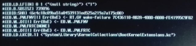

... first of all, thank you for the hint with space bar, it works fine, and I reversed the changes I made (HideAuxiliary and AppleDebug);
and yes, I created my installer step by step according to the oc 0.6.6 guide;
in the folder 'com.apple.recovery.boot' I have the BaseSystem.dmg (655420141) and the BaseSystem.chunklist (2560), this should be OK;
and I'm using your EFI, I removed agdpmod=pikera from the boot args and - of course - I added my SystemSerialNumber, SystemUUID, MLB and ROM ...
