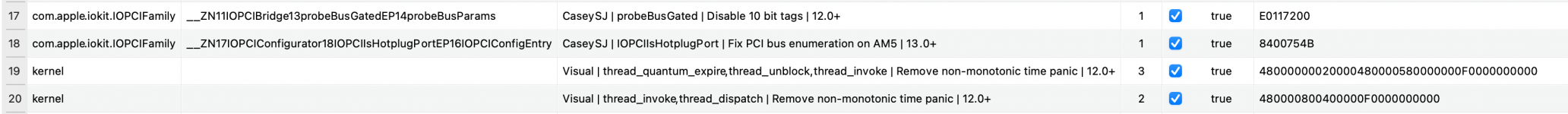

If this is an AM5 motherboard please enable the patch shown below:
