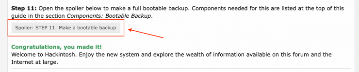

I've used Carbon Copy Cloner in the past — but I remember they had some issues with creating bootable copies after the release of Big Sur / APFS & I have not used it since.
I still have a licence for it — is Carbon Copy Cloner a reliable bootable cloner again or just a backup tool? :)
I have 2 x 2TB in my Hackintosh — the second one is Windows but I am willing to just wipe it and use it as a bootable clone before doing any major upgrades.
We can still make bootable backups with CCC. Please refer to this guide:

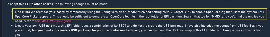

@CaseySJ
Hi again and thanks for your support. I attached the last info gathered with the last EFI setting up. I tried disconnected the iommu, resizeBAR activated and Deactivated etc...
Regards
Please refer to the highlighted item taken from Post 1 of this thread. The link to "MMIO Whitelist guide"is stale so ignore that part. Instead, just follow the highlighted steps and post a copy of the resulting OpenCore log file. We can help you with MMIO Whitelist by examining that file.

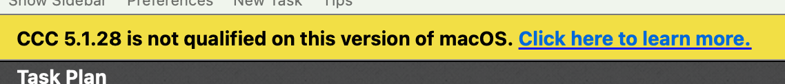

which means Carbon Copy Cloner
i use OCLP and an old CCC version (latest 5.XX version) and backu are working (and bootable)
1,282
Interesting. Does the 5.x version of CCC make bootable backups of cryptographically sealed APFS volumes (Big Sur and newer), including Sonoma? The resulting backup disk is bootable?
fabiosun
Oct 9, 2022
478
in bold i dont know its meaning (sorry)
i use 5.xx to backup my OSX boot disk from monterey (so also in Ventura and Sonoma)
2,479
@mariettosun have you fully tested the CCC backups you have created? By that I mean the following:
  1. Removed/disconnected the original macOS drive and any other drives from the system, leaving just the drive with the CCC backup installed.
  2. Booted from the CCC bootable backup.
Were you successful in booting to macOS Monterey, Ventura or Sonoma?
As the CCC backups may not work, if the original macOS drive isn't present to unseal the APFS container/volumes you have copied.
@CaseySJ

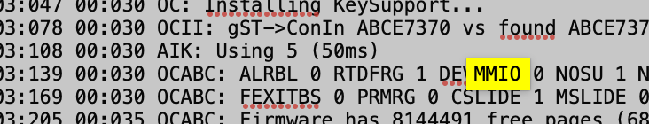

I tried several times and we got only this file attached. There is not any entry about MMIO. I tried connecting it into the BIOS and disable with the same result. I don't know if I making something wrong. I already had OpenCore.efi Debugger version.
Regards
hi
you have to set properly here :
enable dthat quirk and then set target to 67
Amdar

@Amdar from your log you must enable booter/ quirk devirtualizemmio
Now it set to 0 (disabled)
