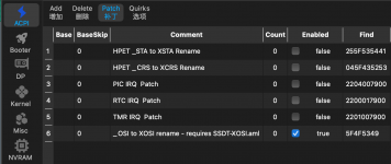

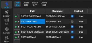

Yes, I have read that I have enabled VoodooPS2Controller in order according to the instructions, and disabled ssdt-gpio. The touchpad still does not work
Did you try adding SSDT-XOSI.aml and the config.plist ACPI patch as a replacement, when you disabled the SSDT-GPI0.aml table?
Showing a partial screenshot of your kexts in OCAT is not really helpful. Post a copy of your EFI, without your Serial number being present in the config.plist. And a copy of your system IOReg.
I assume you are using a wired/wireless/BT mouse while trying to fix the trackpad.
I hope you can correct it for me. Thank you
Using the EFI you created will cause the system to become stuck and unusable
Stuck where? I'm unable to help without information.
